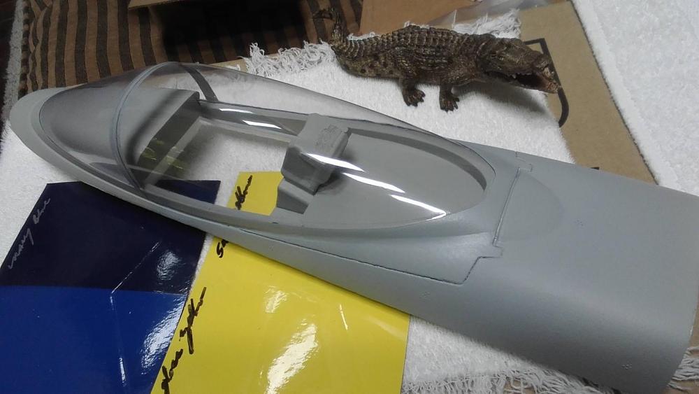

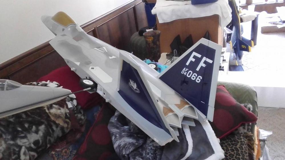

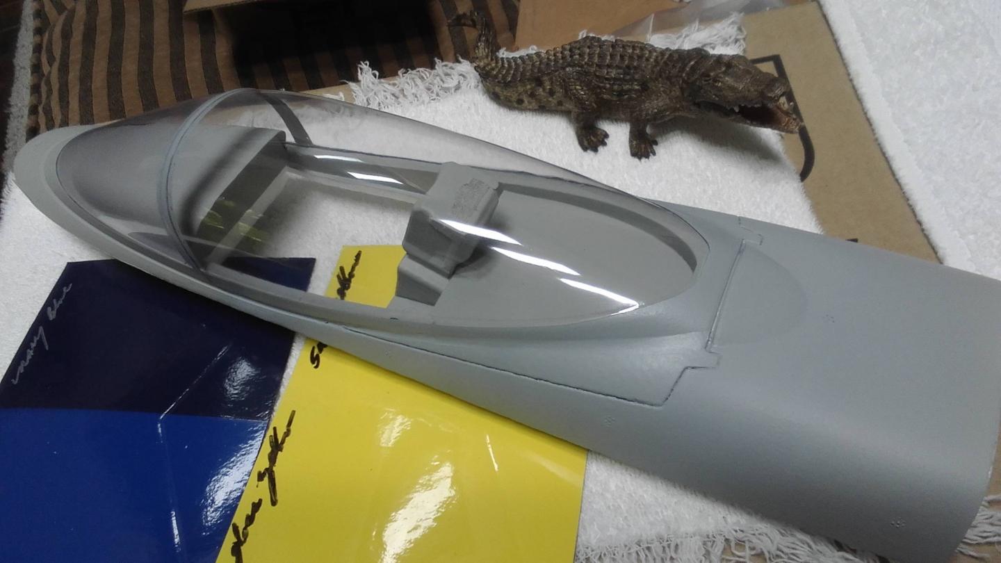

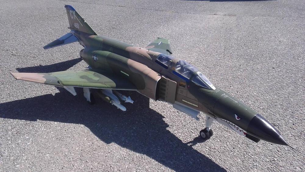

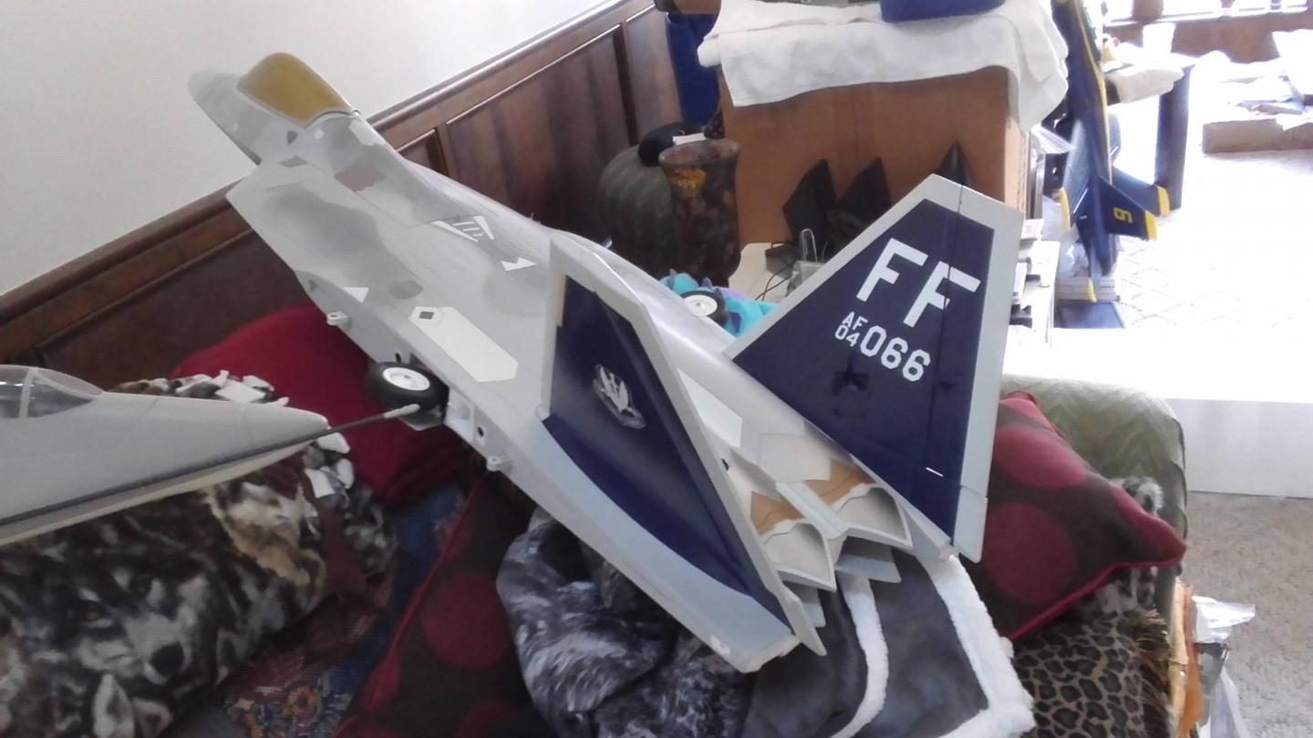

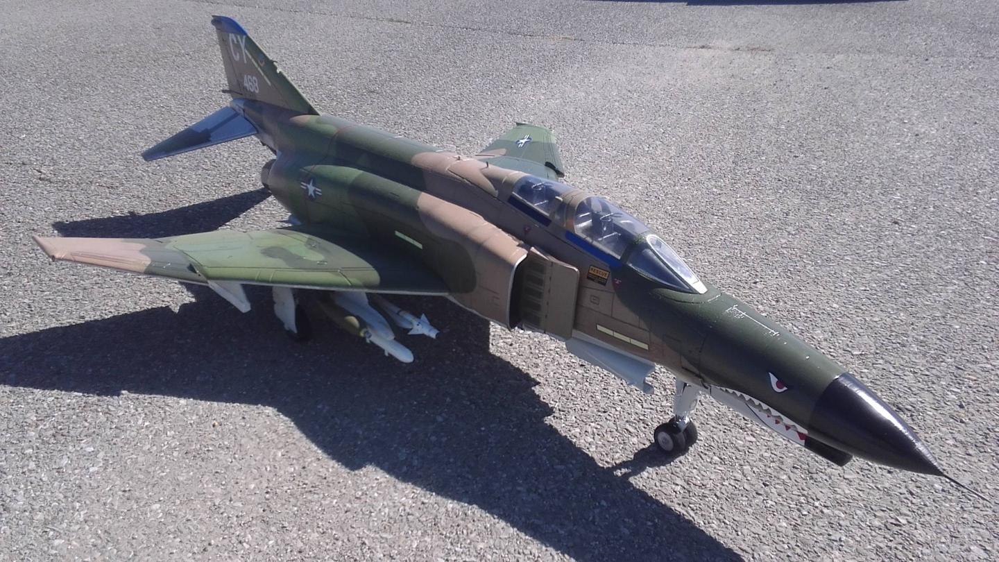

                                  • Soooooooo, ... A Base Gray model marketed as 'Easily Customizable' and 'Ready for your Custom 'Paint' and 'CallieGraphics' which initially checks out fine on the bench... goes "Sorry, Out of Warranty" once you apply those Graphics !!!
                                    The implication here is that, the only way you are going to be able to take advantage of this 'Warranty' if need be, is, you must Fly it around all 'Gray' ... ??? Completely unmodified until the new purchase 'Warranty' period expires... ????
                                    I realize that this is the wrong place/forum to be inciting anarchy but I'm guessing anyone changing out Servos or Pushrods, Reinforcing your LandingGear Mounts...etc. ..etc.. and thus Modifying your Airframe, even on a Blue model is SOL if a seemingly completely Unrelated fault/failure on your Jet occurs !! Hmmmmm. . . Okay !!
                                    And, furthermore, the Application of all of these nice 3DP Parts and Accessories we all love, cannot be applied until this 'Warranty' period expires if we have any hope in making a valid claim on a MRC item. Clearly, I'll never be submitting a Claim on anything I've gotten or plan to get. My modifications start as soon as the Box gets Opened !!
                                    It is conscious 'Choice', some of us make.
