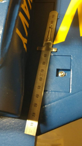

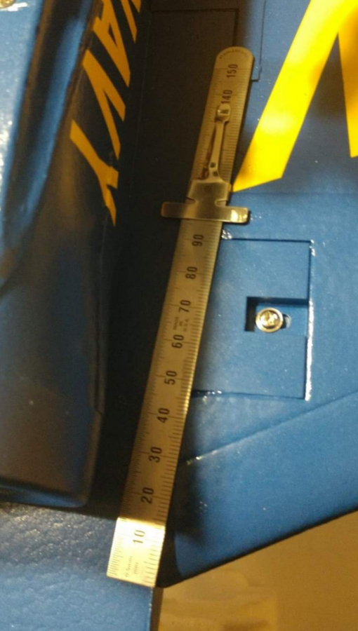

      I'm at 96-100mm with the Pulse 500045c. Click image for larger version

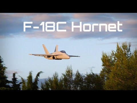

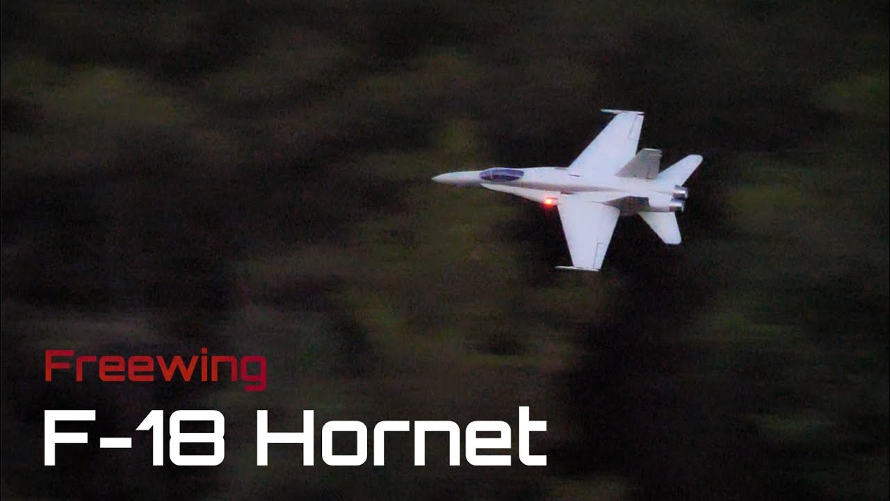

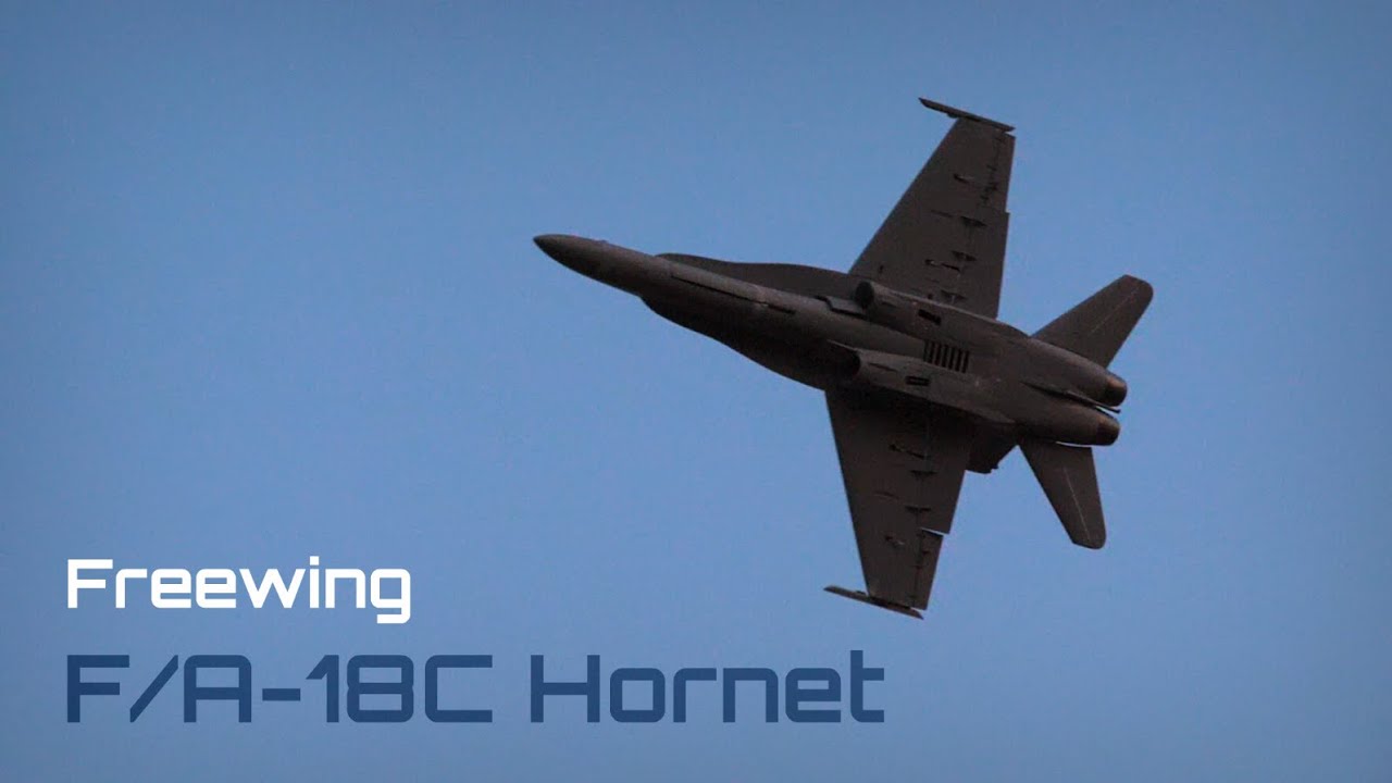

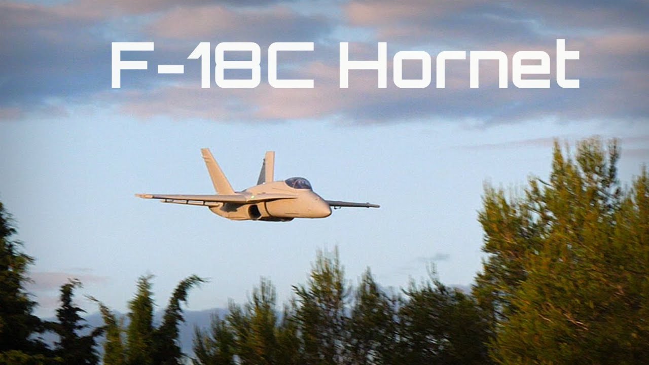

                  I fly mine with CG past 112-115mm.
                  Here's some action in slow motion (180fps) :)
                  And not so slow (60fps):

                    Really outstanding flying, you can fly mine anytime you want!!! Looks like your CG in the 112-115 mm range has her flying very smooth and level as I noticed when you go inverted it doesn't look like you need any down elevator to keep it level. I'll bet it goes into high alpha sweet with that CG, wish I had the cajones to fly mine there!

                      Saw those on the youtube earlier this week. Really cool. I'll have to do that with my BA. I have NCH video and audio editing software.

                        Thanks!
                        The first video I just uploaded right now so no chance you could have seen it, the other two, sure! :)
                        When moving CG very aft, you really want to have a gyro to help you out. It's more or less safe to do without it up until 110mm-112mm, and at that point you will notice a degradation of lateral stability at very low speeds (the plane can drift its tail with only moderate AoA). Further aft than that, I'd say drop the gyro in.
                        This is the only jet so far where I have not been able to make it behave tail heavy because another restriction appeared earlier (Lateral stability being more critical than longitudinal stability on this one, that is).

                          Yes seen the other. I'll keep my CG where it is without a gyro. Flew perfect for me. I didn't use the rates in the book. Went with 80% on all flight controls and 30% expo. Best landing ever for this type of edf. Just waiting on a new servo. Starbord one quit working properly after first flight.

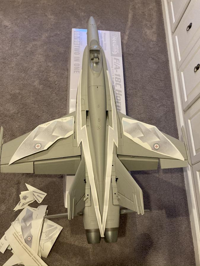

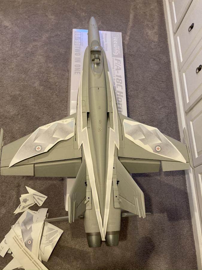

                              Graphics arrived today for the RCAF 2018 NORAD demo plane. Going to be tricky to get things to match with the real plane. Usually takes a few re-dos and living with some scale departures before I get it where I can move forward. Hopefully will look good in the end though.

                                That's going to be sweet, Callie doesn't even have those graphics on her website. Can't wait to see the final product, we'll have to get together and fly our Canuck F-18's in formation!
