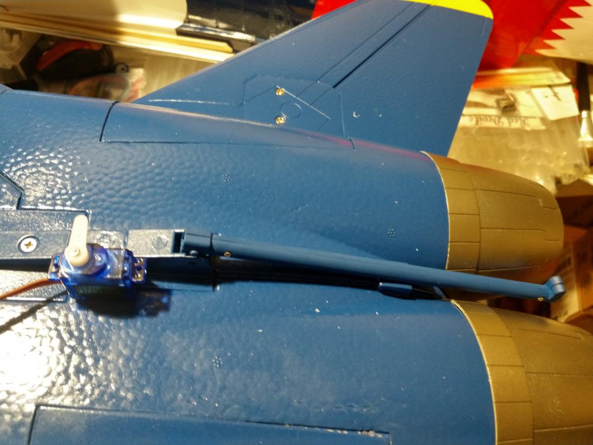

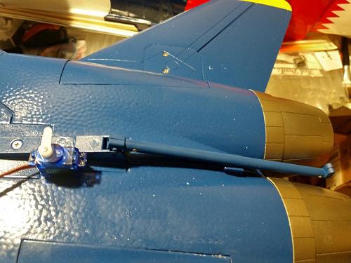

              Adding tail hook operation with submicro servo. This is my plan on doing it. Recess the servo where I have it, add a small horn to the hook an inch and a half from the pivot point. Had the servo from another project that I'm not going to put together. Click image for larger version

                Temporary operation then put everything into place.

                              Tail hook operation completed. Now for the down and dirty pass.
                                      CP, Again, great work, Sir and congrats on your first check flight. Bravo Zulu. Best, LB
