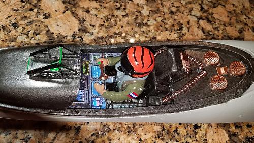

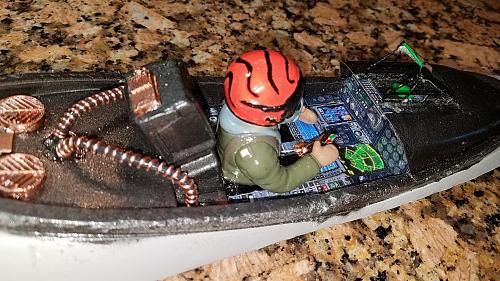

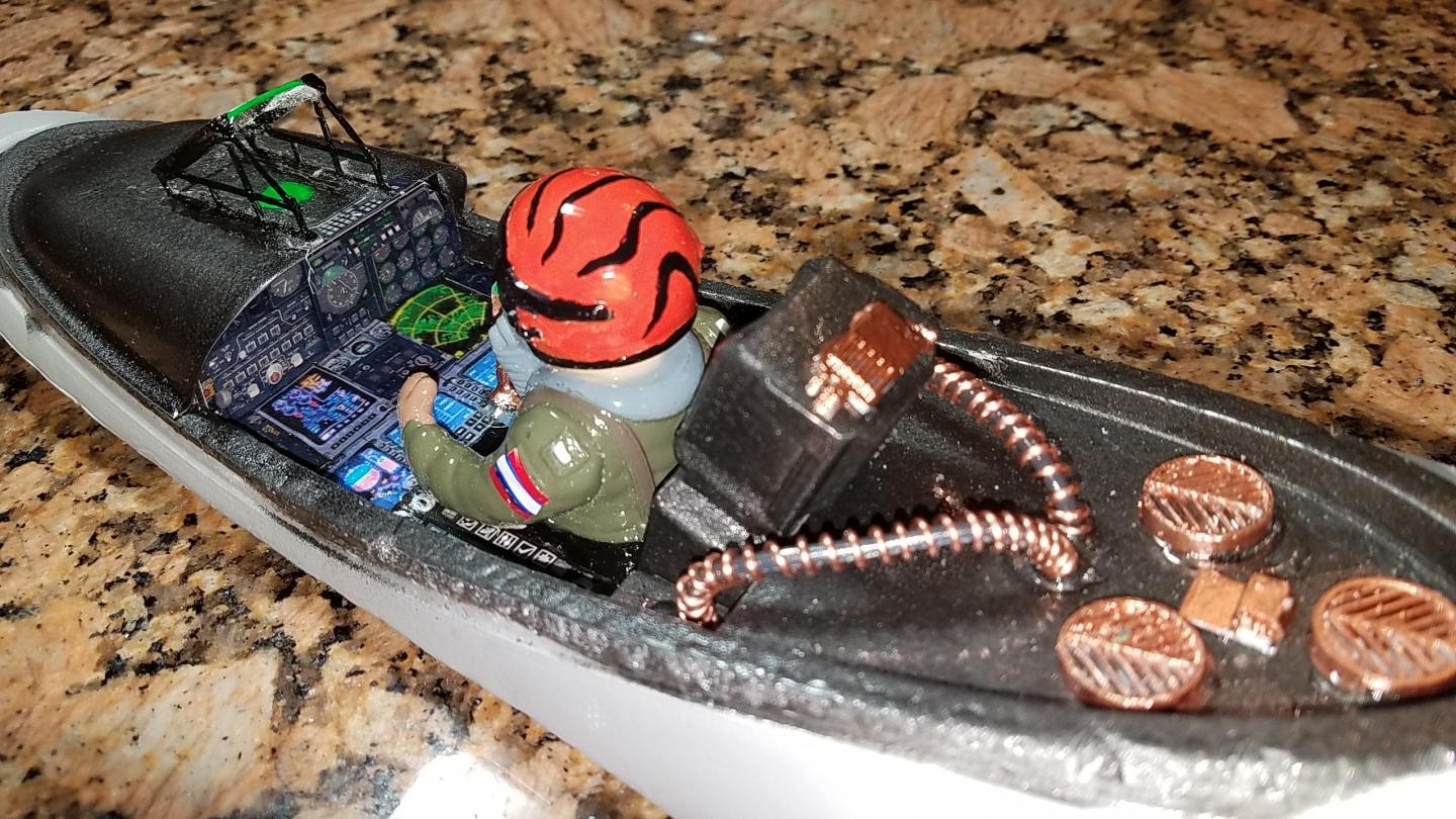

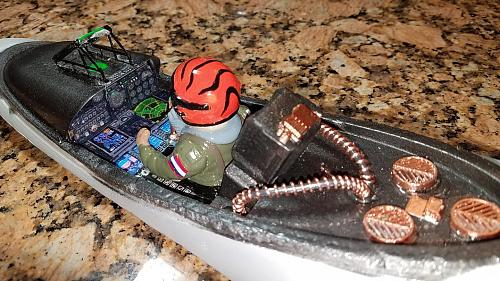

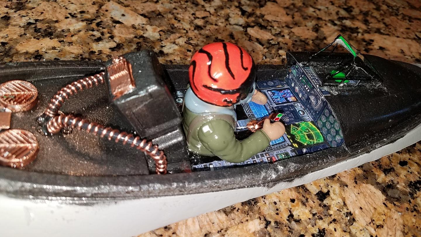

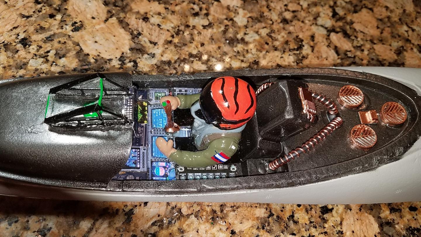

                          Making slow progress on the 2nd Hornet. Looks like I'm on the Elbee production time line (but definitely don't expect the same outcomes). But at least I saved about $120 by ordering them just before the 15th! Probably shouldn't have undertaken the repaint of the Mig at the same time but couldn't leave it in the box so I figured it was better to paint 2 at once and save some "paint barn" costs and time. Finished the Mig cockpit and just finished the Hornet cockpit. Now it's on to final masking and primer time for both.
                          I was going to do the full blown 3D cockpit as I did on the first, but got a little lazy, so ended up with a 2D unprinted "Rube Goldberg" version (probably most are too young for that reference). It's nowhere near as nice or accurate, in fact nothing on it is accurate, but the nice thing is it weighs only 1.2 ounces more than the stock plain cockpit. My 3D cockpit weighed 4.75 ounces more than the stock and it required some real creative work with the battery placement and the dreaded "lead in the tail". With the 12 blade inrunner and the AB's, that 1.2 ounces in the nose should be a non issue and allow me to place the battery wherever I want (at least I can hope it does).

                            Originally posted by killickb
                            That looks almost too smooth to be playing back at normal video speed -- is it ?
                            It's not, it's slowed down a bit.
                            I typically post both edited and raw clips... will post the other one later this week. ;)
                              • 8225
                              #4994
                              Airguardian always a treat to watch your spectacular flights, thank you! Hugh Wiedman that cockpit detail is SICK and I am officially not going to share my photos because my detailing is so minimalistic to what you and LB have done it's embarrassing. Fantastic attention to detail!
