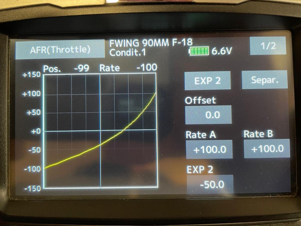

                                          #4860

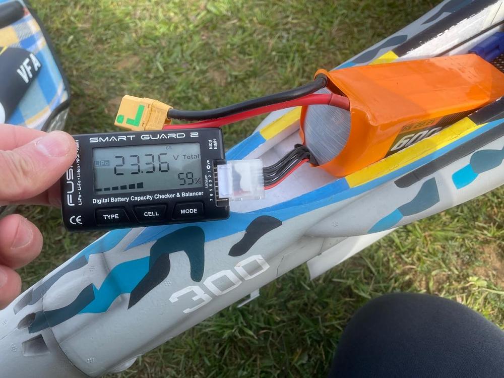

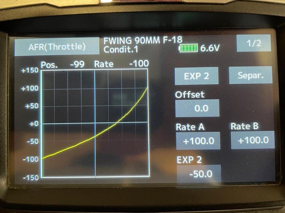

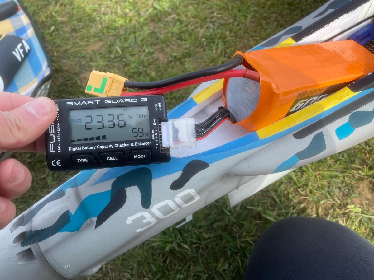

                                          I think I've actually got to the issues, I downed tools yesterday afternoon and went to the field. Got 3-flights in on the F-18 (5 on the L-39)
                                          I put a 50 % exponential curve on the throttle (see photo below):
                                          Click image for larger version  Name:	IMG_8243.jpg Views:	0 Size:	146.1 KB ID:	308062
                                          After around 3-minutes 30 seconds I landed with 60% left in the battery (I really didn't expect this). So with some mixed flying I reckon I can get over 5-minutes out of her:
                                          Click image for larger version  Name:	IMG_8241.jpg Views:	0 Size:	132.6 KB ID:	308064
                                          Click image for larger version  Name:	IMG_8240.jpg Views:	0 Size:	241.5 KB ID:	308063
                                          So, my conclusion is that given the power those motors are putting out, I must have inadvertantly been using much more throttle than I actually needed most of the time.
                                          I suspect it's something to do with the power / rpm band for that motor/fan setup, a little like a the sweet spot on 2-stroke sports bike if I might use that analogy.
                                          I'm going to use the same 50% throttle expo on the A-10 and am hoping it will significantly prolongate my flight times on that, in fact, I'm more optimistic that I will see a more dramatic change with the A-10.
                                          Based on limited testing I would recommend people experiment with this, you can't really do any harm and with an exponential curve you've always got full power at the top of the sticks.
                                          It's not been something I've done before on EDFs (I have done it on certain turbines that have had very distinct power band traits or spool-up characteristics but that is irrelevant here).
                                          Famous last words I know, but I was really surprised by how she handles, in a good way, I really pushed my luck a couple of times (deliberately) flying close to the stall and she so far hasn't taken the bait. Not sure I'm going to move the CG back any further for now, for me she seems to sit on her tail nice enough in-flight (it's currently at 101mm).
                                          Anyway... problem busted 👍
