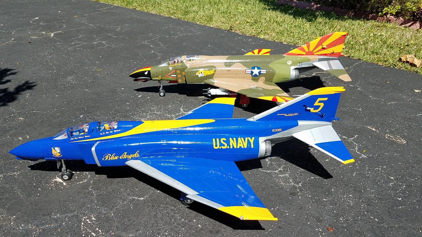

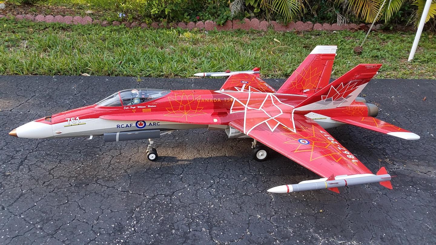

                                        I've done 11 of my foam aircraft brushing it on and always use gloss as I like the sheen it gives, in the air as well. The BA needs gloss IMO. I use Varathane Spar Urethane exterior so no yellowing. I just got the same in spray, tried it out and have to say from now on I may use the spray exclusively, much more even coats.
                                        I really like the added durability, however, you need to be careful and not leave it baking in the sun for long as it causes the unerlying paint to gator quickly, maybe a bigger issue here in Florida.
                                        The gloss made my BA F4 really pop, as well as the red on my F18.

                                          Those look awesome, Hugh.
