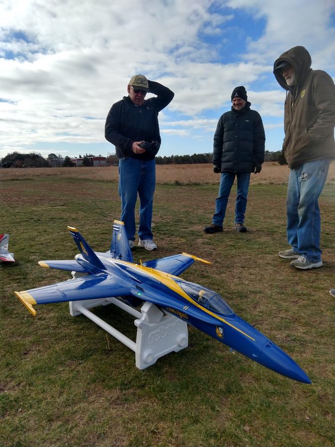

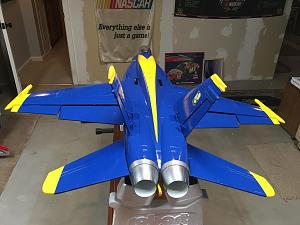

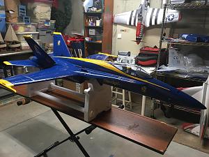

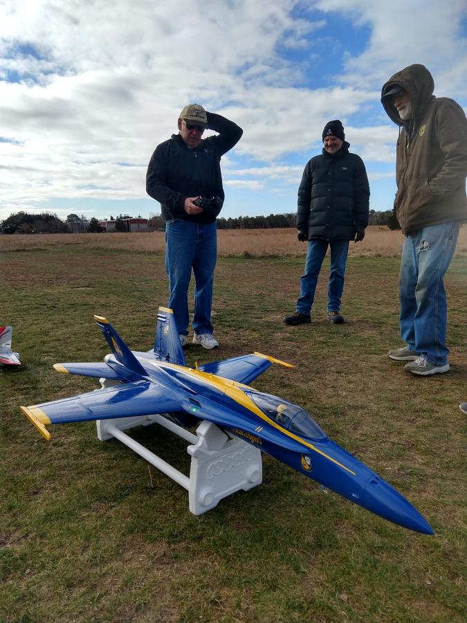

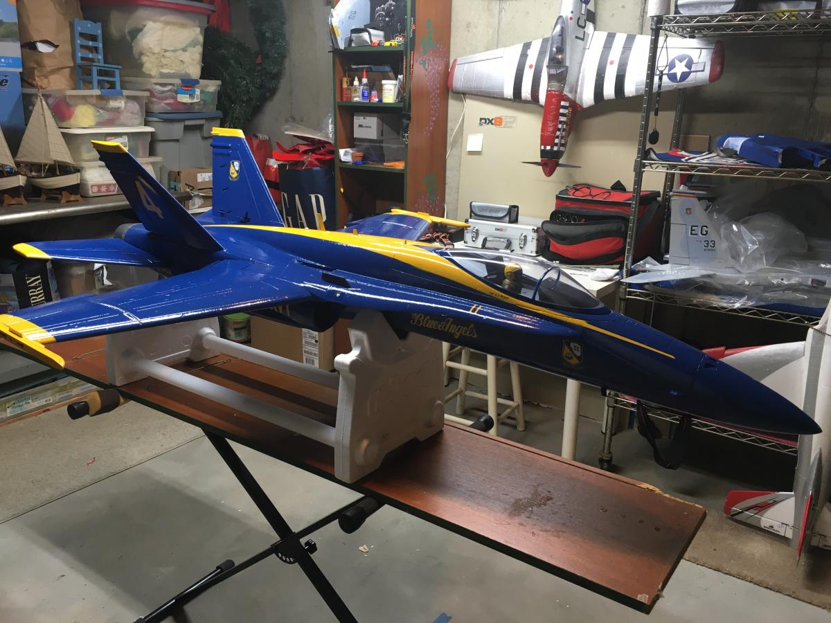

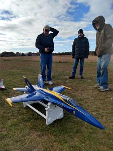

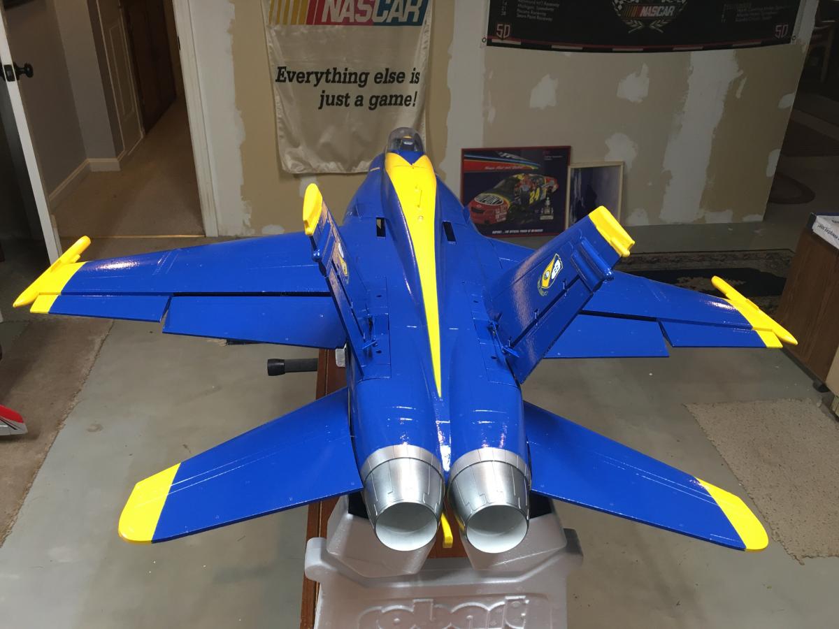

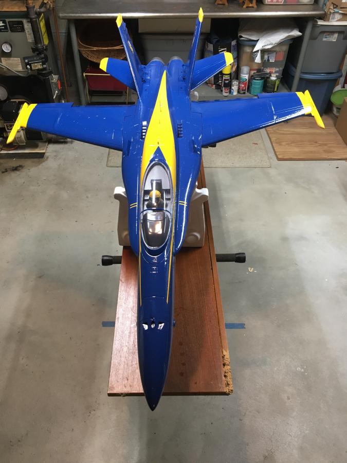

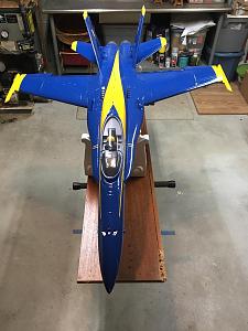

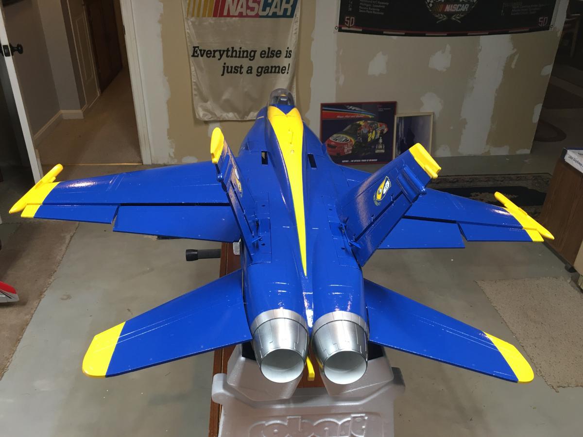

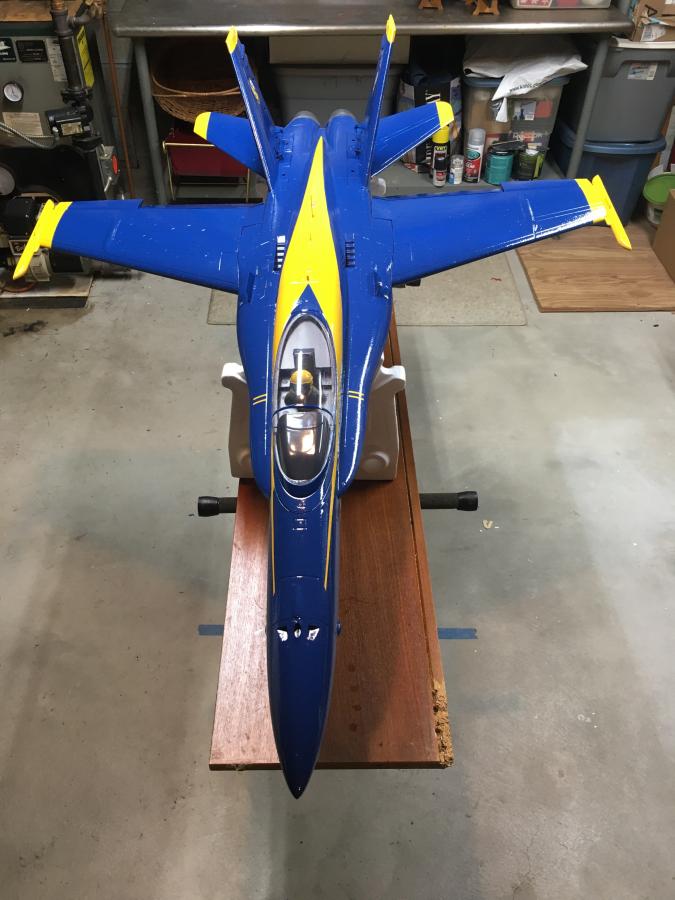

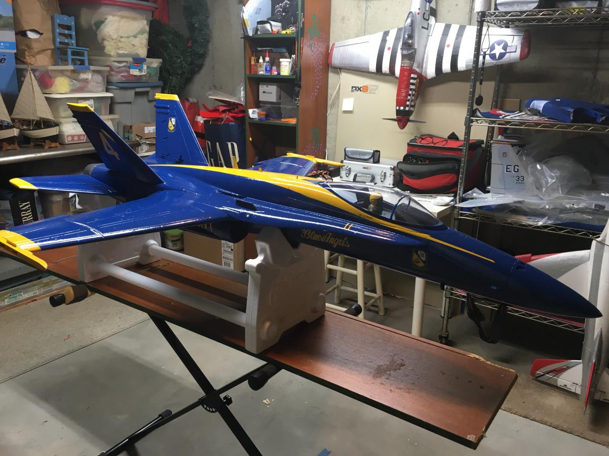

          Completed the build on the Blue.... All up-grades completed and afterburners installed. Being winter on Cape Cod wont see the air till it gets warmer. Till then she will sit and wait to maiden. And no I don' t want to hear about you guys in Florida flying all the time.....

            That looks so much better with the gloss sheen to it. Did you say you brushed it on or sprayed?

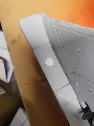

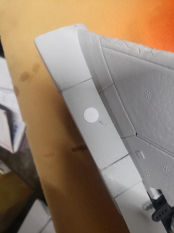

              If interested in a less permanent (than say, filling-in for example) and removable means of hiding the vertical stabilizer screw holes, I made some simple plugs/covers that can be 3D printed and painted over to match. It’s something simple, but I think it looks better than the holes. Obviously there are many ways to cover/conceal the holes, but if you have a 3D printer, this is an easy way and still looks good.
              https://www.thingiverse.com/thing:4750188
              Here they are unpainted.

                Minwax Poly Gloss and used foam brushes. One real light coat and soft sanding then another coat.

                  Looks great!

                    Looks outstanding, well done Cape Jets , the gloss finish (my personal favorite) really makes it pop. I'm sure it will be tough looking at it all winter until you are able to get it out and fly her. And don't exaggerate about being able to fly all the time in Florida. :lying_face: We can only get out 2 to 3 times a week :sob: because this is the "windy" season and it rarely gets below a 10 mph breeze. At least you have more time to build. :hugging: And besides, those of us here down south need all the practice we can get as my repair skills now far outweigh my flying skills.

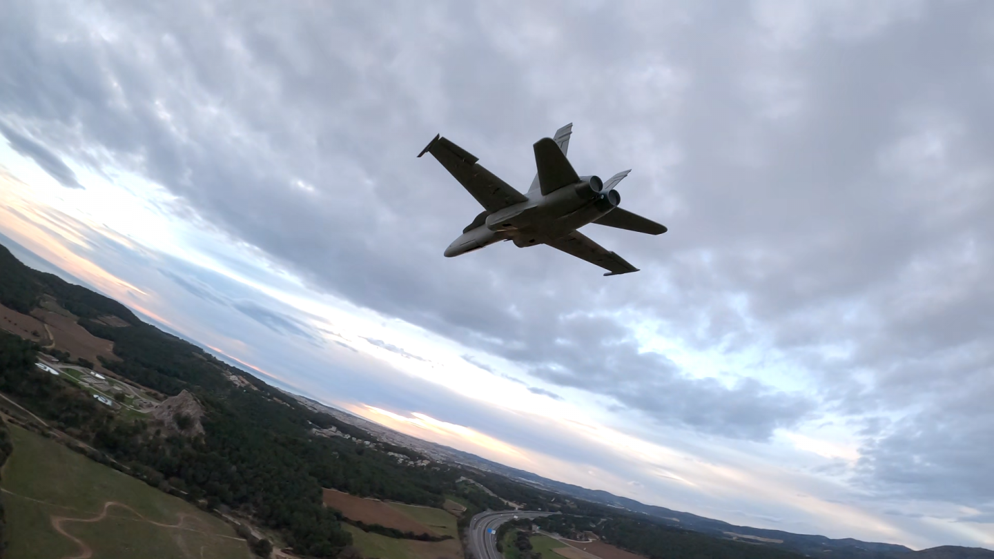

                                    Great shot!

                                      Video coming soon!

                                        could not ask for a better shot then that

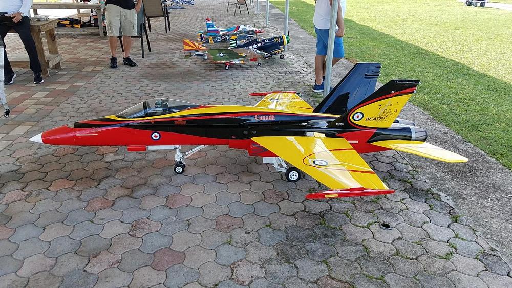

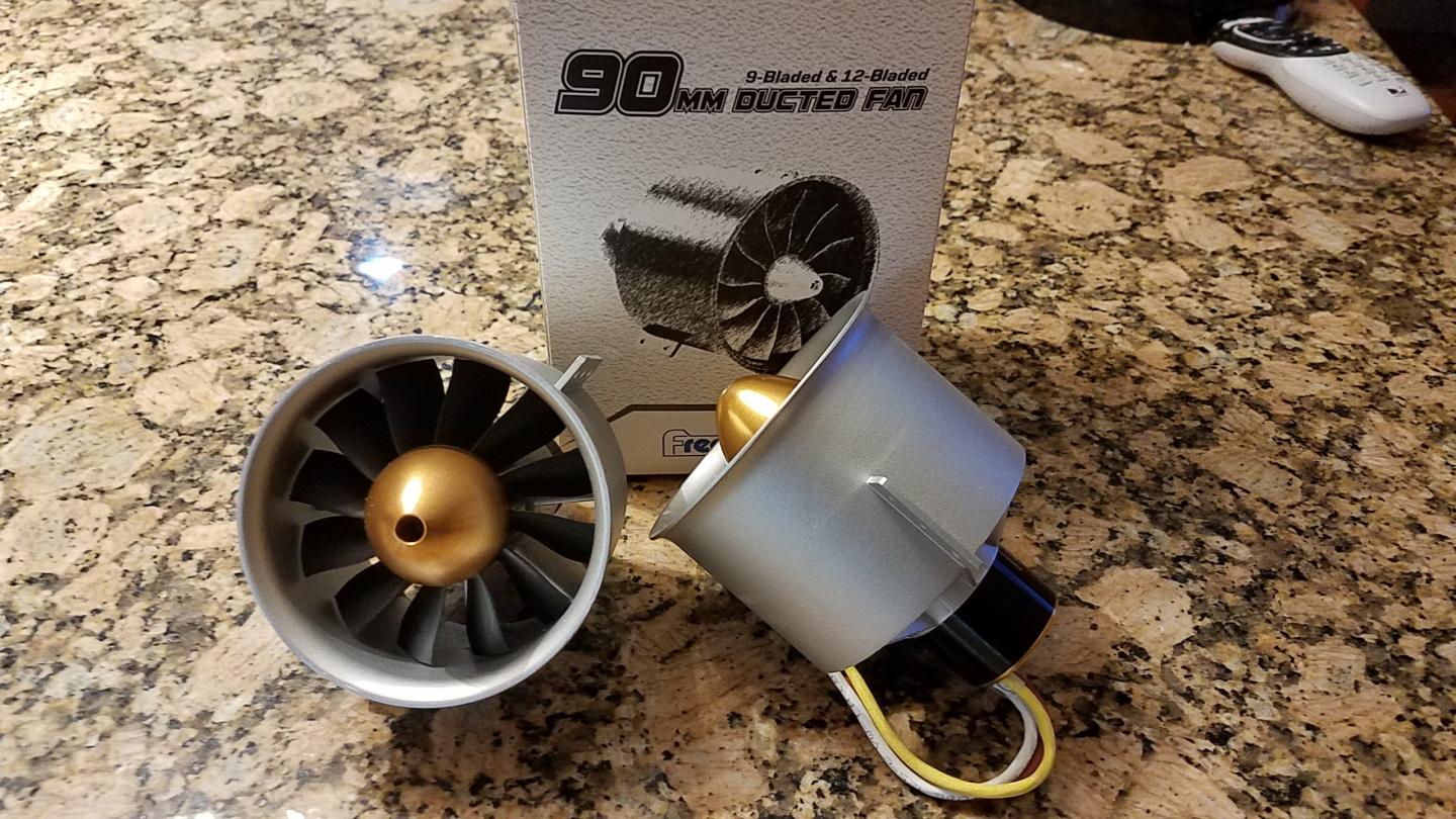

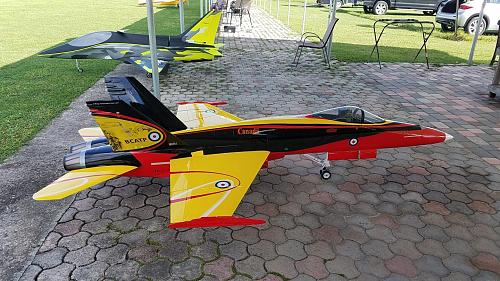

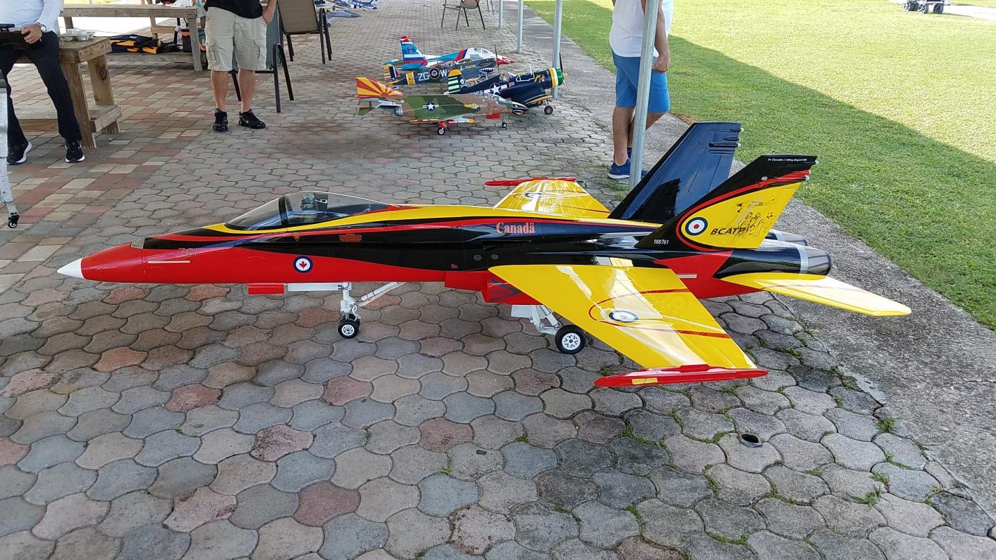

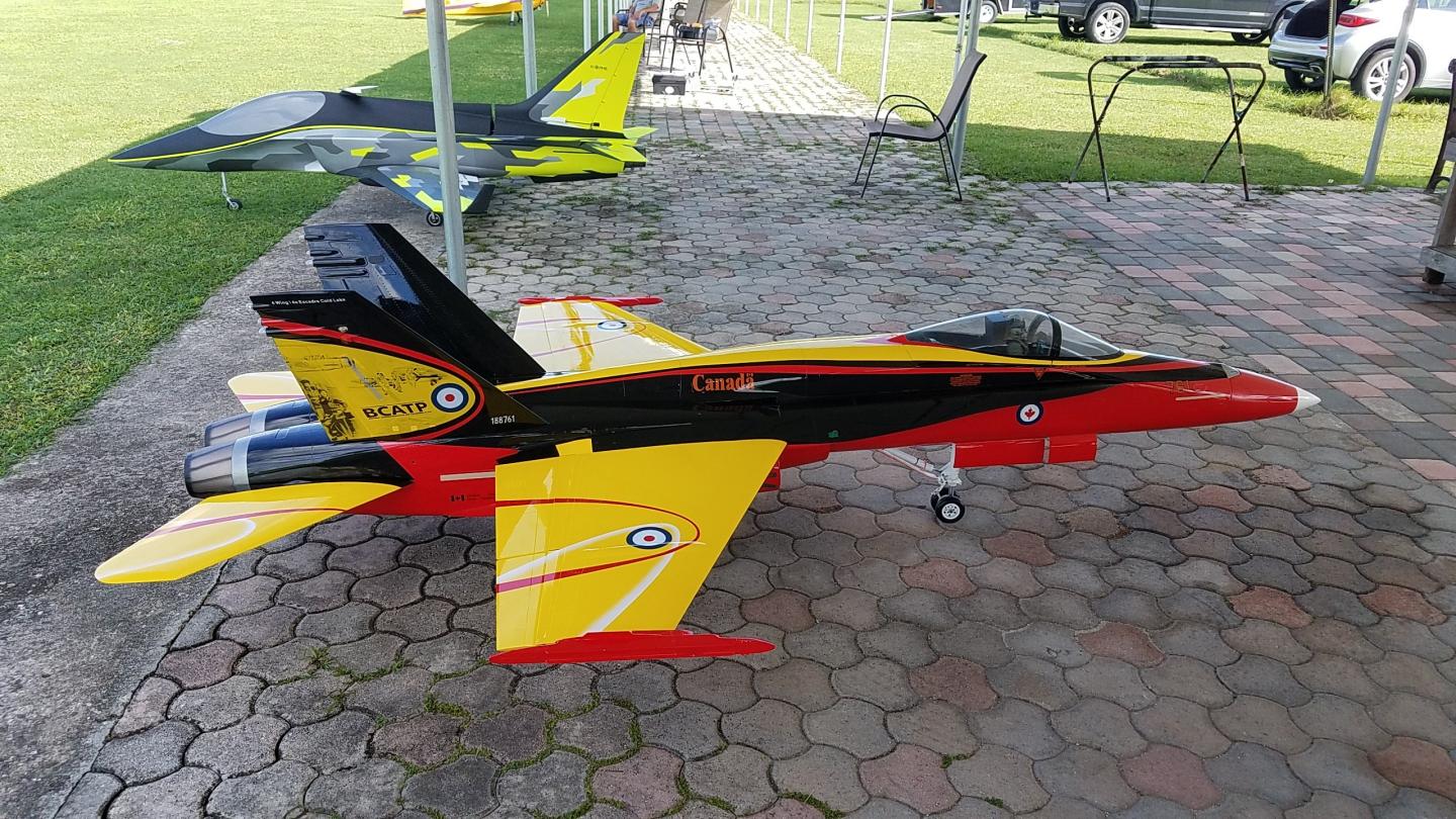

                                          If I were to ever get a turbine, this is it. A custom paint job by one of our many Turbine jet fliers.

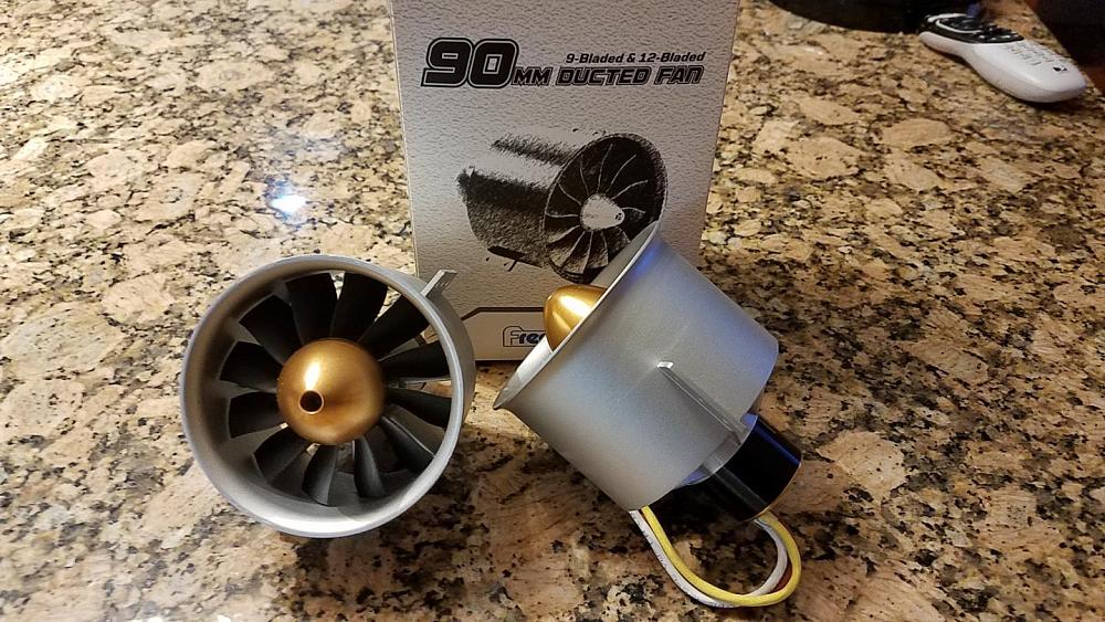

                                          Oh well. But I did pick up two 90 mm 12 Blade 1835 Kv inrunners, one for my F-18 and the other for one of my F-4's (let's see how it does in that before I upgrade both of them). Or maybe I'll just strap them to the back of my truck and see if I can pull a wheelie! This was overdue as my F-18 and both my F-4's still have the old 9 blade 1750 Kv outrunner. Can't wait to see how they fly with these bad boys. Now I also need to change the LED cones of the afterburner. :triumph: Unfortunately won't get them in till the beginning of March as I'm headed north to "RatVille" till the end of the month to stand in line until I pass out, or pick up Covid! Had to pull the trigger now cause they were starting to get low on stock and didn't want to get back and have them out of stock for a while. My wife and her whole family are Disney addicts, but as for me, I can definitely do without the place, but gotta keep the wifey happy.
                                          Click image for larger version  Name:	20201129_142700.jpg Views:	0 Size:	276.8 KB ID:	298733Click image for larger version  Name:	20201129_142722.jpg Views:	0 Size:	274.5 KB ID:	298734
                                          Click image for larger version  Name:	20210209_202557.jpg Views:	0 Size:	231.1 KB ID:	298735
