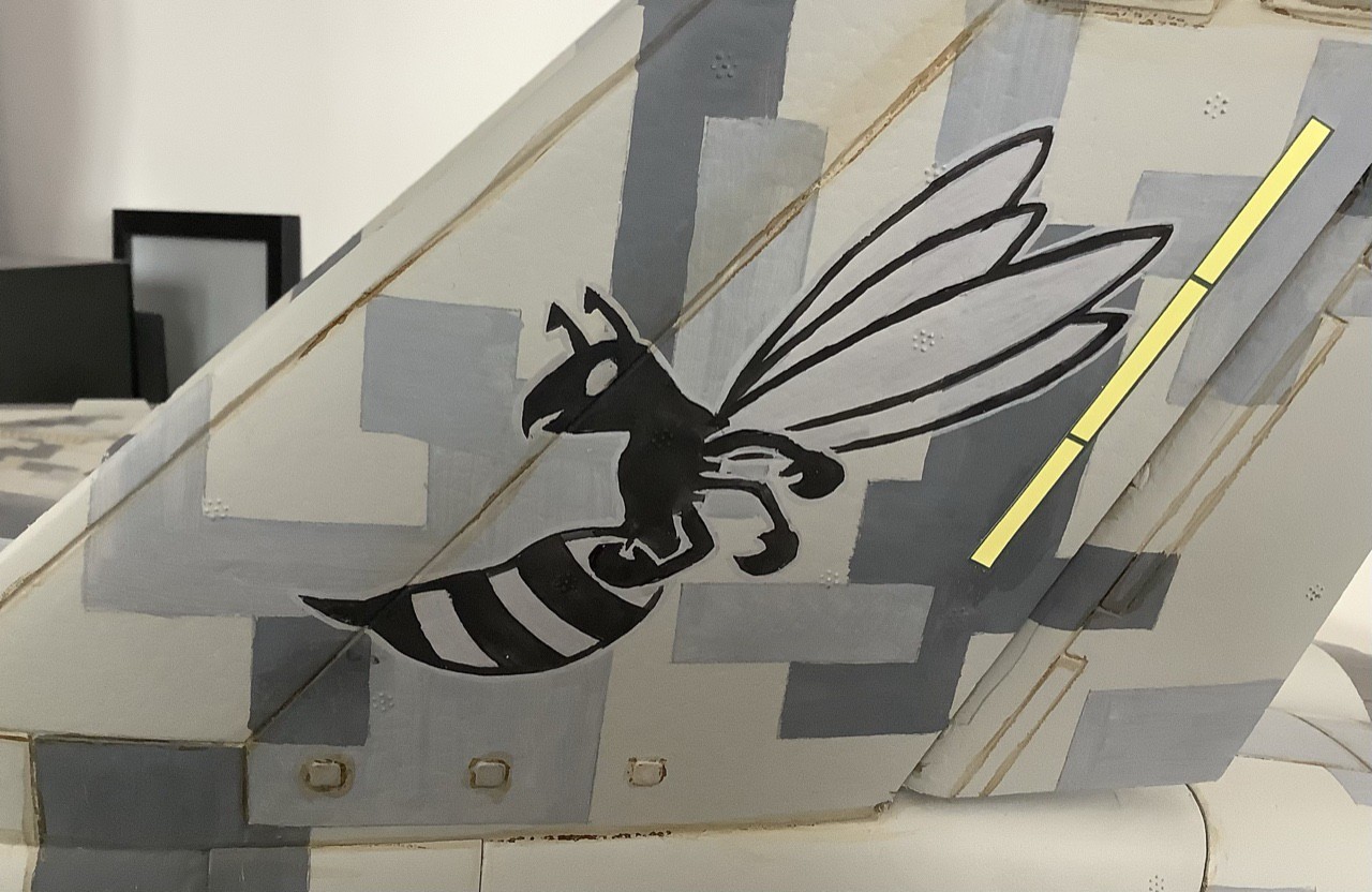

  • And a last closeup of my Hornet.

          Is all of this "hand painted", including the hornet? Outstanding work, you must have the patience of Saint!
          • I made a simple template for the contour of the hornet. Indeed the rest needs some patience, a steady hand and good and thin brush. For details I use DaVinchi 5/0 brushes. Not cheap but worth every Cent.
            By the way, take a. Close look. It‘s not perfect at all. But good enough for a jet in the air.

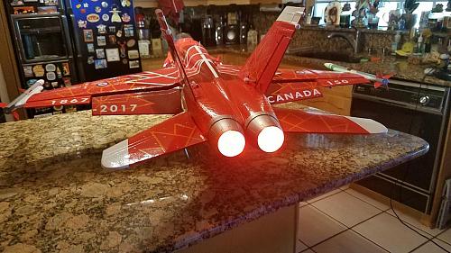

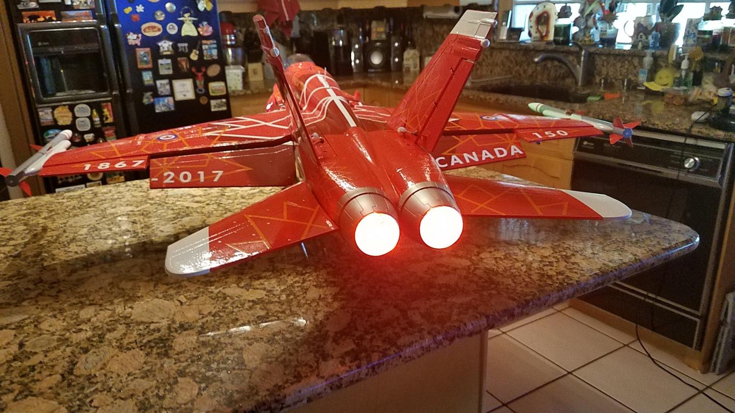

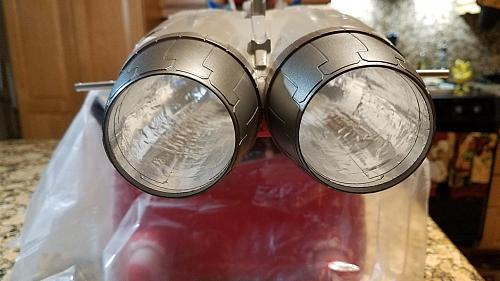

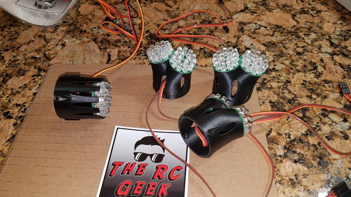

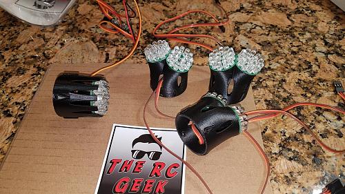

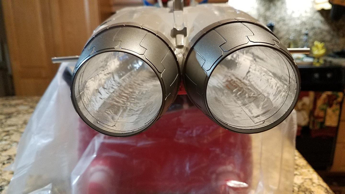

                              IMO, the 2 best LED burners are from either the RC Geek or Gooniac. I have AB's in all my EDF's except the A-10 and wouldn't fly without them. I just happen to use the RC Greek's because I started with those, but a friend has Gooniac's and both are outstanding. If you put them in the F-18, go to the Geek's website and pick out the Twin burners for the 90 mm inrunner (and in the comment section just tell him which inrunner you have to make sure it is the correct one). Since the F-18 has a single EDF, you want to get the twin burners mounted on the single EDF so each nozzle has it's own burner. Also, don't y-harness the 2 leads together, leave them independent to the controller (which has 2 plug in ports), that way each nozzle will "flicker" independently so it looks like 2 separate jet engines. If you hook them up on only one port, which you can, then both LED cones flicker the same and it just doesn't look quite right.
                              Installing them is relatively simple and you can program the throttle position that you want them to start "burning" at. Also, I would recommend that you line the exhaust nozzles with either aluminum AC duct tape (best reflective quality IMO) or at least paint the nozzles with a highly reflective paint (not quite as good, but not too shabby either). Get yourself a 2S 250 mah to 450 mah Admiral battery with JST connector to supply power. I get about 4-5 five minute flights on a 450 mah battery, but then again I have them coming on at about 35% throttle (50%-70% is more normal and realistic- but I like mine flaming most of the time-if you got it, flaunt it).
                              .................................1) Single and Twin Afterburnes:...................................... .................................................. ....2) Aluminum A/C Duct Tape in F-18:............................................... ............................3) Fired Up in the F-18:
                              Click image for larger version  Name:	20200406_211903.jpg Views:	0 Size:	239.2 KB ID:	295138Click image for larger version  Name:	20200426_183556.jpg Views:	0 Size:	135.7 KB ID:	295139Click image for larger version  Name:	20200427_173546.jpg Views:	0 Size:	191.4 KB ID:	295140

                                • I received mine from RC Geek, but I do have mine on a Y- harness, will try the other way to see which one I like better.
                                  • Originally posted by steven gubala View Post
                                    The only difference is that each nozzle "flickers" independently. Most people may have a hard time even noticing the difference, but since I'm aware of it, it looks better to me if they are independent. This is also more noticeable just as they start to come on and at the lower range of the throttle, but once they're fully lit at 80-100% throttle and the bird is zipping around, almost unnoticeable (unless you fly at night ).
