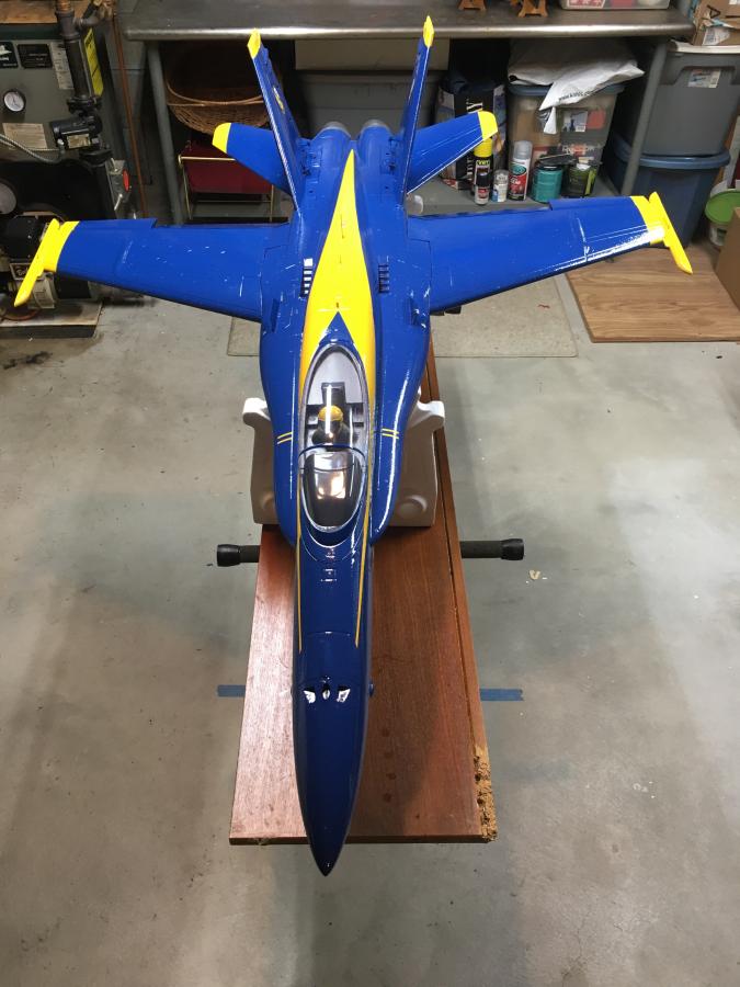

    • Originally posted by flyinhigh042 View Post

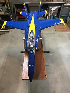

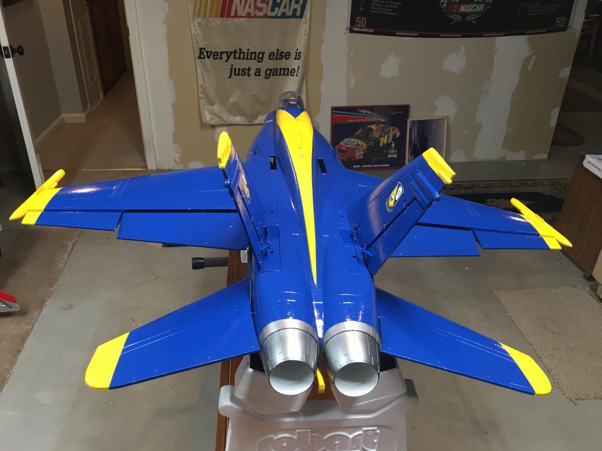

      Excellent. I just now ordered the Blue Angels ARF+. Also planning on installing the EDF 4068-1835kV in-runner / 12 Blade from my recently crashed F-15. Also considering doing the elevator servo and linkage upgrade.
      What brand/type clear coat do you all recommend to liven up the Blue Angels scheme?

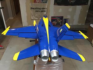

      Used Minwax (water based) Polycrylic -Clear Gloss. Goes on milky white, but dries crystal clear. I did one real light coat then went over it lightly with a scrotch brite pad, then a second coat. You wont be disappointed with the results
      . Click image for larger version
Name:	Finished Nose 1-9-21.JPG
ID:	293867Click image for larger version
Name:	Finished Tail 1-9-21.JPG
      The EDF from your F-15 will work great in the F-18. Strongly suggest you do the elevator up-grades. Always better to be safe than picking up a bunch of small blue pieces.....

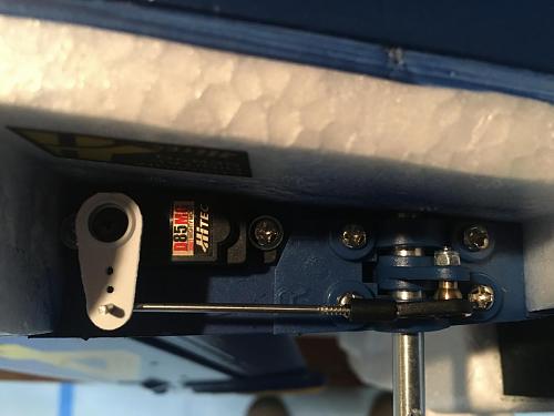

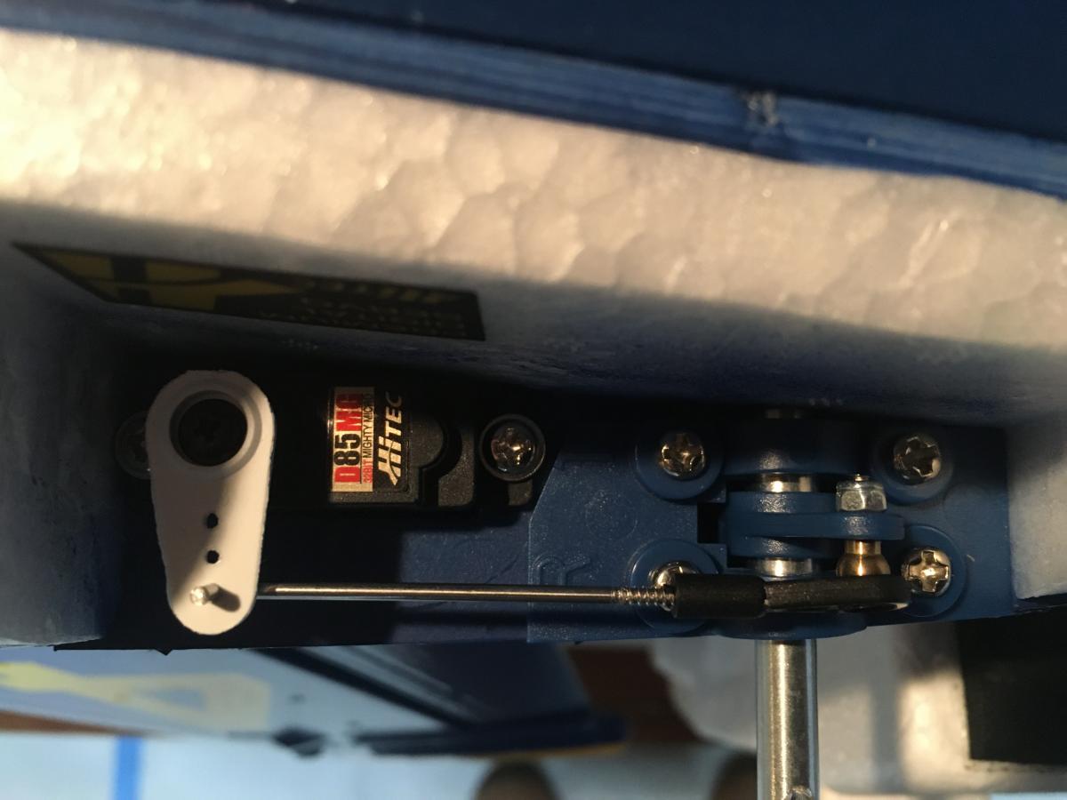

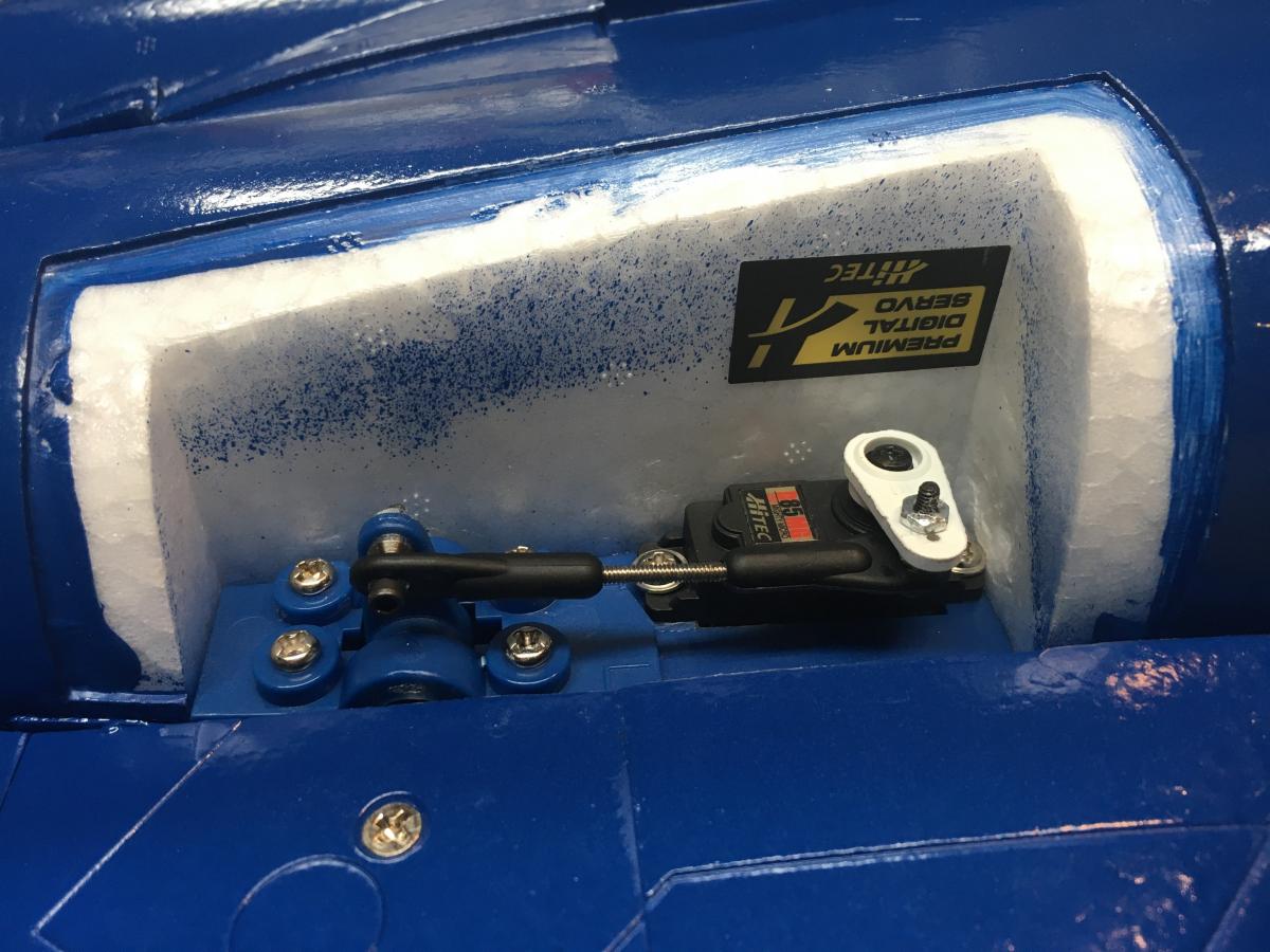

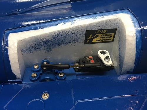

                  • Originally posted by Cape Jets View Post
Name:	Std Elevator Link 1-5-21.JPG
                    Standard linkage for the elevators. Upgraded the servo to the Hitek.
Name:	Upgraded Elevator Link 1-5-21.JPG
                    New upgrades for the elevator servo's and linkage. Much better action and eliminates any biding issues with std linkage.
                    My F-18 won’t arrive until at least the end of the week. My uncle just finished assembling his F-18 and is also considering the elevator servo/linkage upgrade. He was looking into it tonight and is finding the servo won’t release from the pocket due to the servo wires being securely fastened to the model. Any suggestions here?
                    Thanks!

                      Thank you for the information. Noted. I was planning on upgrading the linkage as well. Using Dubro 2-56 ball links. We will also take a closer look into the security of the bearing block.
                        Thanks!
                        First ..congrats on the New F-18,,,,,,,The elevator servos are in there really tight and take some doing to get out. There should be enough of the servo leads for you to remove and disconnect.
                        As far as the up-grade I used: Du-Bro 2-56 Swivel Ball Links on both ends with a Du-Bro 2-56 12" Fully Threaded Rod (need to cut to length) & the servo is a Hitec D85MG with Du-pro Hitec servo heavy duty servo arms. The servo's will require to be programed for the throw distance and you will need to reverse the action on one of them. Get the basic programmer and use your computer to set up the servo's. The Hitec servo's are really tough to get in the block space, but they will fit.....Many say its not needed and many swear by the up-grades. Its your call, but anything I can do to up-grade or improve any of my models I do,,,,
                        • Be careful getting the new servos into the pockets for the elevators also.
                          It's very easy to cut through the insulation on the servo wires if you try to force them in. The space is tight and the corners are sharp.
                          It helps if you put some electrical tape over the wires to act as a sacrificial buffer between the wires and the plastic corner when you install. As does rounding off the corners of the servo pocket.
                          As far a servo replacements, the flap servos are 9 gram and marginal for the loads needed for those big flaps. I've had unequal flap deployment with them, as have others. Move as close to the inner-most hole that you can, or those would be first on my upgrade list vs. the elevators.

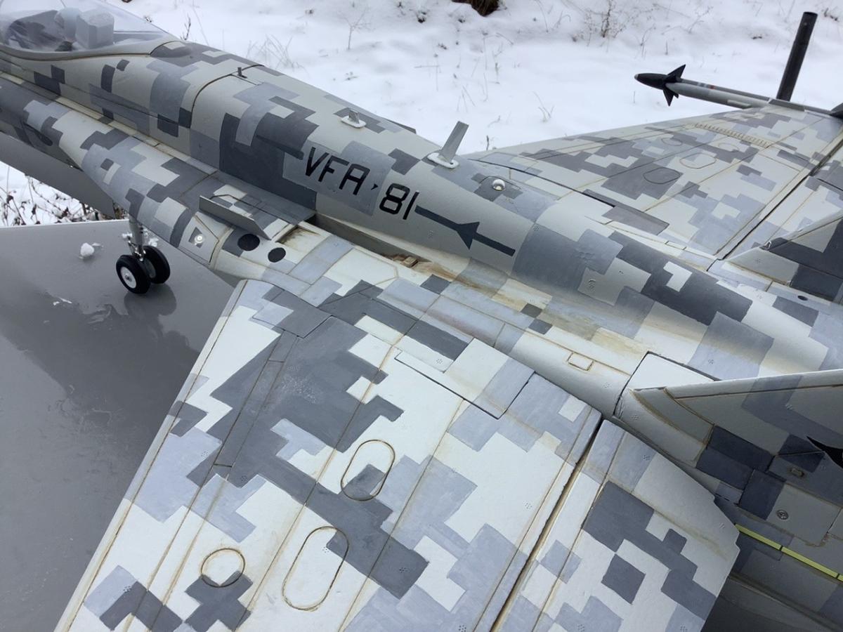

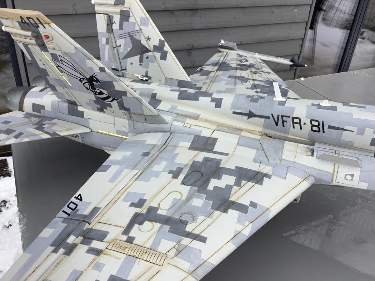

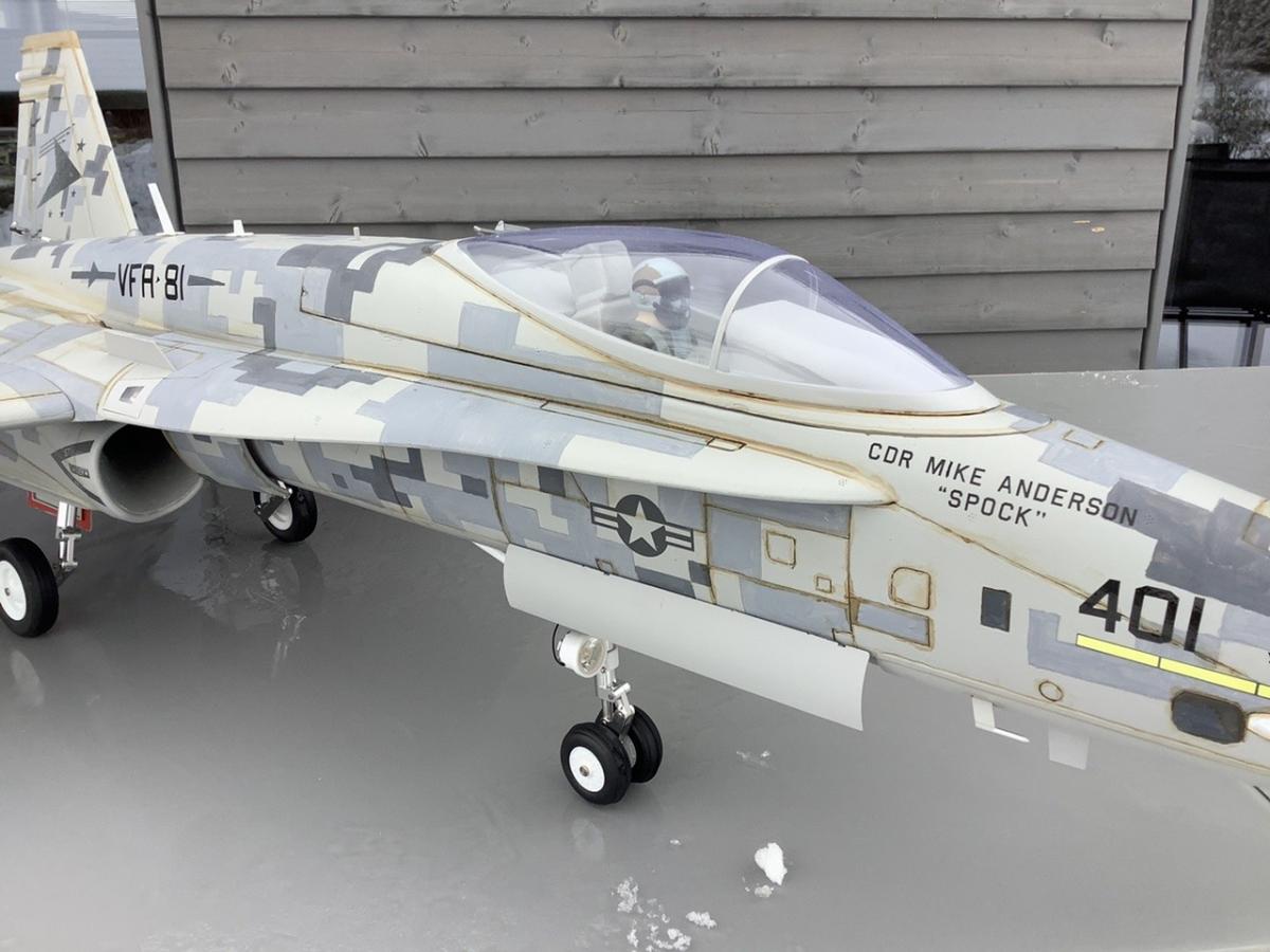

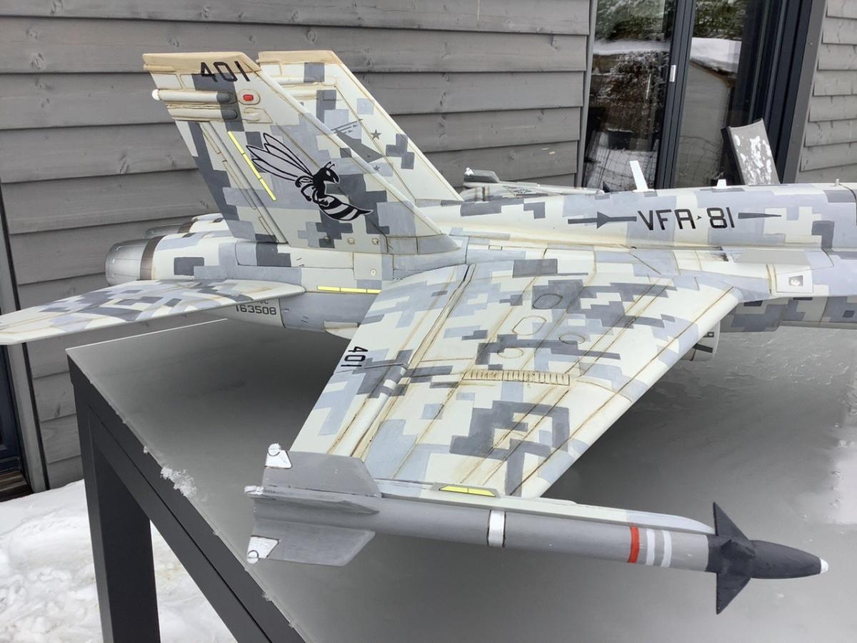

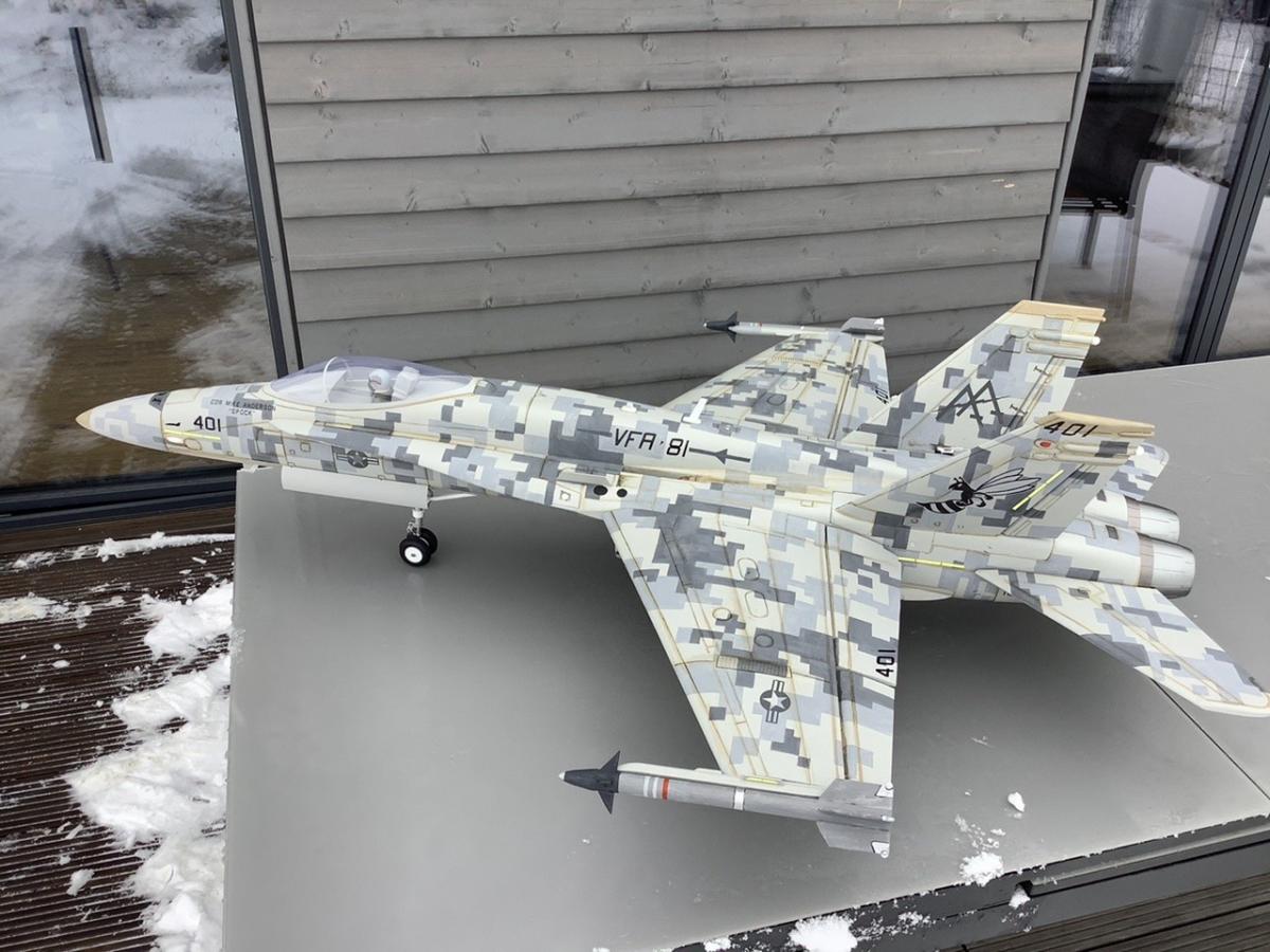

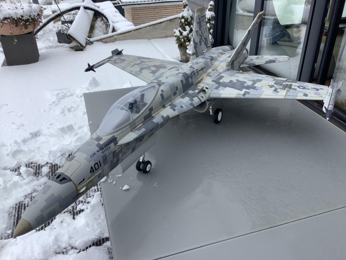

                                        • Originally posted by James View Post
                                          Unbelievably gorgeous work Polyphren! Would love to see more pictures at other angles when you get her out to the field in the sun.
                                          Being out on the field might take a while. It´ s all white and temperature is far from comfortable.
                                          Nevertheless, the outside of my F/A-18 is finished.
                                          A black cockpit would be nice, but I don‘t want to damage it. Perhaps I‘ll buy a spare part for this experiment.
                                          Click image for larger version  Name:	7565293F-C754-404B-BD87-344224435AFE.jpeg Views:	1 Size:	101.0 KB ID:	294897
