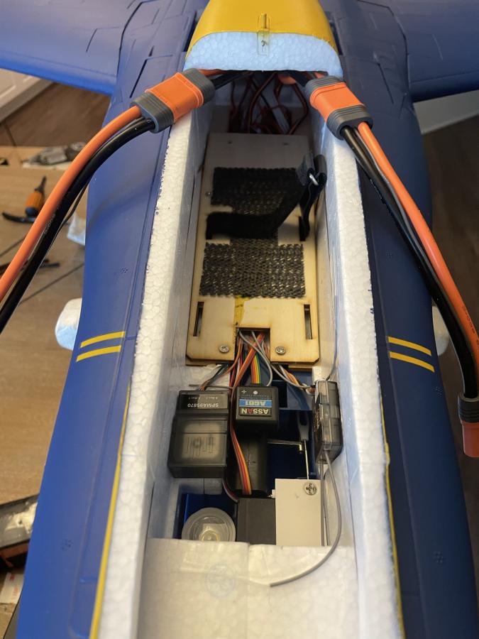

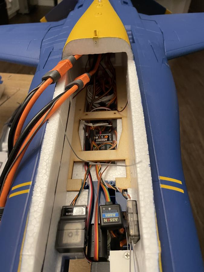

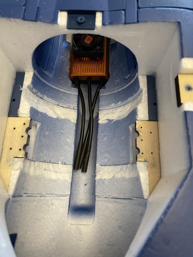

                        #5631
                        Looks like it flies really nice. Did you add thrust reverse?
                        Sure did. I added the Spektrum 120a, 6-12s ESC. When combined with the AR8360T and my IX12, it enabled me to forward program reverse onto Ch 9 (Aux 4). Significantly reduced landing rollout. I had to shave out some foam to fit the larger ESC, but if I had discovered SMC batteries earlier, I likely would’ve never made this update. Pics attached.
                        I also flew it with two SMC 4s 6200mah LiHv batteries… AMAZING!! SMC batteries are the new GOAT in the battery industry. The 4.36v charge instead of the standard 4.20v is game changing. It’s like turning a 6s or 8s power system into a 7s or 9s setup without updating the ESC.​
