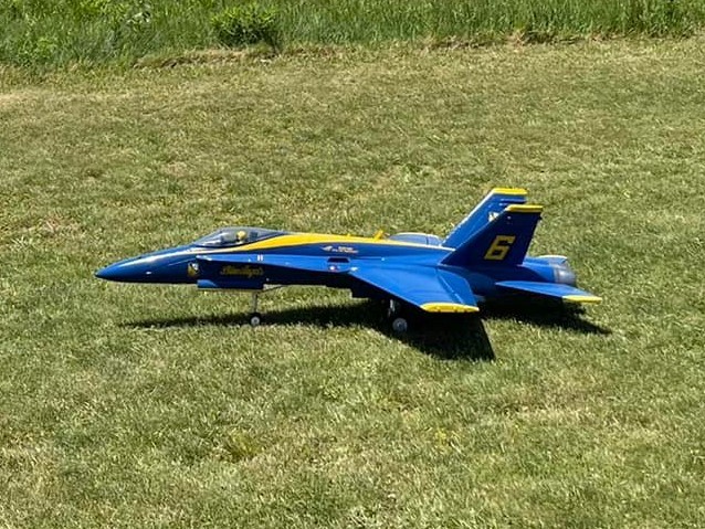

                        Well I've joined Aros and I'm sure many more that has given up on this jet. Yes she looks great on the ground & when she fly's she looks great in the air. The issue is we spend more time repairing this bird than flying. I know everyone says its part of the hobby to have occasion failures, but this bird takes more of its share than any other bird I fly. After 7 replacement fuses and main wings it time to step back and fly the birds that like me Maybe we will revisit her again next year since all I need is a new fuse to get her back in the air....... Click image for larger version
