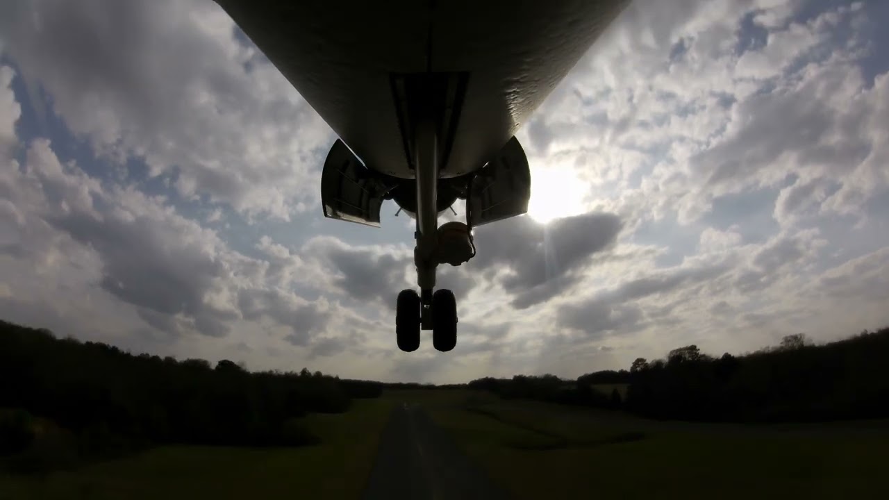

    Three flights yesterday. Wind was out the northwest, and I was flying off of runway 23. Wind 310/8 gust 10-12 KNOTS, a slight quartering crosswind. I wanted to see how well the Plus RX would do. You can definitely see it's working hard. Enjoy!!!
      Elbee commented
      Editing a comment
      3 point landing, impressive, Sir. Great vid. Best, LB

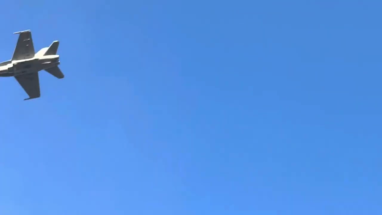

    My friend Zach got some great video flying the F-18. Three flights of video edited down to 2:30. I noticed on landing my flaps did not go to landing flaps, they stopped at takeoff. Need to look at that tomorrow. Please enjoy.
      Elbee commented
      Editing a comment
      Great video. Nice piloting. Well done, Sir. Best, LB
    She sure flies nice with that Plus RX!! Love the dust on the runway, makes it look like the real thing.
    On the flaps not working, both of my F18's have had that issue. Definitely doesn't fly well when one flap goes to full flap deployment and another stays flat. :dizzy_face: On mine, it was never the same flap that didn't deploy. First I wired the flaps directly avoiding the circuit board-still didn't help. Finally replaced the flap servos with Hitec flaps and that solved the issue on both! :triumph: It seems the stock Freewing flap servos just don't have enough guts when in flight with high aerodynamic forces to work 100% of the time. Hate to say it, but the only way to solve that issue is replacing the flap servos, drop in fit for the hitec HS-5065MG+ Digital Mighty, 11.9g servo (23.68mm X 11.6mm X 24mm), about $38 each. I know, more to make things work properly. I'm sure other similar servos will work as well. Sorry I forgot to warn you about the flap servos earlier, but actually thought it was just an issue for me since we all know I'm SPECIAL! :smirk:

      I’ve had my suspicions on these flap servos and I’m going to purchase the ones you suggest.
      My step son, Marine reserve F-18, purchased one and has several flights on it and says it’s flying characteristics mimic the real thing. He called me yesterday and said he went vertical and let it fall out into flat spin, several turns and the recovery was flawless.
