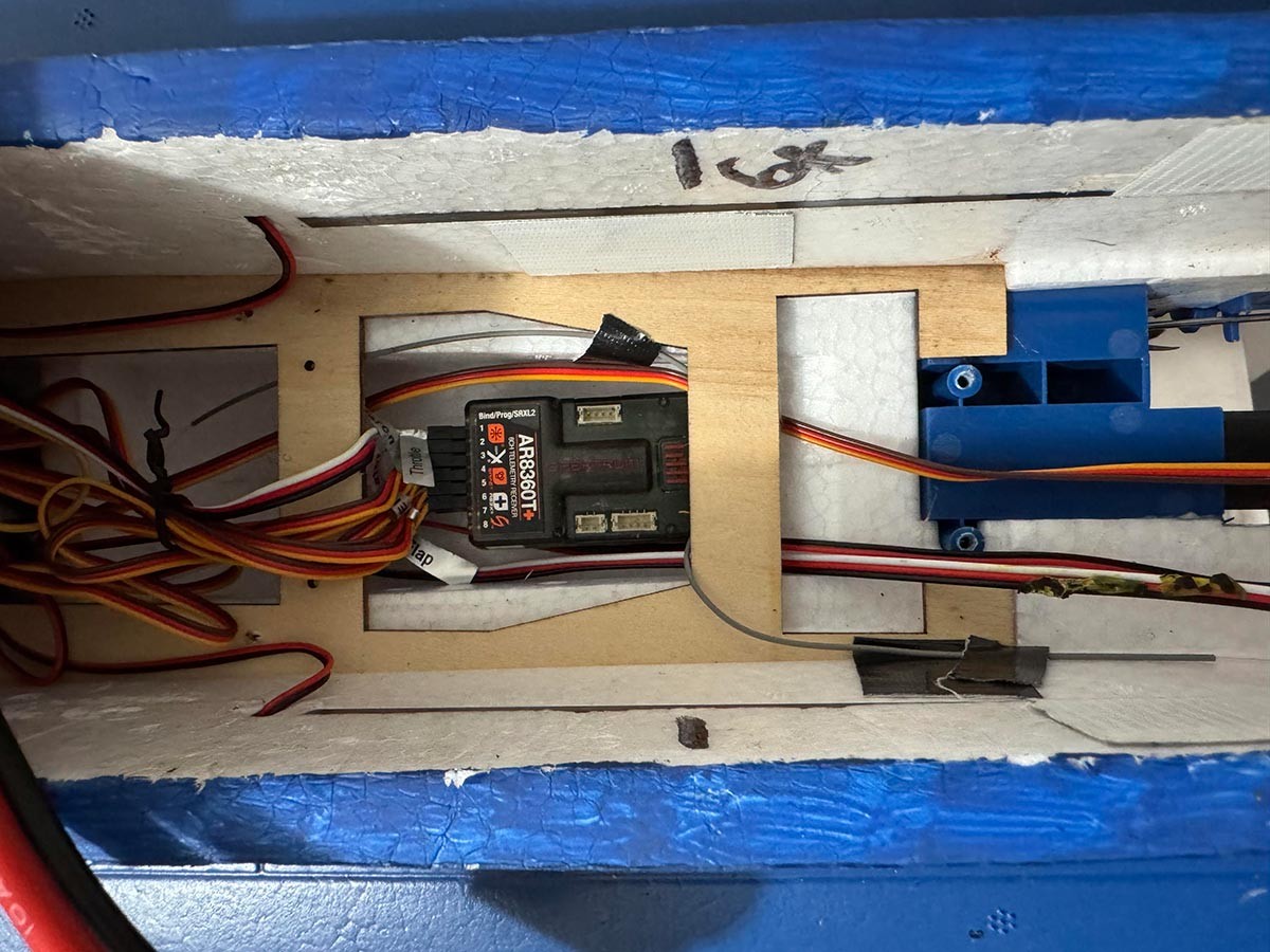

      Originally posted by Aros

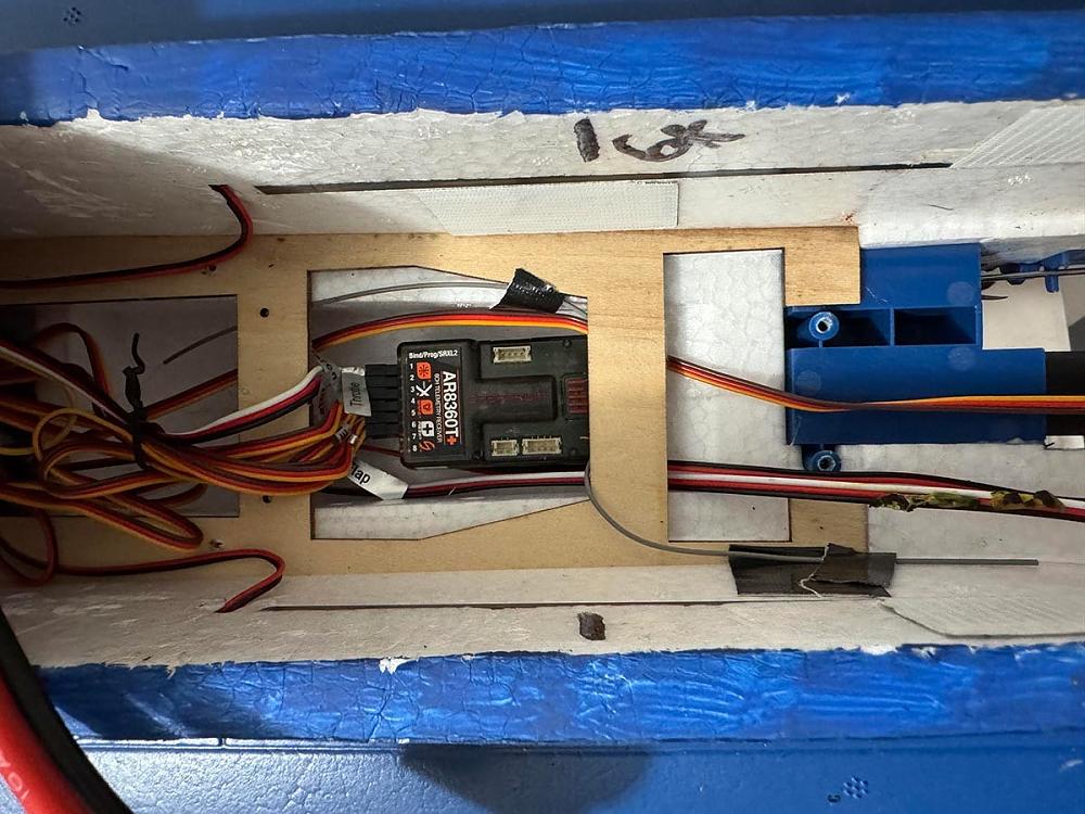

      Good stuff! When I opened up the battery tray the RX is still facing forward, flat, all servo leads still firmly plugged in place. One of the antenna wires is facing aft and one facing forward (see photo). I may even have a spare satellite antenna I can use to add to the configuration. I should have done that to begin with.
      Hopefully it's just an ESC replacement and she's back up and ready to go for a second attempt. I will be pushing the battery forward to get closer to manufacturer's recommended. It really did act tail heavy from the start. I couldn't seem to get that nose down to control her and bring her back to me which is why she kept flying away from me until the crash.
      I'm determined! Especially with this exceptional good fortune thanks to my search crew!
      Click image for larger version  Name:	unnamed.jpg Views:	59 Size:	243.3 KB ID:	428468
      Noticed in the photo that your antennae are placed 1 going forward, with active end (stripped exposed wire) horizontal and the other going aft with the active end also horizontal. Unfortunately, with both on the horizontal plane, you are only covering 1 of the 3 directional planes. You will get a poor signal reception on a horizontal plane antennae when the TX is directly behind or directly in front of the aircraft. You need to place the active end of one of the antennae either vertical or left/right to get at least 2 planes covered. It still may be a temp loss of signal or resulting hold that gave you issues on the maiden. Also check to see what orientation we selected on the RX in forward programming. I know you felt it was tail heavy, but 88mm manual is just too nose heavy, at least for decent landings. I fly at 103 and I think you started at 98. Jandro flew his at 110, but that's Jandro. You may want to start at 92 and go from there. Here to help when you ready to diagnose the gyro set-up. Also, unfortunately the AR8360T requires a 4 pin matching sattelite, the SPM4651T which is a SRXL2 DSMX Remote and costs $58. Gives 2 more antennae, but I doubt you really need it if you get the main antennae placed properly. Then after ground testing and flight, go to the TX telemetry and see how many frame losses you get (up to 30-40 OK) and holds (even 1 of those is sayonara).

        I’m a firm believer in satellites. My Hornet has two, one in the nose wheel well and one under the right vertical stab. It’s also a good idea to keep the active element end away from servo, especially the ESC lead) or battery wires. Having the shunts GG talks about on leads can also help though I don’t use them.

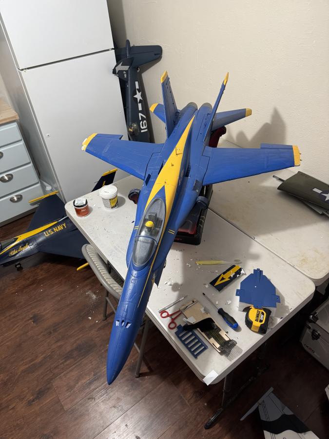

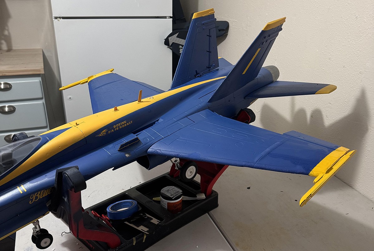

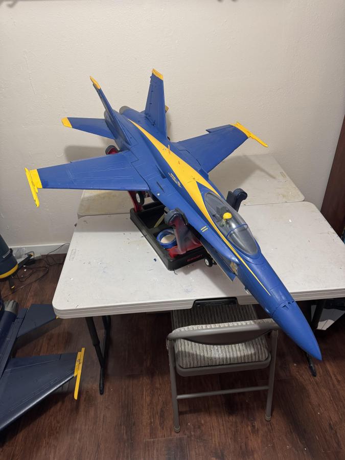

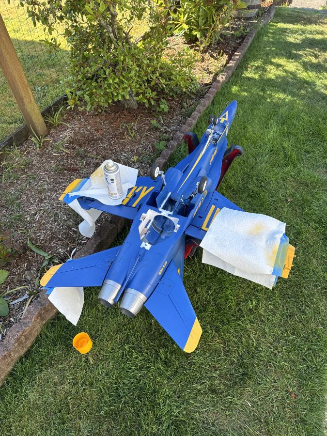

              Thanks to a good friend, Elbee (who would rather remain anonymous I'm sure...Whoops, heh heh), my once fated and unceremoniously tossed into a forest F/A-18C Blue Angel has the mandatory missile rails added to the wingtips once again. They really do finish the model off perfectly.
              Thank you dear friend. Now onward we go with great hope for a more successful (re)maiden!

                Click image for larger version  Name:	Untitled2.jpg Views:	0 Size:	42.4 KB ID:	428911
                Nothing like yellow missile rails to make a "Bug" look sharp.
                Best, LB
                Ps: Make certain you apply enough adhesive to the "Outer Part 4" ends, so it does not separate at Mach 1.475.

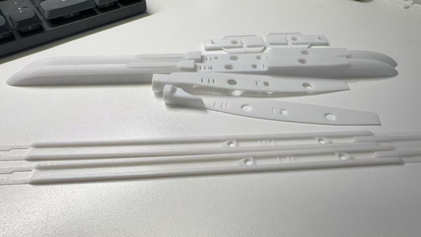

                      https://www.printables.com/model/134...le-rails-lh_rh
                      Hornet Dudes and Dudettes,
                      I have posted the aforementioned FreeWing Fa-18C Missile Rails on Prusa Printables.
                      Better late than never, as I wrote I would do this a couple years ago
                      Please Note:
                      My design is more scale than functional and makes no provision for adding Aim-9s, but you can drill these out and modify in order to do that yourself.
                      Now that said, it won't be the 'slide on/slide off' as per OEM.
                      There you have it.

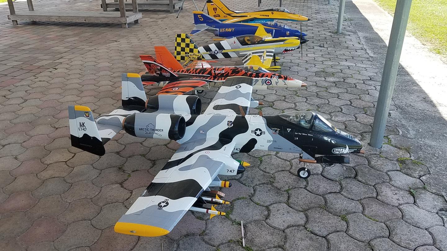

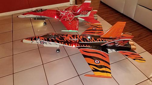

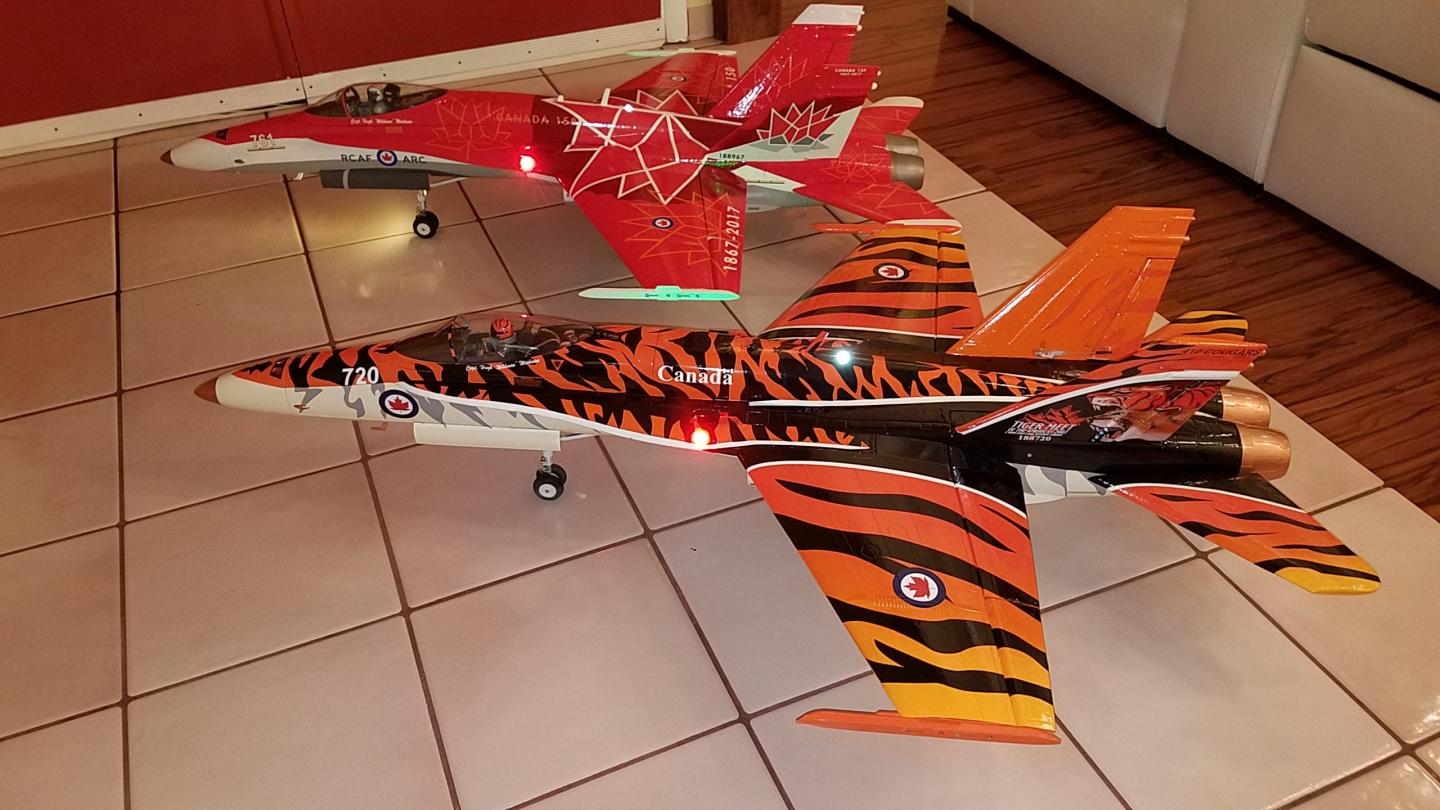

                                    Got out last Friday with a few, including my F18'S. Been flying them a lot after converting their Ar637T to Plus, flies awesome on a HiV SMC 5900, OVER 5 minutes. Unfortunately our summer Bermuda grass field, although cut short, has gotten thick and luscious with all the rain and sun, great for your front yard but not a runway.
                                    Both have the older 12 blade 4068 inrunner (think that's the size) which has always worked great but now realize I didn't fly these much in the summer. Extrodinarily long take off run (which seriously drains the pack) and when it gets off it's at or near stall speed. Violent rolls, usually left, occasionally right, made each flight an adventure. In the air it's fine and landing easy, but that take off ruins my normally cool and collected demeanor (OK, more BS).
                                    So I'm biting the bullet, just ordered one 8S setup that I have (and love) in both F4'S, F16 V1 and Euro, which get off in 50 feet in the summer grass. The F4 and F16 fly great on a HiV SMC 8S 5900, but expect to use an 8S 4900 in the F18, as God knows it doesn't need more weight. I'm probably creating a bigger disaster but if I can't get off easily on this grass, it's no use to me. If it works, I'll do the other also.
