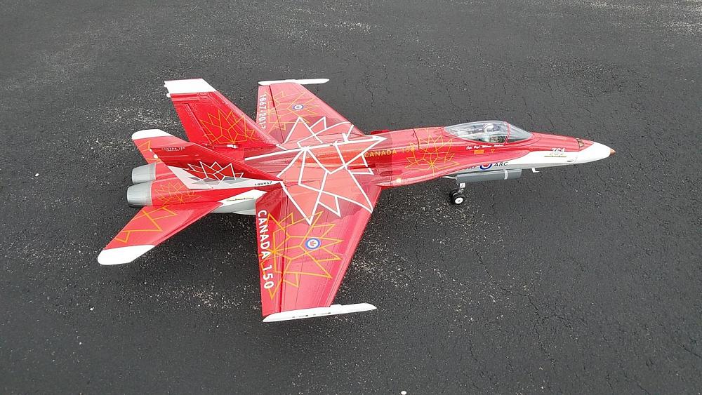

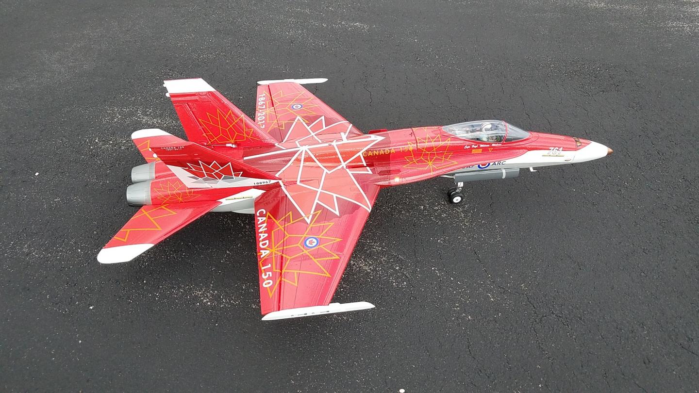

                Finally got the maiden in on the F-18 Canadian. Brinka was good enough to perform the maiden and get it all trimmed out for me, if Jason's not the best EDF pilot around, I'd like to see who is. When I grow up, I'd like to fly just 1/2 as good as he does. :clap:
                I was concerned that it wouldn't fly that well, considering it is over 1 pound heavier than the stock with the 3D cockpit, extra paint, urethane and afterburners, but it took off without any flaps and flew great. It's no speed demo, as his BA F-18 (he installed the stock F-16 fan in his BA) is a rocket compared to mine, but I'm more than happy to cruise around at slower speeds cause I can see the orientation better and guess I'm just a little old granny. It still climbs great as is. I've got the stock outrunner 9 blade 3748-1750 and was thinking I might need to upgrade it to the 12 blade inrunner I put in the F-16 or even the new 9 blade inrunner the BA now comes in, but I think I'll leave it like this for now. We used the RT 6250 mah battery and consistently came back to the pits after 4 minutes of aggressive flying with 45% battery left. The last flight of 3 it came in with 55% after 4 minutes, can't beat that (but I'm sure Jason had something to do with that).
                First flight was at 88 mm CG and it was very nose heavy, needing as much as 20% up elevator trim. 2nd flight he got it locked in as I moved the battery as far aft as I could (around 93 mm CG) and added enough subtrim on the elevator to level it and as they say, "the rest is history". Next flights I'll take it to my usual grass field and expect to have some real fun now that Jason has done all the heavy lifting. :hugging:
                Put together a video of the flight, but have to apologize for it as I did it on my phone and could have used some zoom. Guess I'm an equally poor videographer as a pilot.
                Here's the You Tube Link: https://youtu.be/JMQTuHvB4yA Looks better on You Tube instead of the small video below.
