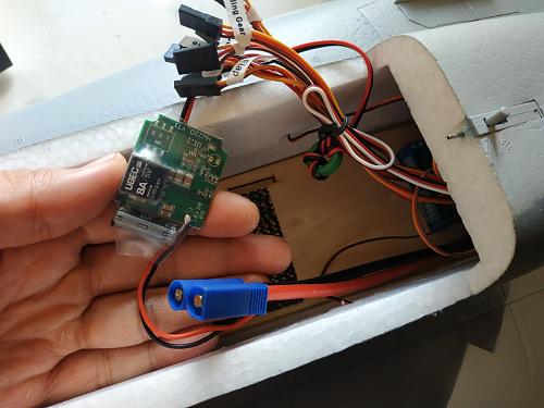

                                James where is the ubec located in the model? Is it easy to gain access to it to wire in the rc geeks centre burner?

                                  It's easily accessible:

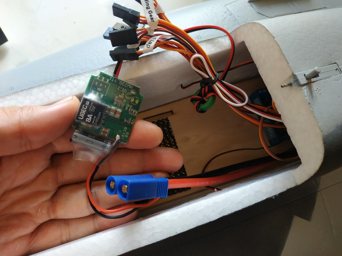

                                      Can I just confirm that I would wire in the rc geeks centre burner by splicing it in on the black and red wires between the EC5 connector and the UBEC? Or would it be spliced in on wires after the UBEC running to the Receiver/control board?

                                        I'm guessing splice it in after the ubec between the ubec and receiver/control board otherwise centre burner will receive the full 22.2 volts of the 6s pack
                                          If I read RC Geeks instructions on his webpage correctly, you don't splice it in anywhere before or after the UBEC. It requires a 7.2 volt power source. The UBEC puts out 5V. If you splice it at the EC5 connector, you'll get all 22.2V. You need a 2s LiPo or equivalent.
