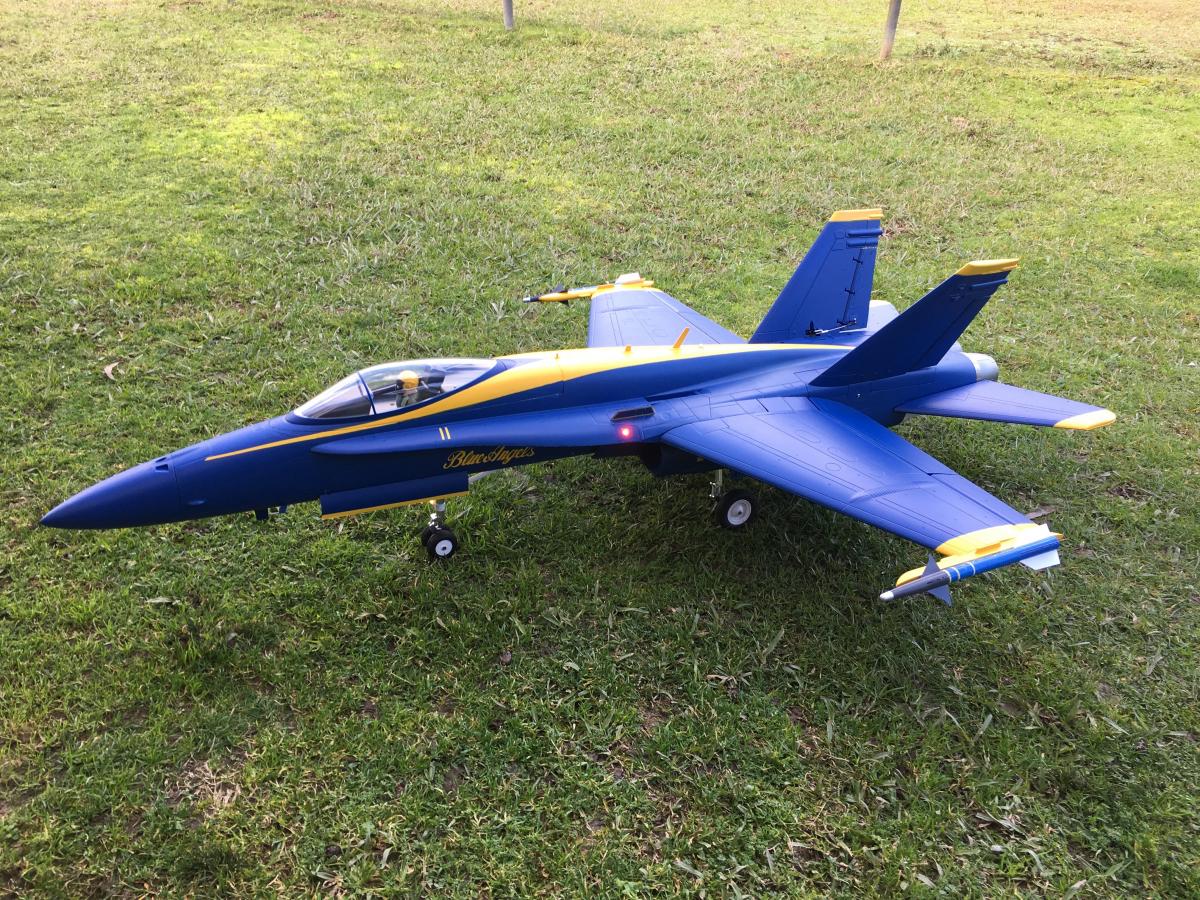

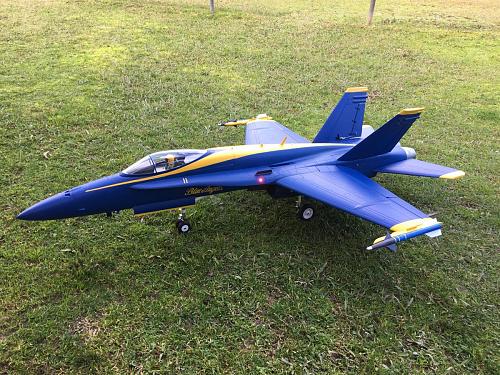

  • [QUOTE=Aros;n204609]Here comes #2. I am hopeful this one will have a drama-free maiden with no gremlins. The build was great, everything looks fantastic as one would expect. After range checking and final pre-flight checks, can't wait for her to be airborne! Love this model!!

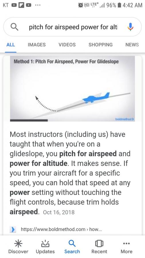

        • Originally posted by Phantom View Post
          Throttle for altitude and pitch for airspeed, I'm tracking. :Cool:
          Actually that is wrong - pitch for altitude and power for airspeed.

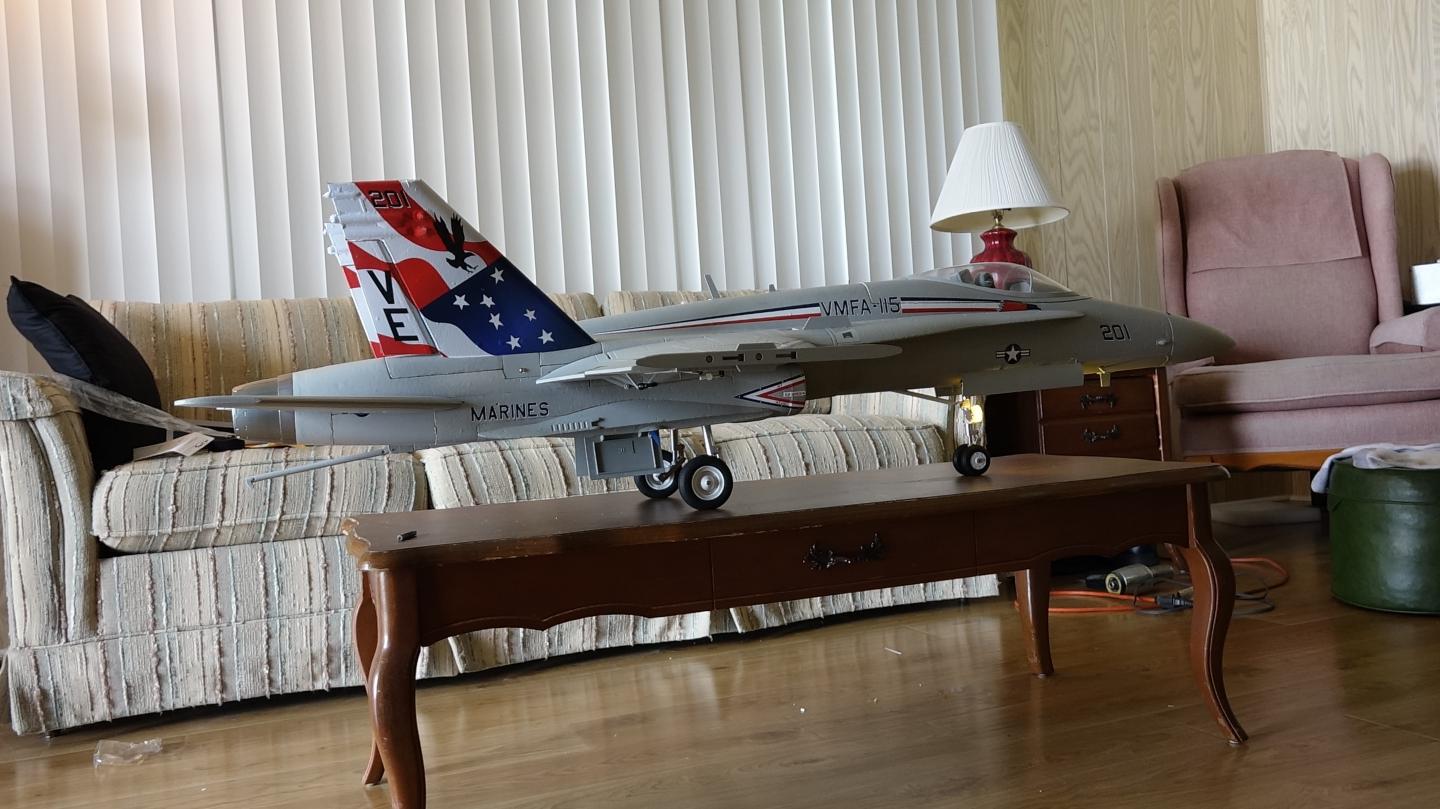

            • The Missiles don’t affect performance in flt..Looks Cool though ;) Click image for larger version

              • Originally posted by F22trainer View Post
                As a professional pilot, I respectfully disagree with you. There are two schools of thought on this however, I've never found nor attended your school's "pitch for altitude, power for airspeed." I dare say that it is not the professional aviator's school of thought. Why? Because it is unstable, the exact opposite of what one wants on an approach. If you pitch for airspeed, that now becomes a constant, using power to arrest or increase your descent is now your biggest variable. If I were to use pitch for altitude, I am trading airspeed for that altitude. I am either decreasing airspeed for increased altitude or increasing air for increasing my descent. In either case I have to now adjust my power setting to either not stall, or to not over speed my flaps, gear etc...
