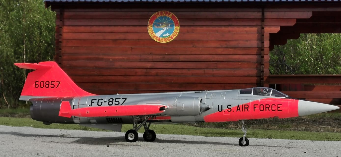

      My Freewing Starfighter.

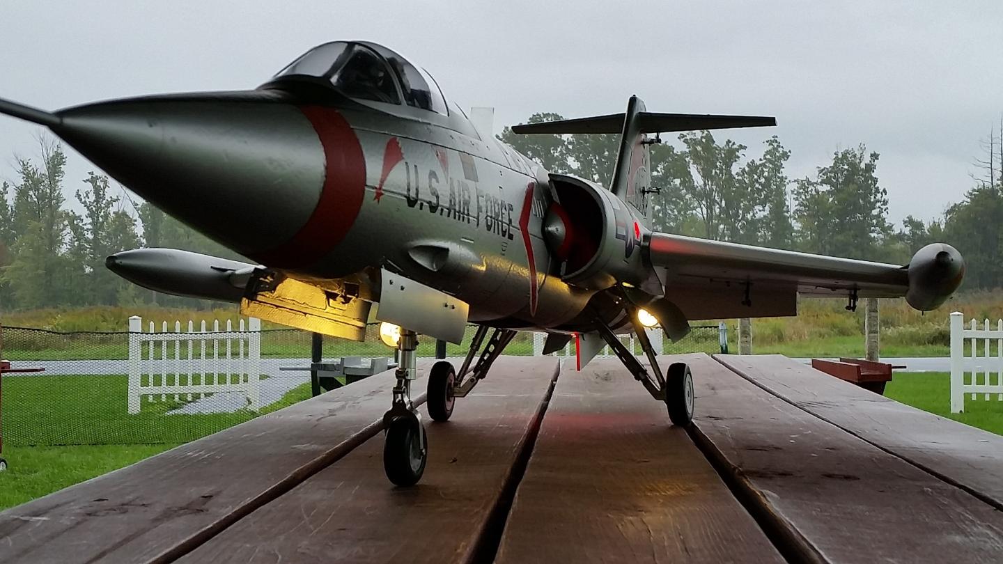

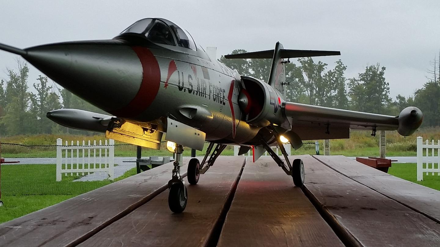

                                  I don't have the exact rates handy but this model is very sensitive to aileron, so its best to reduce the amount of aileron movement. When you lower the flaps this model will pitch downwards, so its necessary to add up elevator trim when you use the flaps. The model handles well during the approach to landing, so you don't need to have excessive speed. When you have the flaps and air brakes out it slows down and handles quite well during the approach. Exactly how much flap to use is not extremely important - the more flap deflection you have, the more up trim you will need. The gyro works best on a low setting, about 1/3 a turn of the little screws, or less than one-half. The control board can be in any position you wish, it doesn't have a gyro in it so its position makes no difference.
                                  I use a lot of flap, I set them down as far as they will go - they function mainly as brakes this way and along with the actual air brakes its helps keep the speed under control during landing. When you use a lot of flaps, you have to hold some throttle so that the plane doesn't slow down too much,
                                  Click image for larger version  Name:	20161002_123624.jpg Views:	0 Size:	159.5 KB ID:	392037
                                  Click image for larger version  Name:	20161002_114841.jpg Views:	0 Size:	238.2 KB ID:	392036

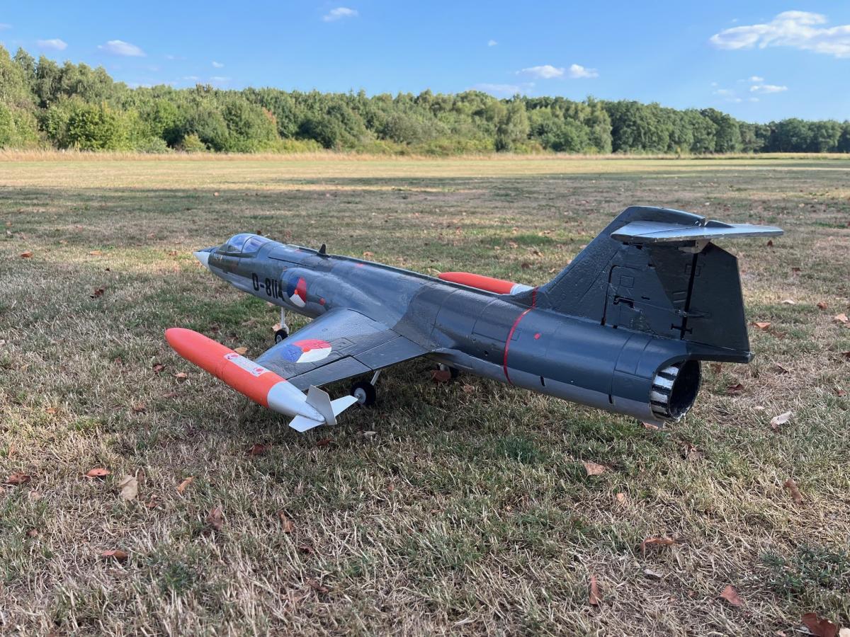

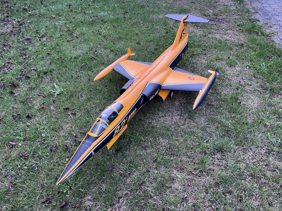

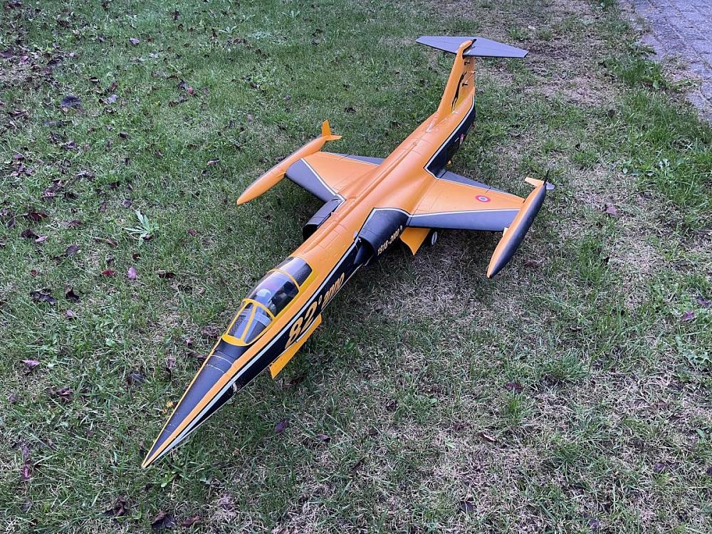

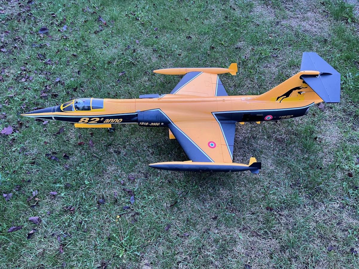

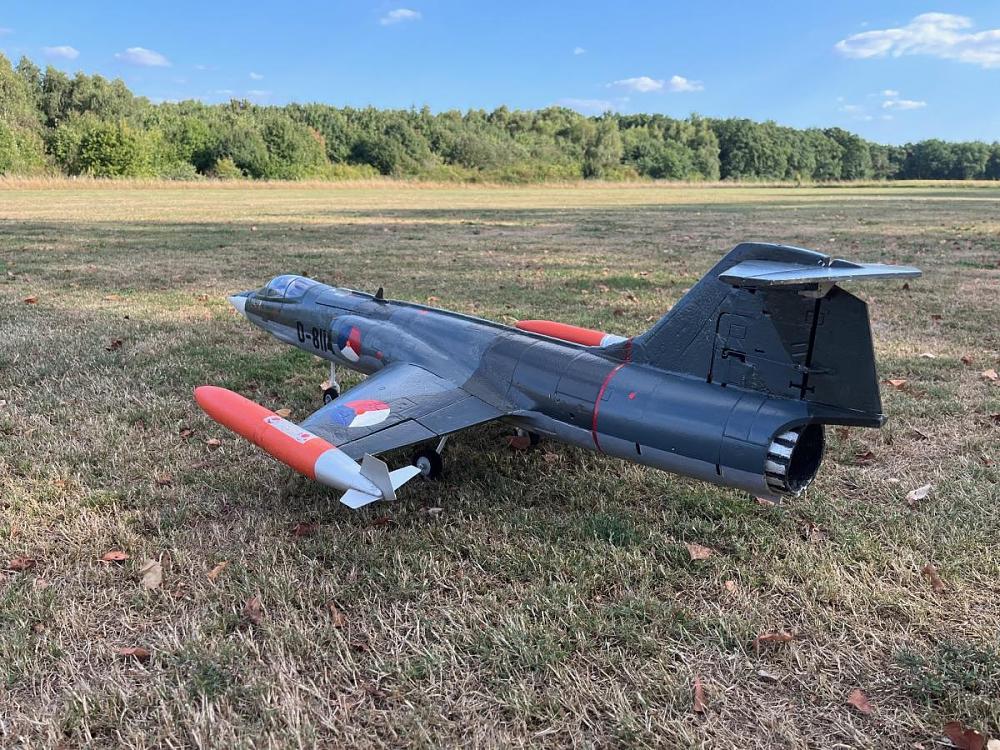

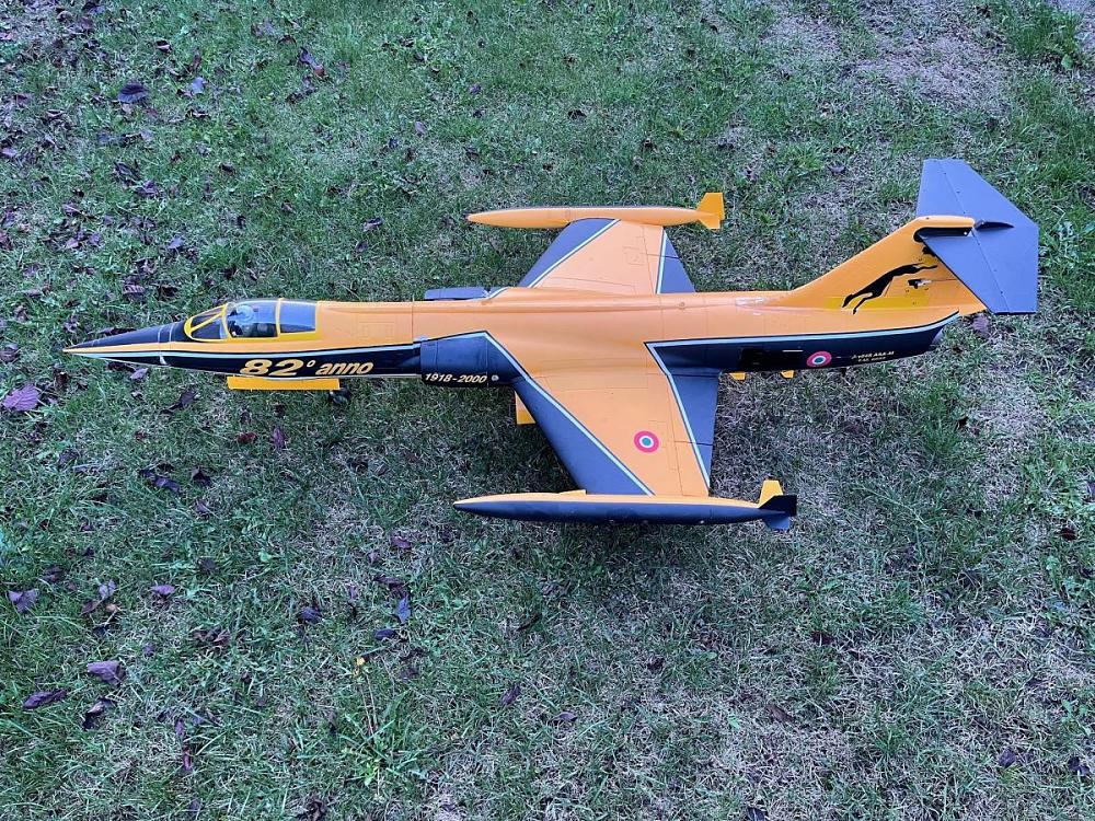

                                          Well, I still have my silver one in the box, didn't dare to assemble it and flying it due to my problems with my F104 70mm edf version.
                                          For me I found out with my 70mm one that CG in manual was to far aft resulting in my plane falling out of the sky when throttling back ore on downwind.
                                          I have CG now at 25 mm and it flies great.
                                          I found a yellow/black one on the second hand market and bought it.
                                          Had to read this thread again and also RCGroups for the best info.
                                          So I moved my aileron linkage to the 4the hole counted from outside, also I did this for my rudder and elevator.
                                          Flaps is 3the hole from outside, advantage is that you now use as much of the servo travel as possible.
                                          My CG I will start at front wing screws​.
                                          ECS settings, timing is set to med, cut off voltage is set to low and cut off type is set to soft cut.
                                          Rates are: Elevator 32-35mm up/down, Aileron 18-20 up/down, Rudder 18-20 left/right and flaps half 20mm and full at 60mm.
                                          Gyro gain is set for Aileron 5 o'clock position, Elevator 5 o'clock position and Rudder at 4 o'clock position.
                                          Now I have to wait for decent flying weather, for first flight not gusty wind ore to much wind.
                                          Regards Hans
                                          My F104 70mm EDF Klu
                                          Click image for larger version  Name:	Klu F-104G 1.jpg Views:	0 Size:	271.2 KB ID:	432350
                                          Click image for larger version  Name:	FW F104 900mm EDF 2.jpg Views:	0 Size:	412.7 KB ID:	432352
                                          Click image for larger version  Name:	FW F104 900mm EDF 1.jpg Views:	0 Size:	420.8 KB ID:	432353
