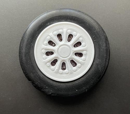

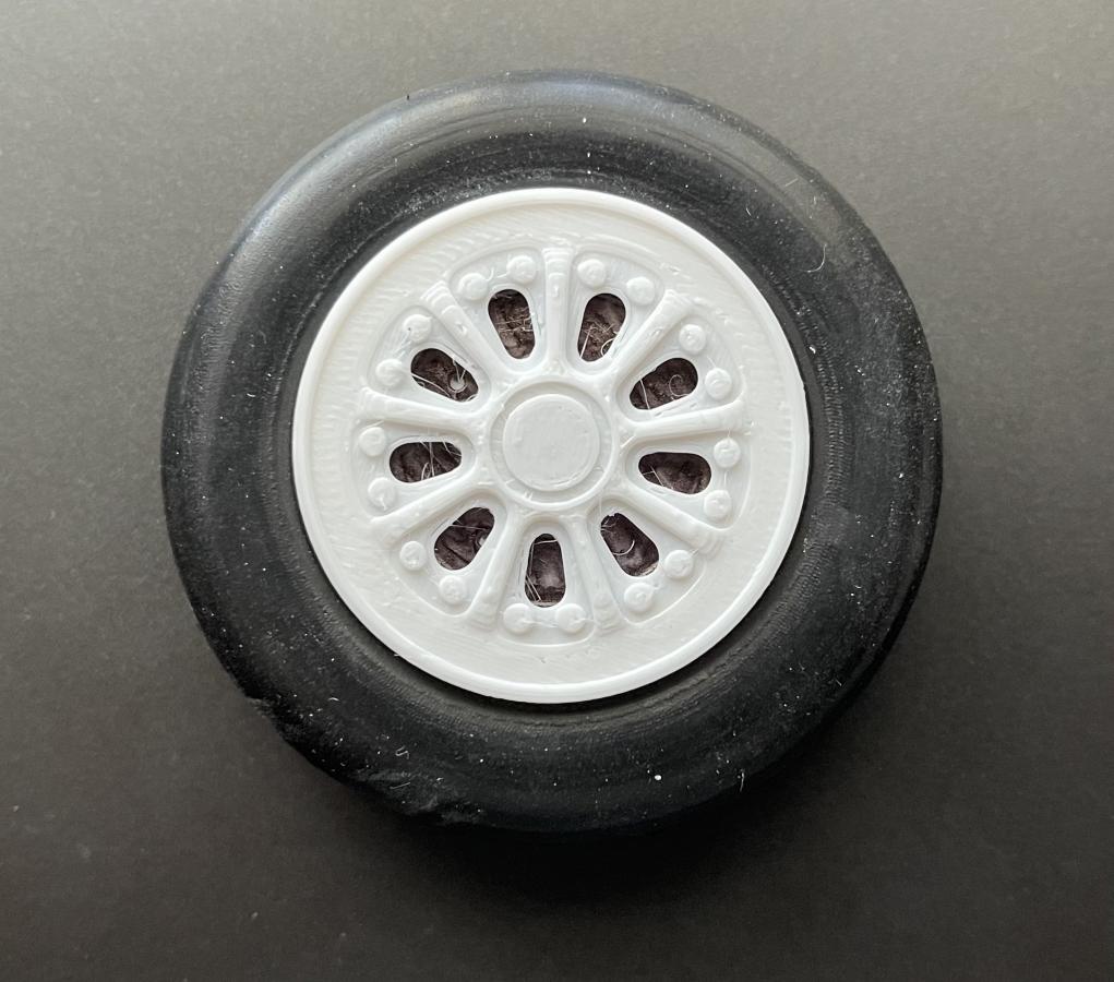

          Over the last few days, I had some free time to create some wheel covers for the Freewing F-104, F-16C, and F-4 90mm EDF jets . The STL’s files are available on Thingiverse.
          If you download and print them, please let me know how they fit on the jet. I don’t currently own any of the three jets, so feedback on fitment once installed, wheel axle clearance, etc. is helpful.
          P.S. Apologies for the redundancy if you’ve read this on the RCg forum already.
          https://www.thingiverse.com/thing:4780894
