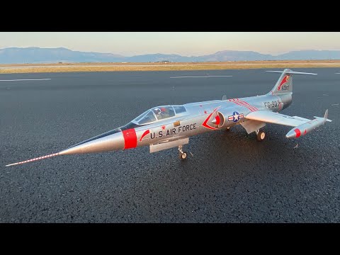

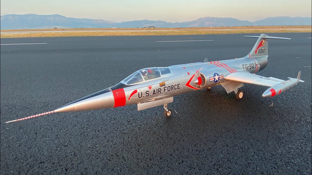

            Sunset flight showing off the finish on the jet for MotionRCs live show.

              Nice video, love the way the F-104 lands.
