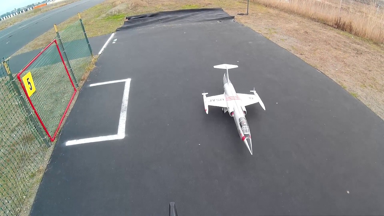

          Morning flight

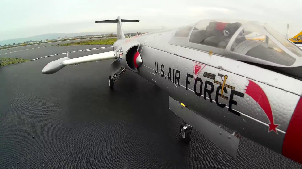

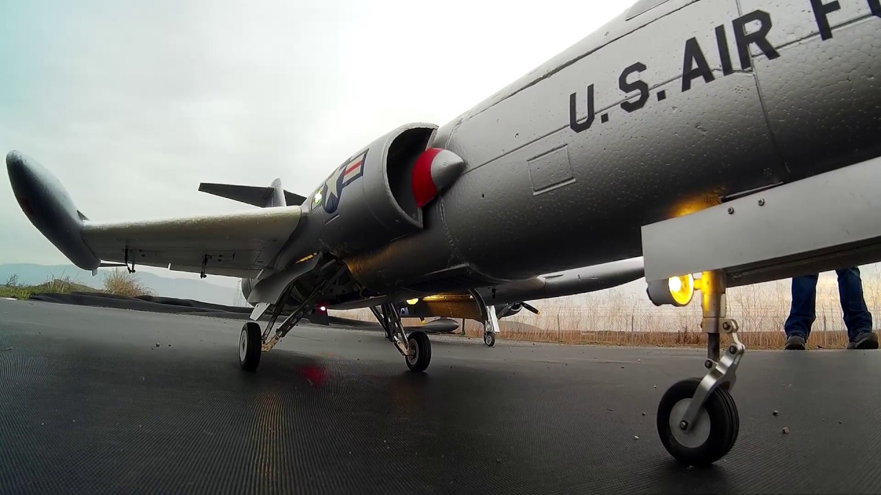

            Lots of flights this weekend. Got some radar runs in as well... take a look

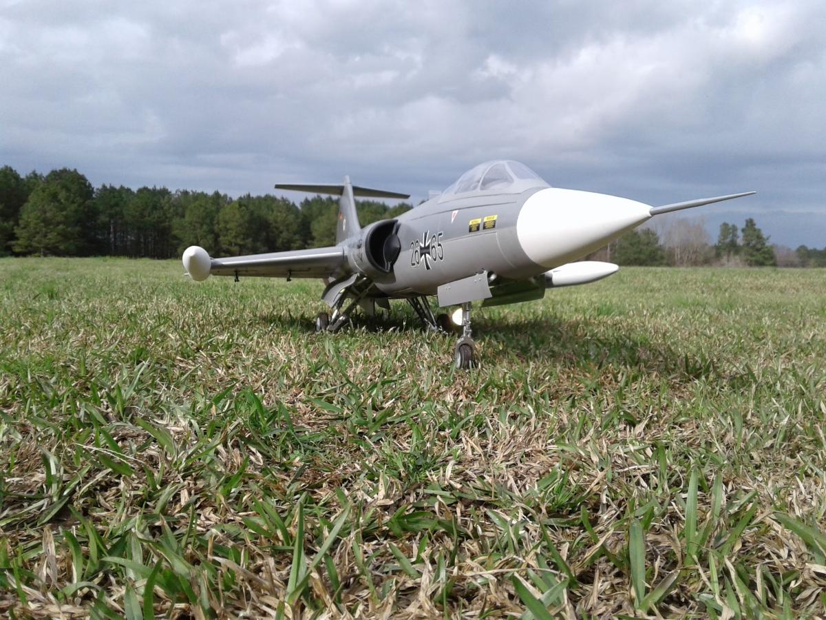

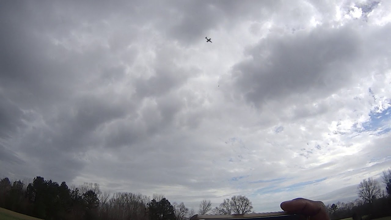

                      Flew the F-104 today in theMarinefliegergerschwader 1 scheme. 1st flight after total re-build and re-paint. 5th flight on the airframe. Gyro at about 20% all channels.
                      Conditions were windy with a gray sky. Also I had to slam dunk the approach over a line of trees. I think I came in a bit too hot. Still have to get used to the bird. But she's a keeper!
                      Stock power. My buddy didn't film the takeoff. But she got off in about 150ft or less. Most of the flight you see on the video was done at 50% throttle. This was a test flight and I was rusty.
                      Click image for larger version  Name:	20180223_152431.jpg Views:	2 Size:	205.9 KB ID:	119698
                      edit: He DID get the takeoff...on the helmet cam though and it's not so clear. But, the 104 got off a wet grass runway in about 125ft. Pretty dang good for a stock bird that's been repainted twice!
                      edit:
                      During this flight I observed no wing wag at any speed. I did a full deflection aileron roll with no oscillation observed at termination. This was a windy day. If you are getting oscillations on your 104, check that the gyro settings are not too low nor too high. My channel travels are all 100% except elevator which is limited to 80% down to avoid rudder. Gyro at approx 20-30% each channel
