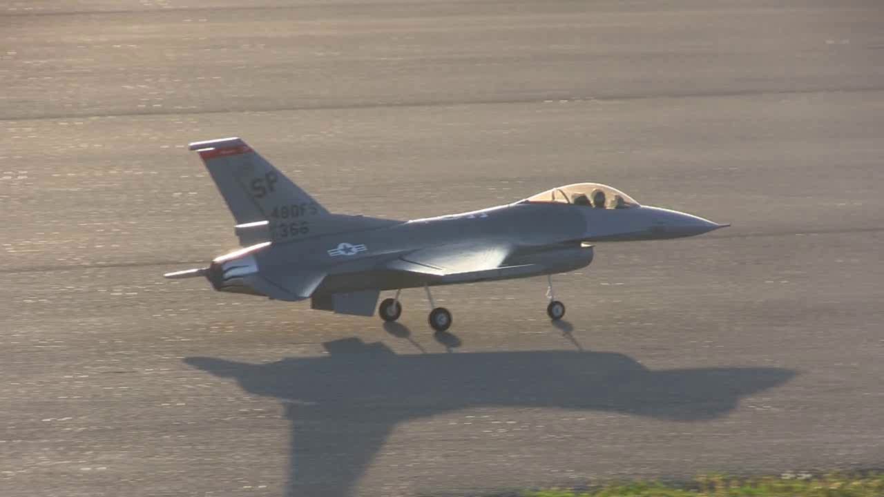

          Too hard of a landing on the Mirage caused nose gear collapse, which actually needed no repair, but the F-104 did well.

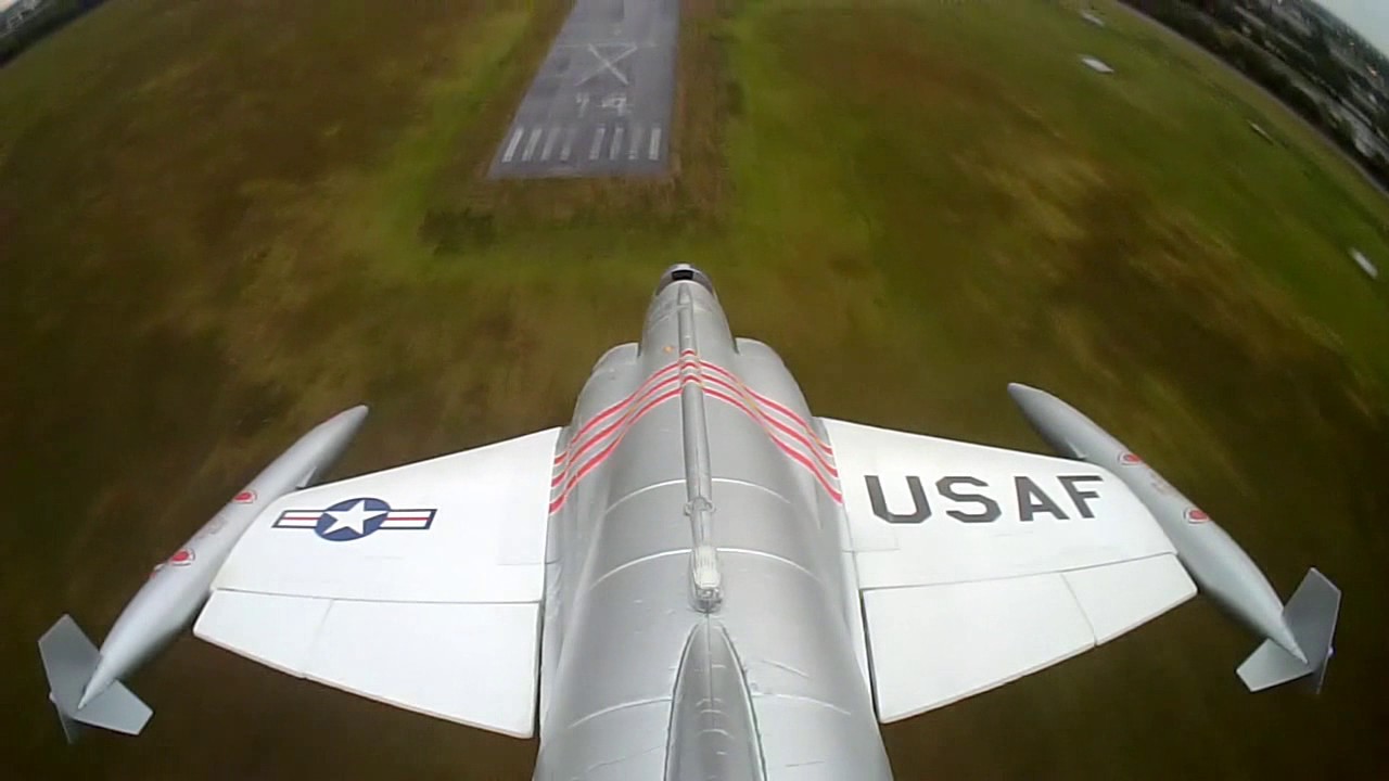

                I got lots of flying in over the weekend. Only was able to record some of the flights though since my hat cam died. Here is what I got...

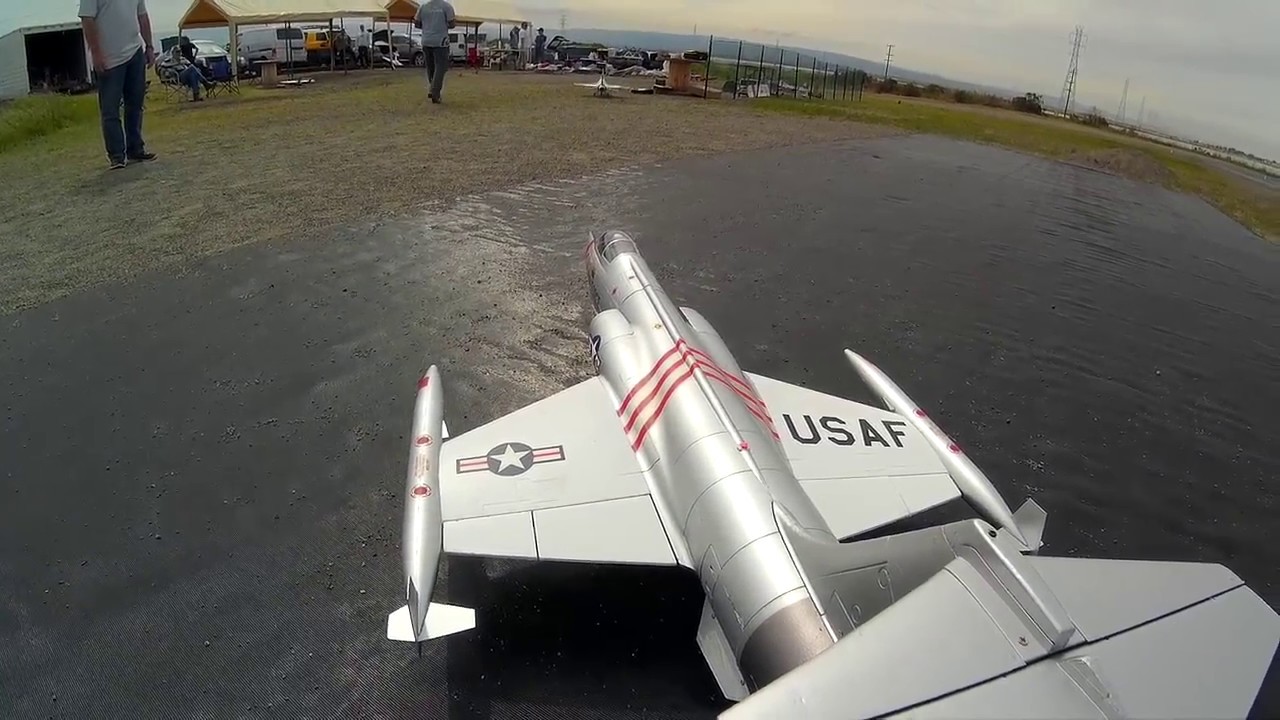

                  Thanks for the comments guys. Much appreciated. Here's one more flight.

                    Lots of F-104 flights at Apollo over the weekend. I am getting more and more used to the way she flies and really like it!

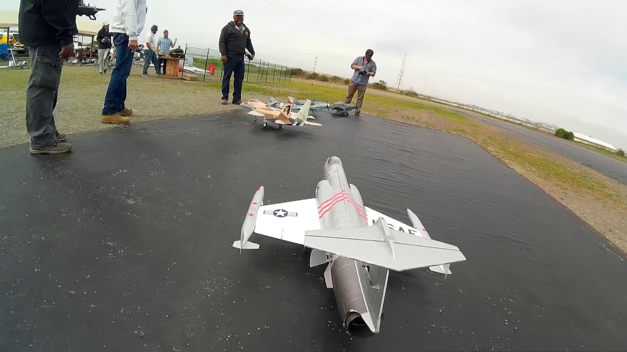

                                        Morning flight. Thinking about installing my shelved inrunner since my batteries are usually jammed into the back of the cockpit. With my heavy handed throttle management my batteries may suffer though.

                                          Second morning flight with F-104
