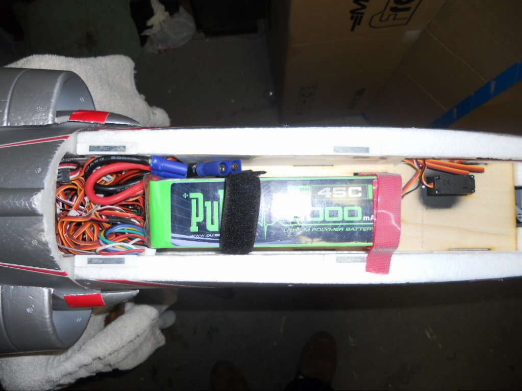

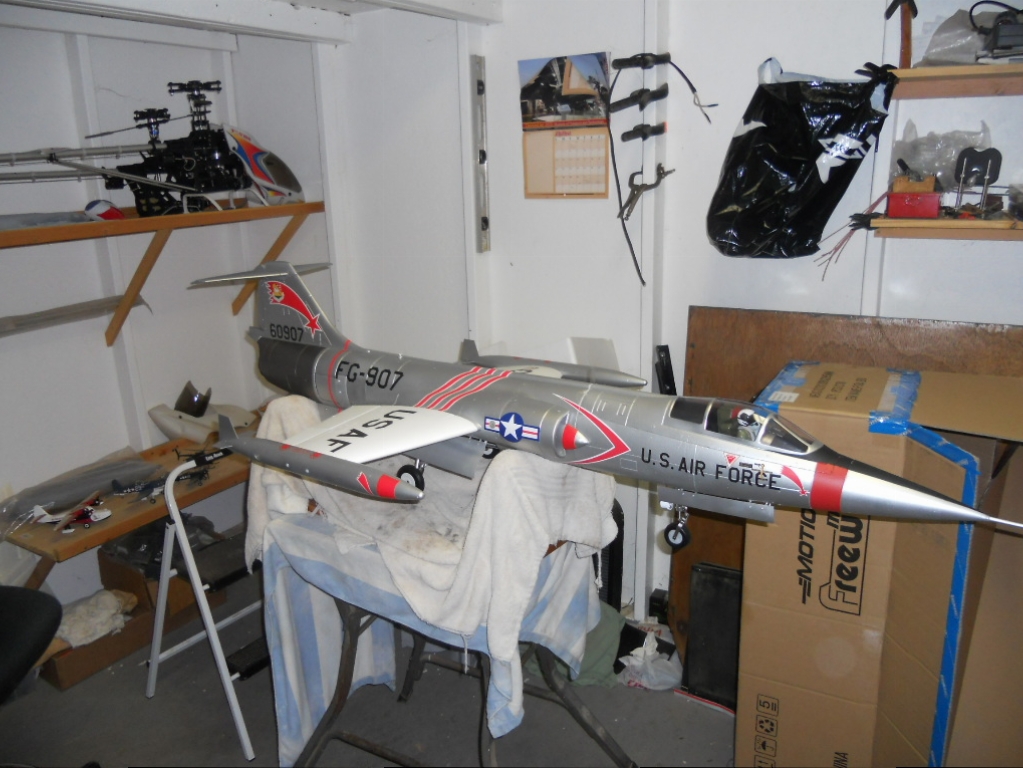

        Thanks for the info, and I don't need to move my controller board back at all, my batteries are just in front of the controller board to get the CG in a safe range. I'm using Pulse 5000 45c lipos and the new blue Gens ace 5000 60c , the Gens 60C are actually smaller and lighter than the Pulse 45C, don't know why that is but they are, so I have to remember to move them up front more on all my EDF jets. Here is my Pulse battery placement, elevator reinforcement, and decals applied for the fourth flight.
