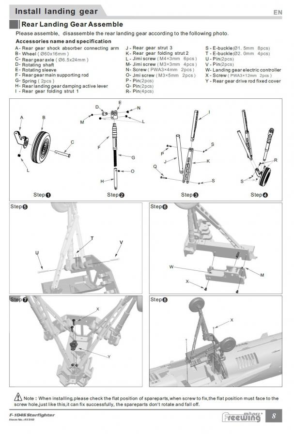

                                  I just purchased the starfighter and it should be at my front door in two days or so, i'm excited for the challenge. I have a question about electric wheel brakes should I consider putting jp hobby electronic wheel brakes on the 104? My field in Sarasota Florida is 500ft long. What are the main wheels diameter and as well as axle? Thanks guys.

                                      #258
                                      500ft should be fine without brakes but it'll use most of it. Most times I could get mine stopped in about 300ft without wheel brakes if everything worked out just right.
                                      Go to Motionrc F-104, "Support" tab, and download the manual for parts descriptions..
                                      Here's the page you want..
