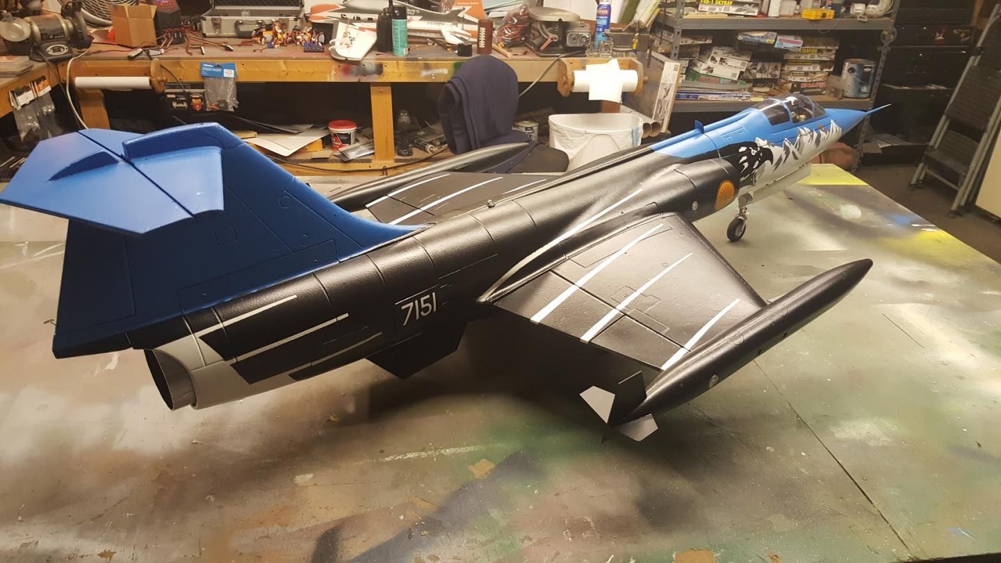

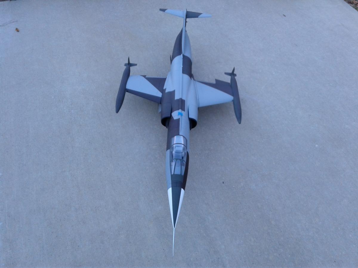

Probably going with 1/10. Currently trying to decide if I am going to do USAF SEA camo (Snoopy) or a JG31 Boelcke bird.

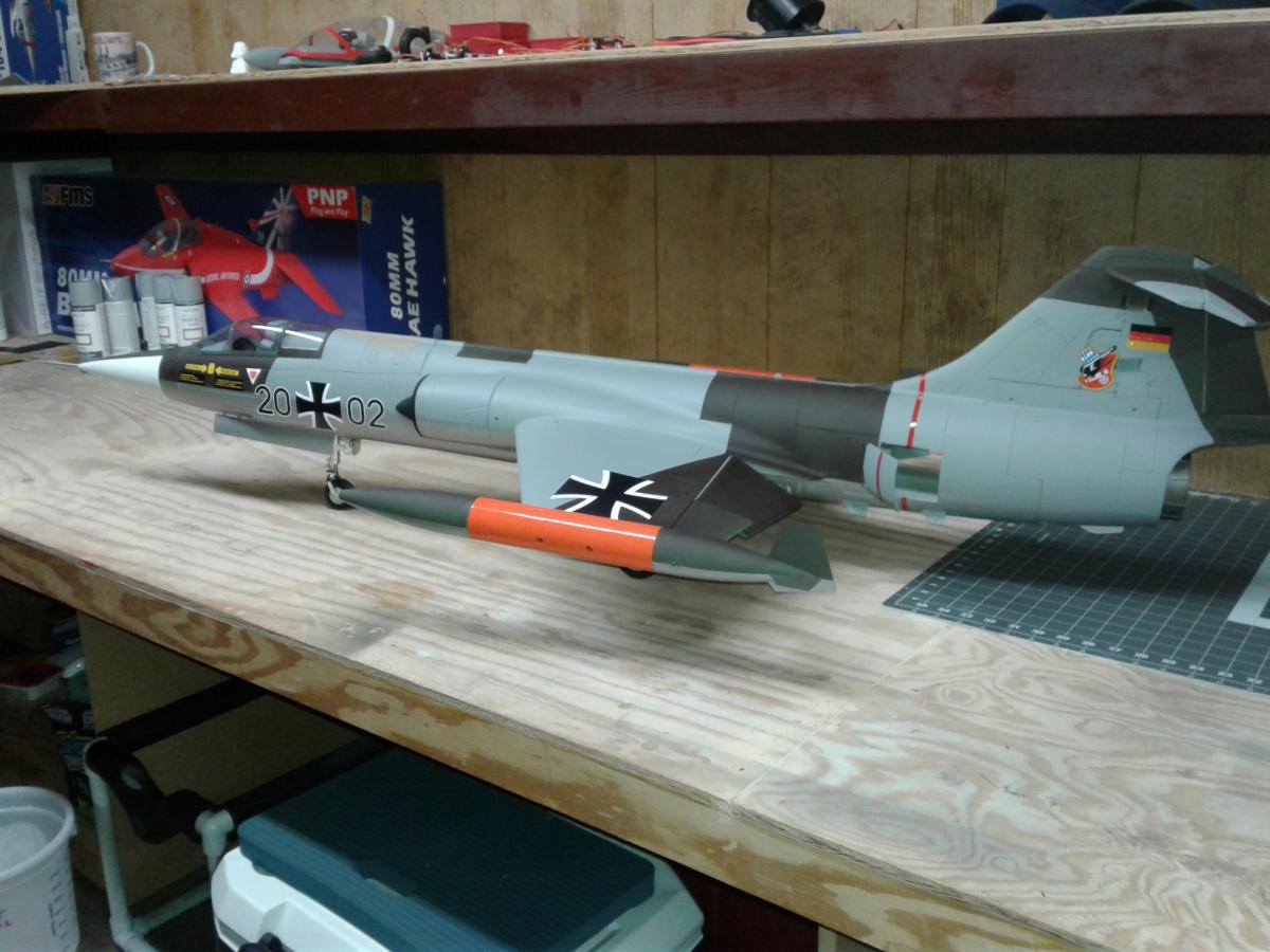

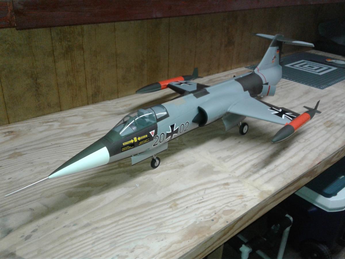

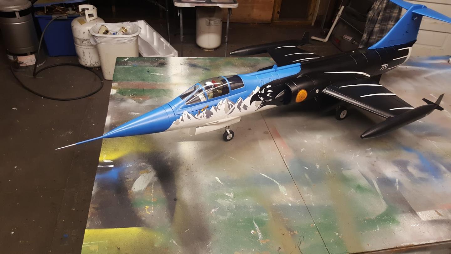

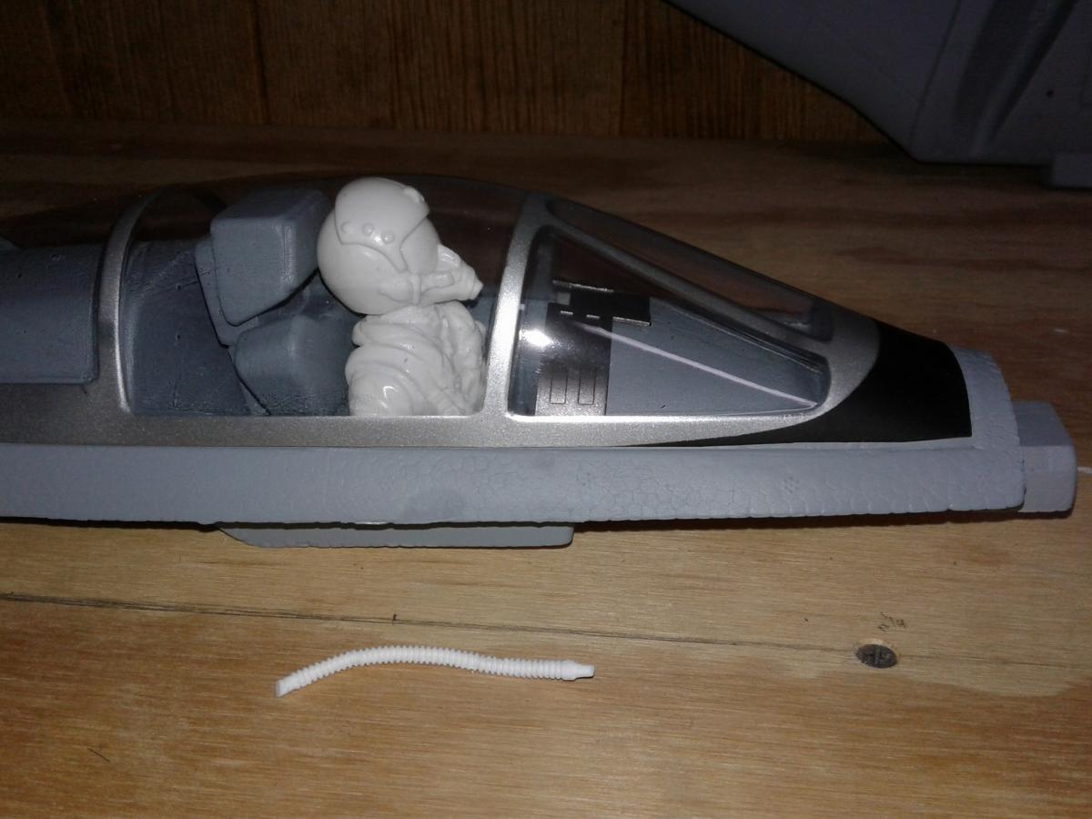

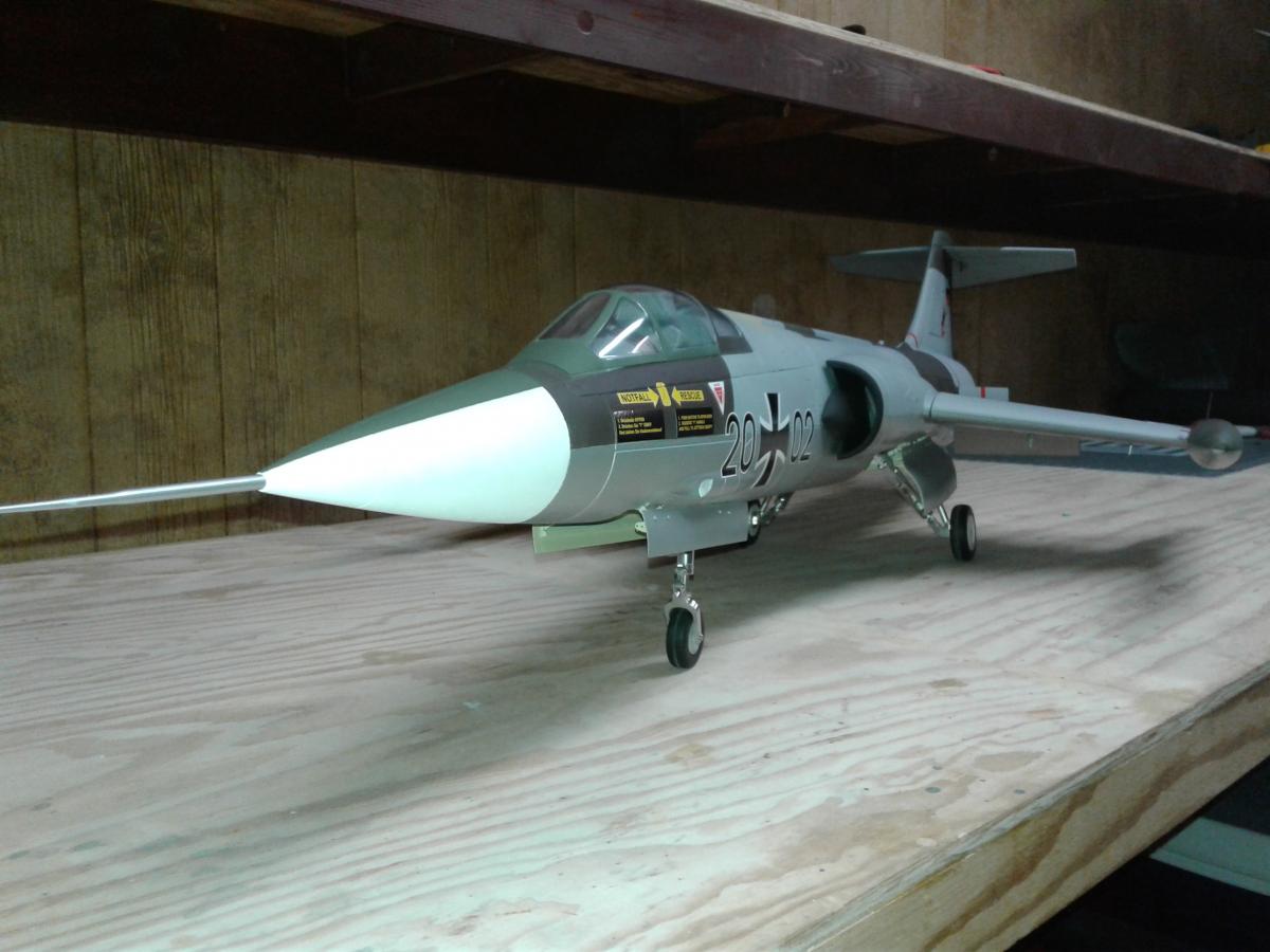

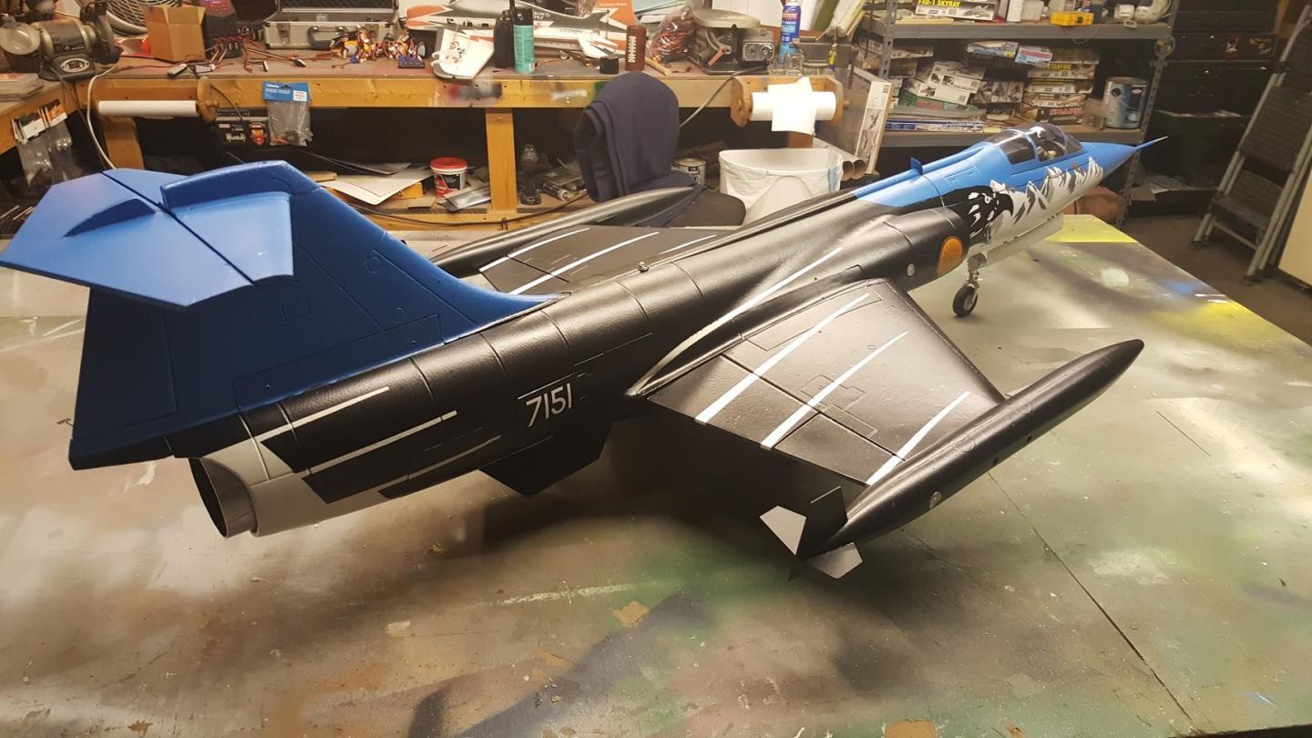

Well I decided to do up this paint scheme. It's a JaboG 32 bird. Looks like an easy mask job. Ordered a Castle 5 pilot from JHH for the cockpit.

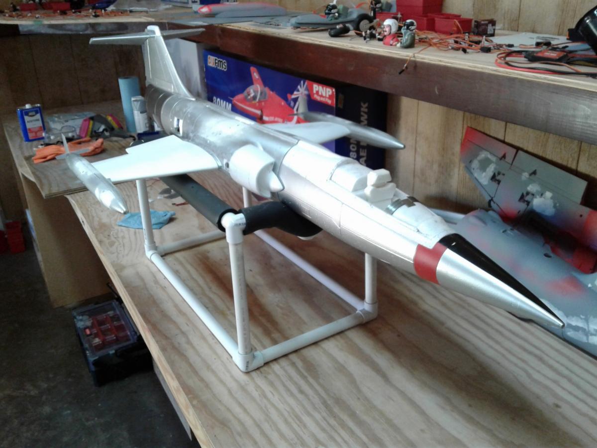

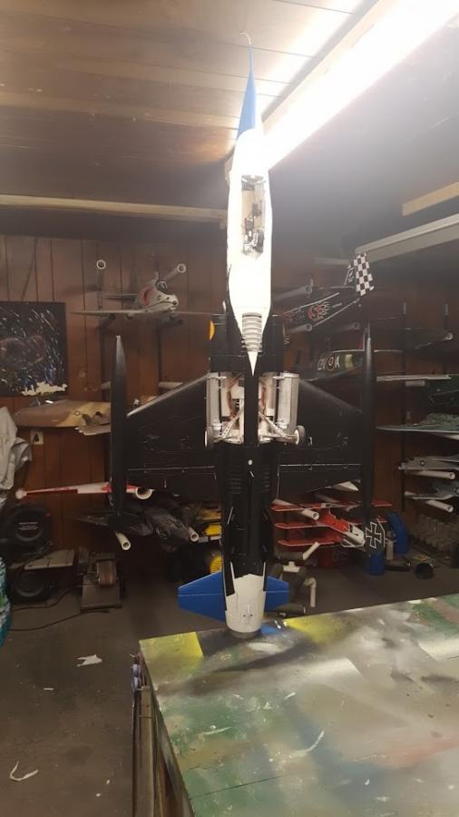

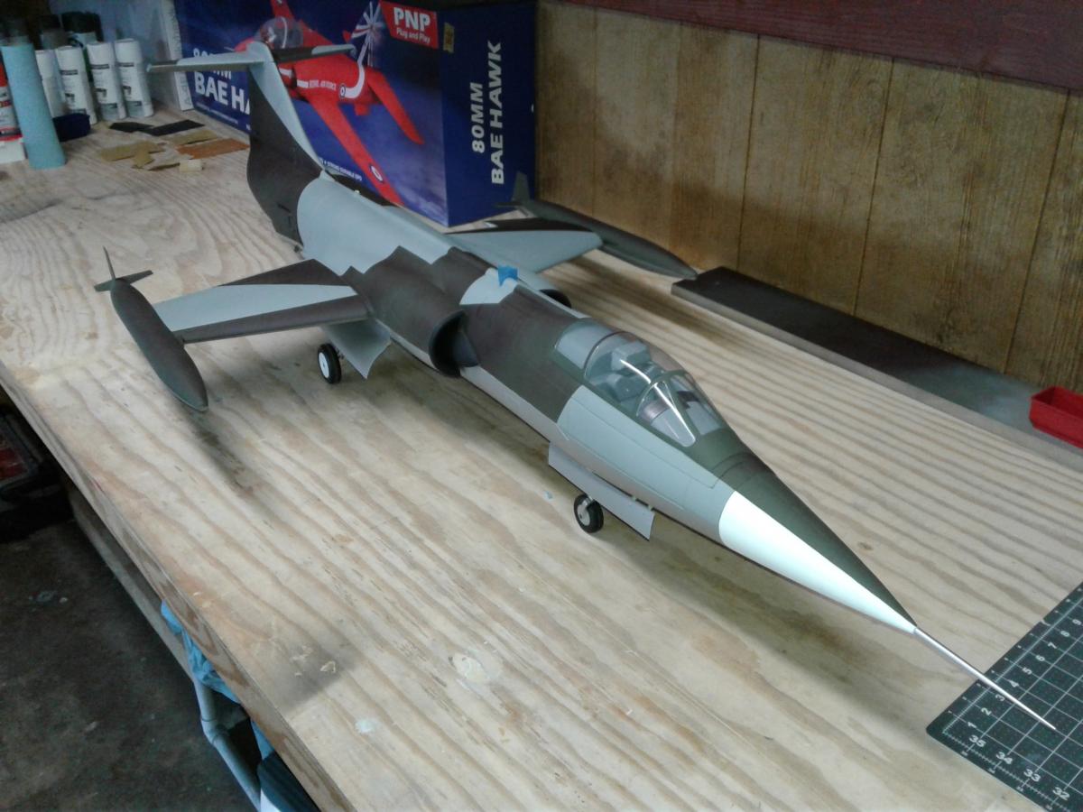

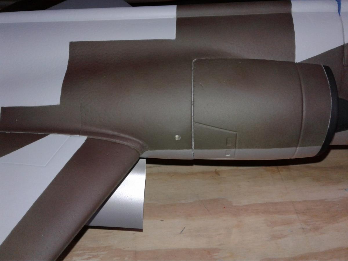

Currently I am in prime-sand-prime-sand mode.....dirty job but necessary. Hope to have the Widowmaker in the air soon. Graphics on order from Callie. Pilot on order from JHH.

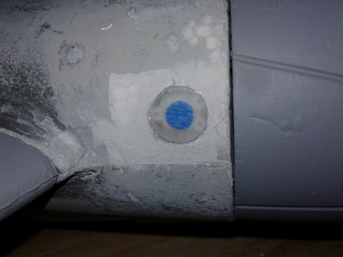

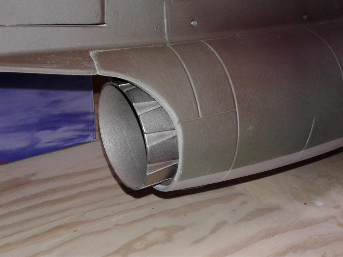

My fuselage nav lights were so messed up with glue that I could not clean them. Nor could I find any replacement lenses without buying the whole fuselage which is, in my mind, a bit over-priced for what you get. So I am going to blend them in to the fuselage and paint over them !@#$. I don't plan on flying without the tanks anyway.
If anyone knows where I can get those lenses I still have time to put them and the nav lights back in before the paint goes on.
Also, I want to make the nav lights steady.

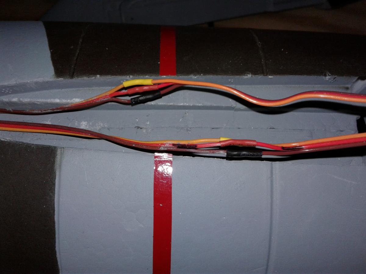

Well I checked mine as best I could. I have my intakes removed for painting. I tried putting force on the fuselage from the top and below with no signs of bending or weakness there.
I suppose I could run a couple rods through that area. Any thoughts on that?Meridian Aeromodelers, Meridian MS

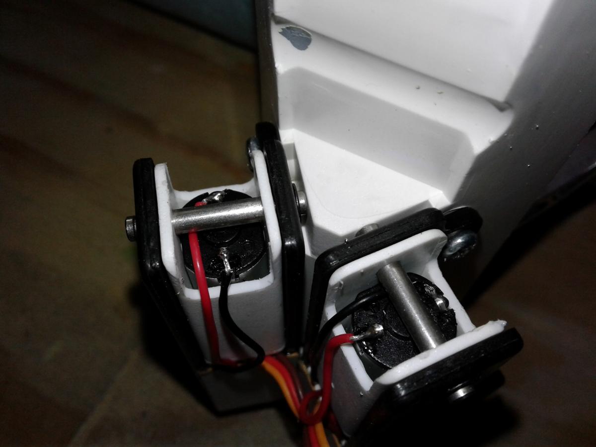

I have 2 spare 104's beside the broken one I linked. All will get carbon rod reinforcement. I was really lucky the jet linked above didn't break in half during flight with just the two dots of glue holding it together.

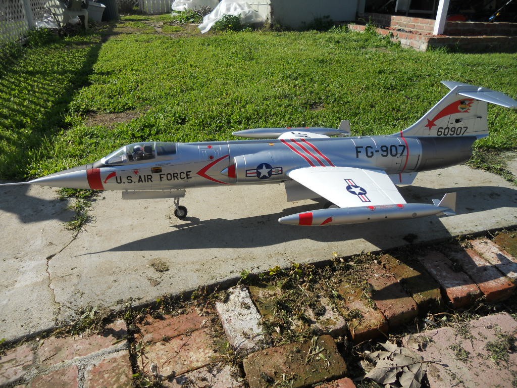

You will absolutely want to beef up the elevator horn. I lost the 104 seen in the attached photo because the horn pulled out. Aileron horns are same weakness. The horn configuration is very sketchy for such a high performance jet. I nearly feel like a beta tester ..... sigh...............2 Photos
Thanks GPJ. I will pay special attention to those areas. I will see if I can beef up that elevator. By the way, very nice paint job sir! Are those spare ones in the box? Do you want to sell one?

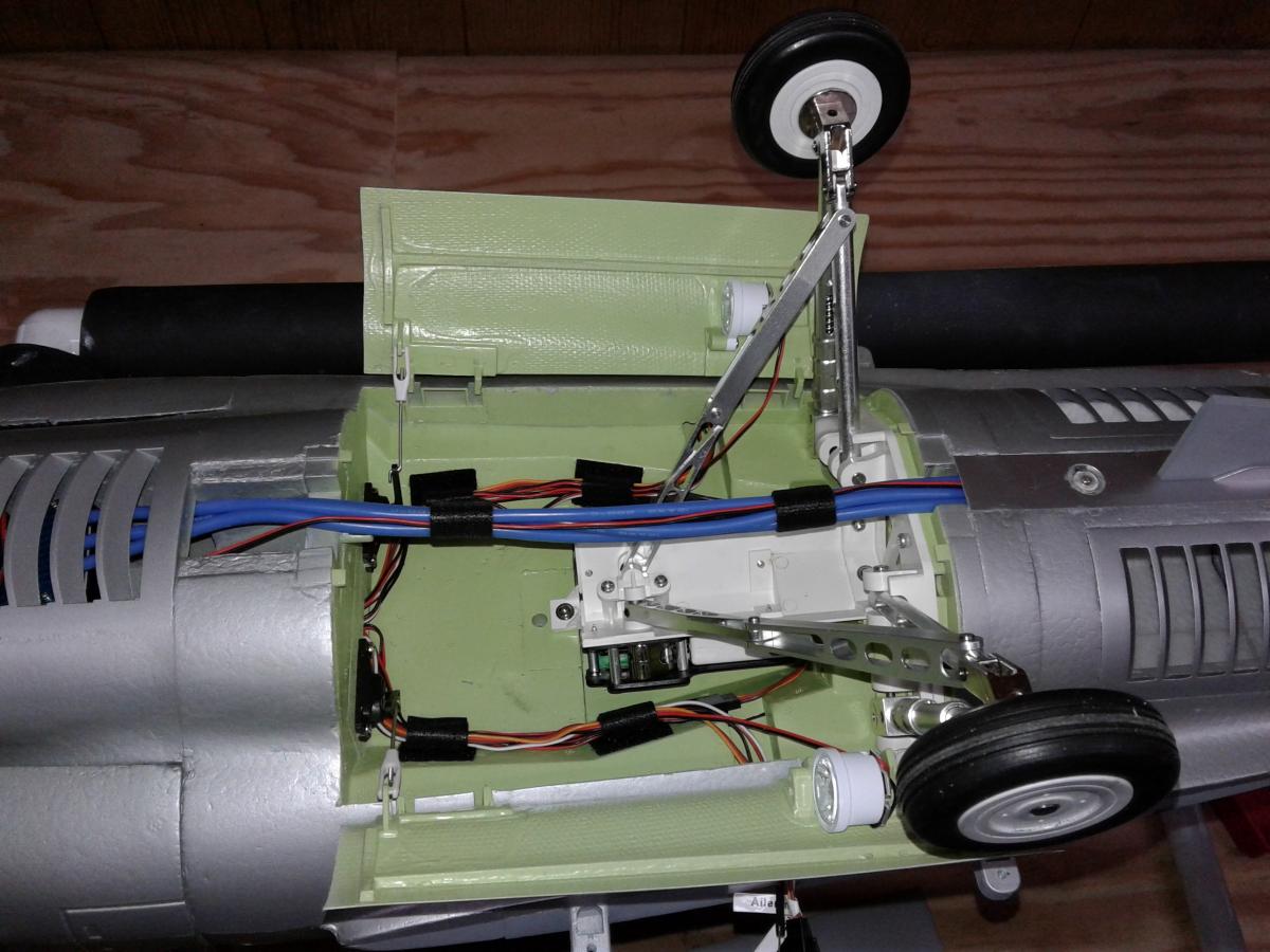

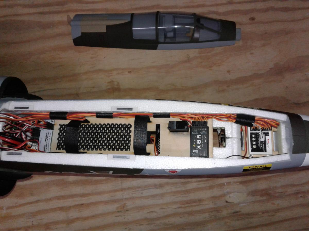

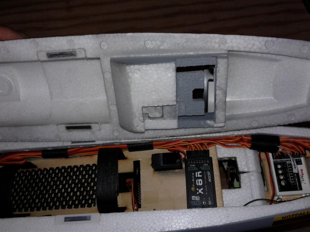

Tested all the flight controls, lights, and gear last night. I confirmed that the included gyro does in fact work great with the Frsky X8R receiver! So all systems go.

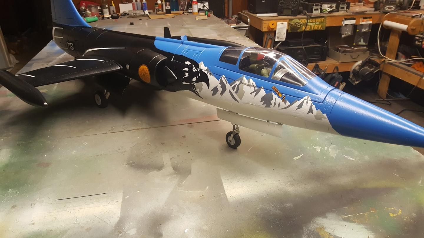

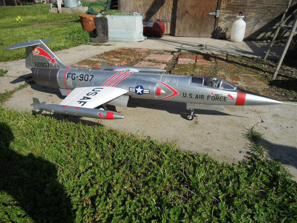

Hi Seaviper,
I have many Freewing jets and agree for the most part they are very good. The spares I have are future jets in case of mishaps along the way. I really rank the 104 as one of my all time favorite jet aircraft. Motion is still selling the PNP 104 at reduced price:
Freewing F-104 Starfighter Silver High Performance 90mm EDF Jet - PNP - FJ31013P Version Info: This is the High Performance which includes a powerful 3672-1900Kv inrunner motor with new 9-blade fan. Following up on their popular 70mm variant, Freewing has answered the many customer calls to scale up their F-104 Starfig
I checked out the controls horns and all are very strong. Maybe they addressed the issues at some point in the production. I don't know. But this one seems to be very strong.

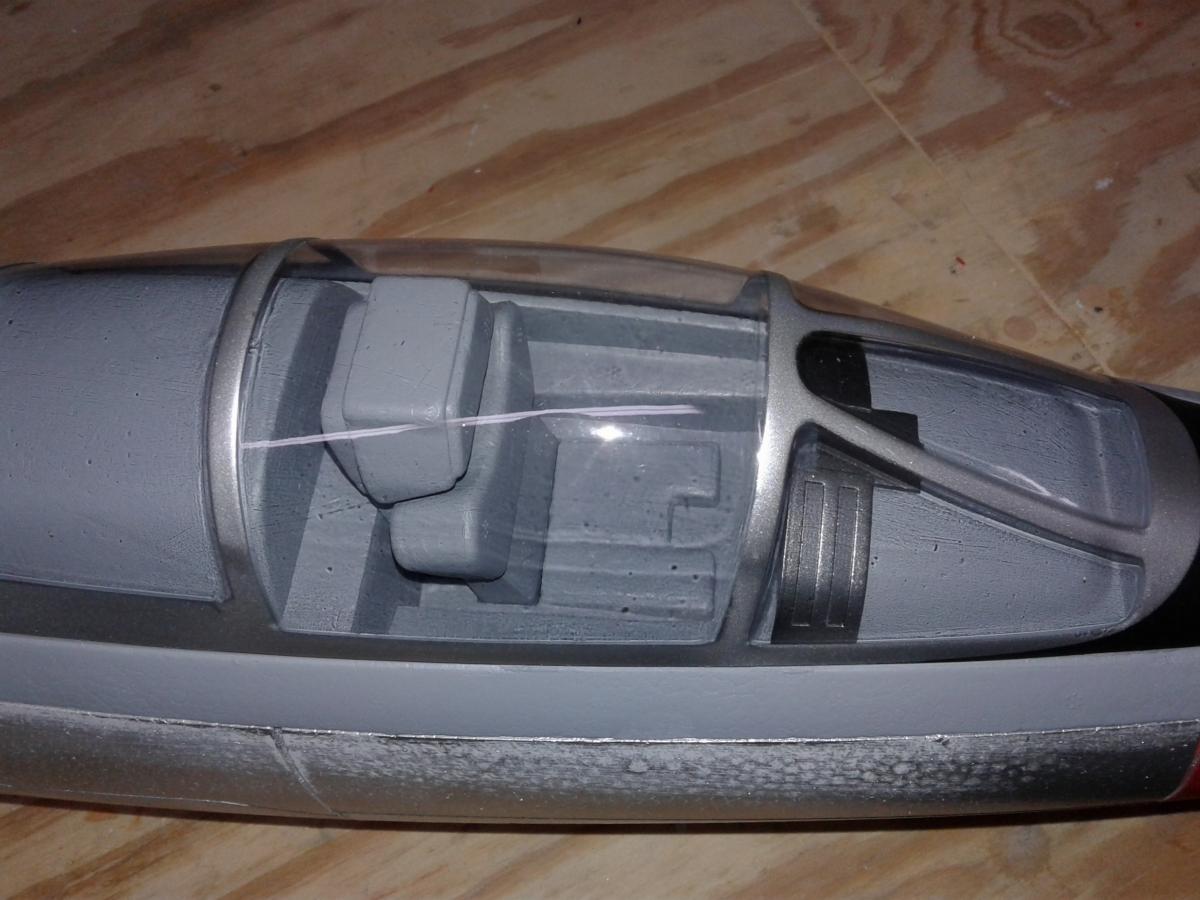

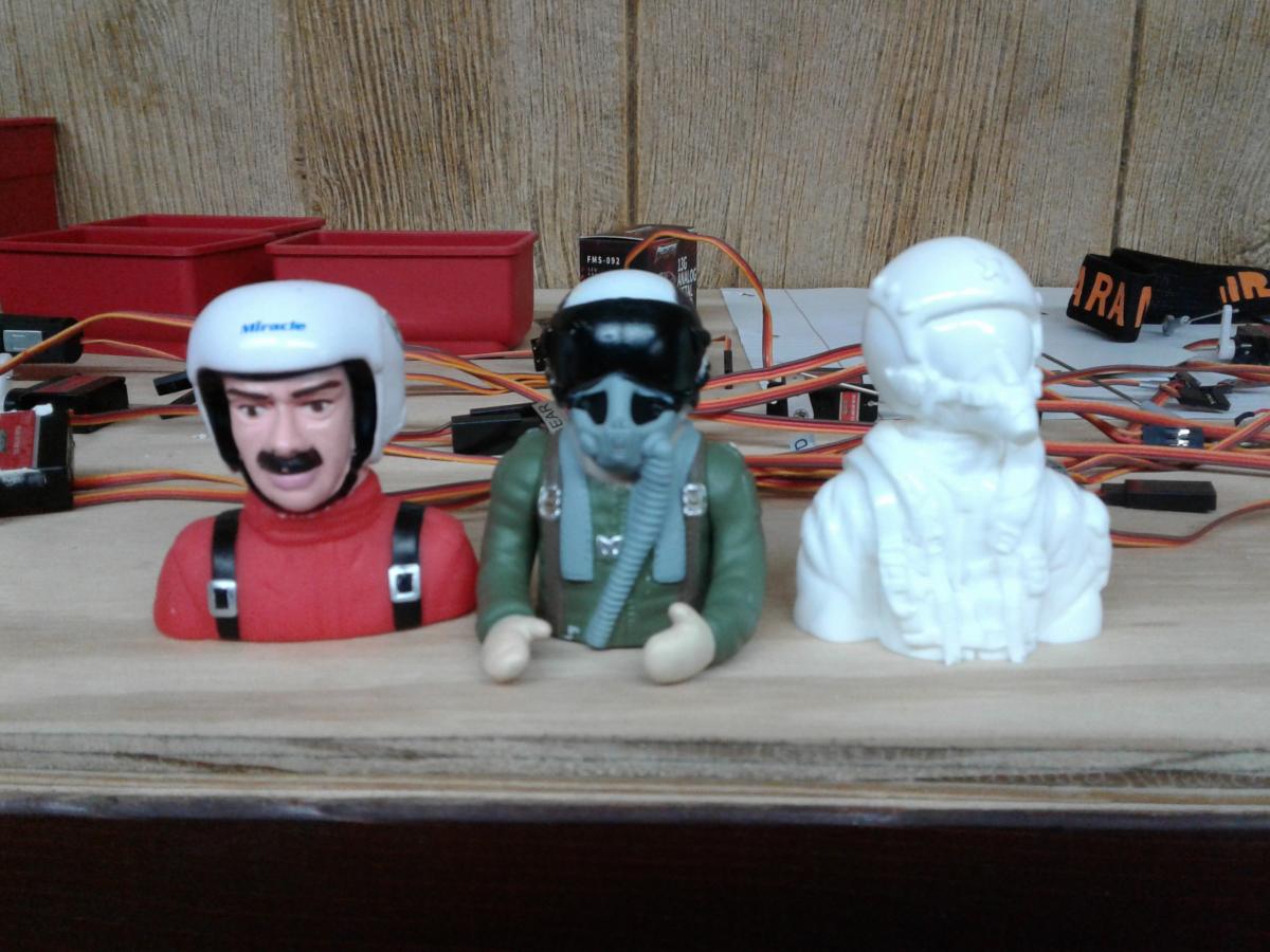

Comparing some pilots. From left to right, FMS 80mm Hawk driver, Freewing 1/10 104 pilot (with mittens no less), JHH Castle 5 1/10 scale
Just a little trimming and this guy will be perfect!

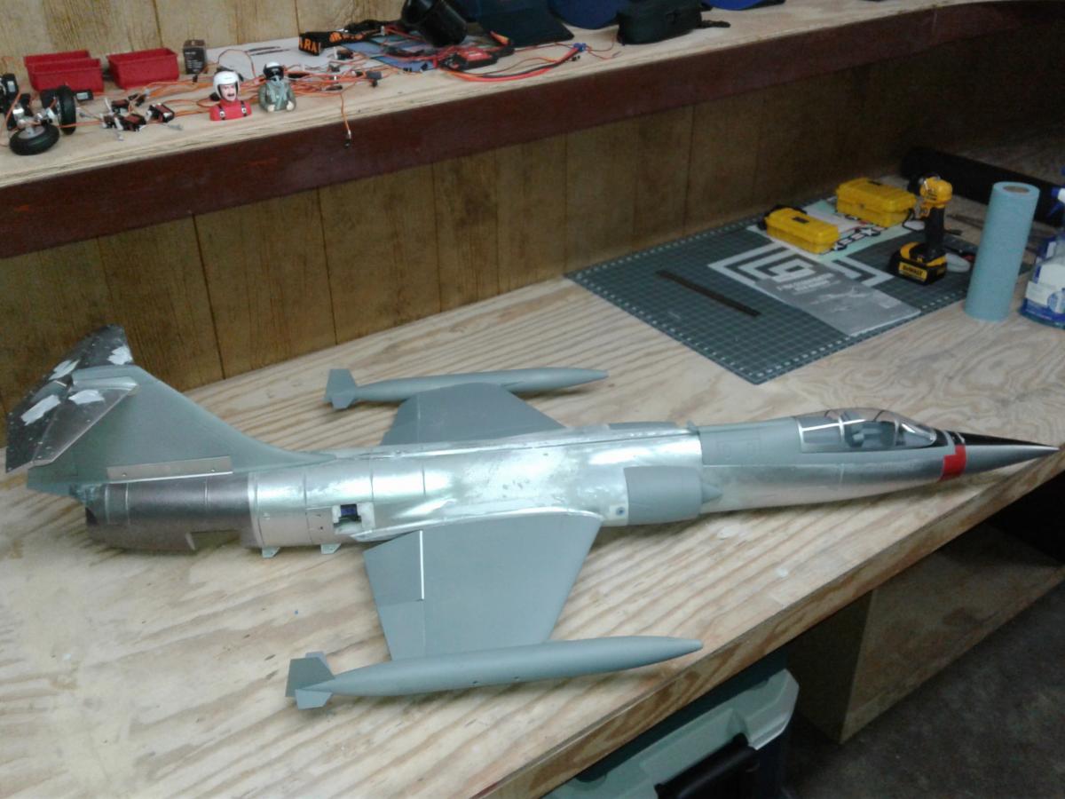

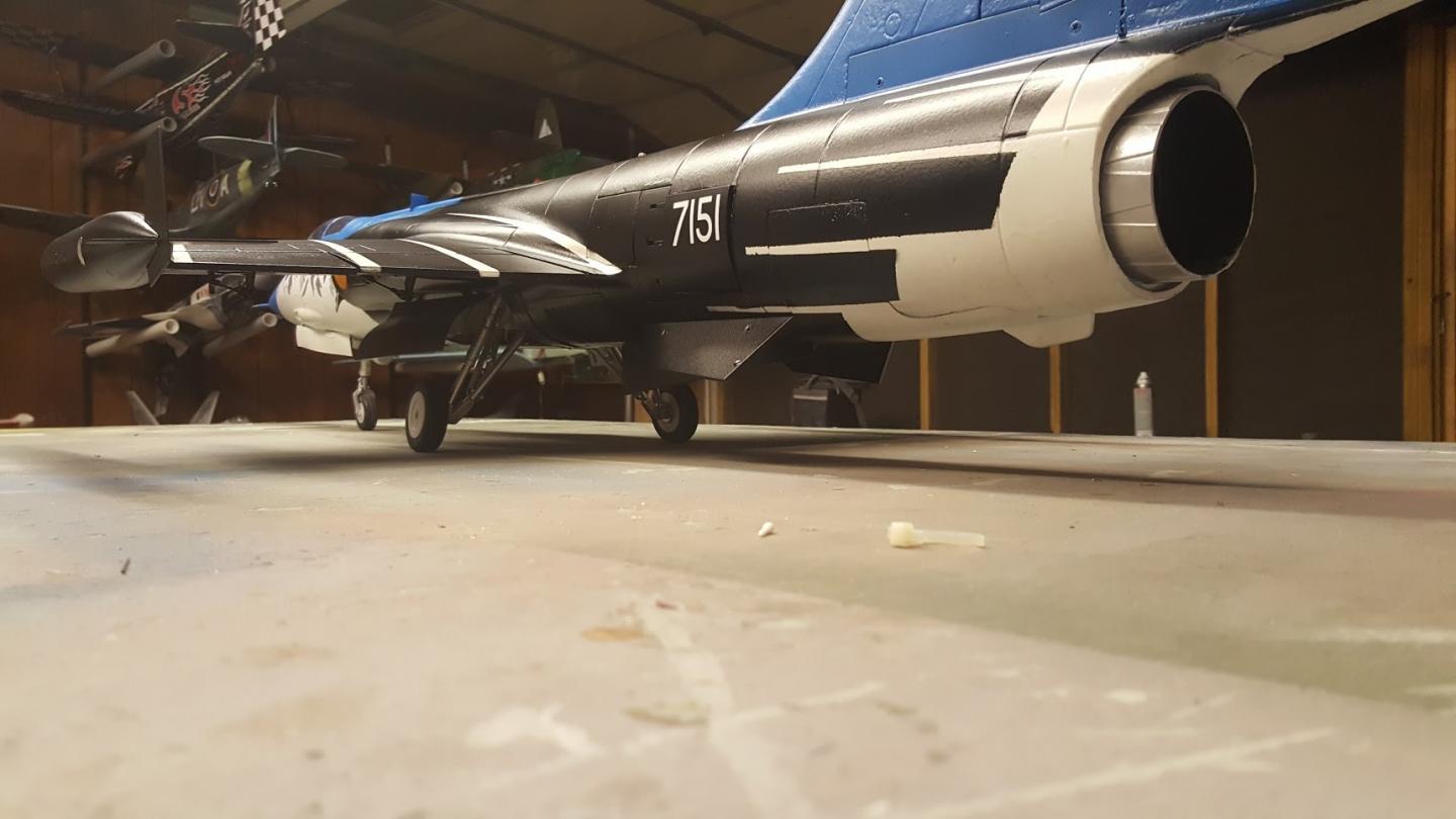

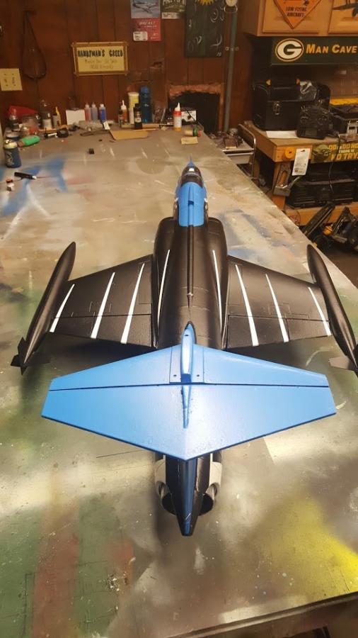

Finally finished up the painting today. The revised graphics from Callie should be in soon. I will test fly her in the next few days if the weather will cooperate with me.
I removed the "afterburner" when I had the tail cone off for painting. That should help a little in the weight and balance department.
I will post the helmet cam when she gets airborne. Should be soon. I still have to put all the spaghetti back inside. Honestly I cannot wait to fly her.
For the first flight I plan to run the gyro at very low settings and work it up from there. I have a gyro on/off witch set up as well.
Any helpful comments before the first flight would be appreciated.Meridian Aeromodelers, Meridian MS
