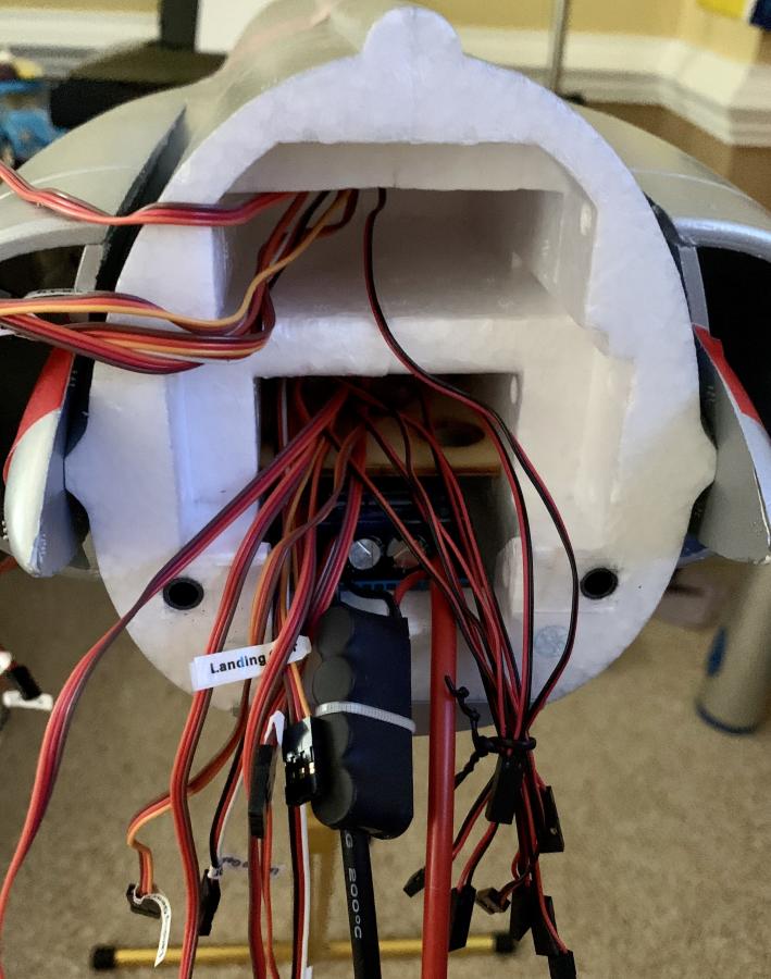

That's where mine ended up. I took out the stock gyro and installed an Eagle A3 next to the nose wheel steering servo because it wouldn't fit all the way up front. The plane balances this way with the battery as far forward as it will go. I would try to leave some space around the circuit board I noticed mine was fairly warm after bench testing the plane for a few minutes. And make sure you don't touch the circuit board with any stray metal objects like a screwdriver it could easily short out. I made a paper cover for my board.Comment
I took out the gyro as well since I will be using 9 channel AS3X. I'll bypass the board as much as I can.

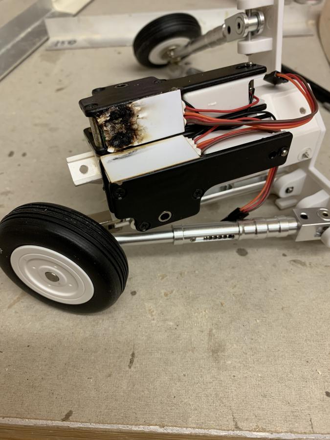

Setting up my new F-104, lowered the gear for the first time. Gear lowered like it should, no funny sounds or binding. Out came the magic smoke. Melted a small amount of foam inside the fuse, no big deal and didn’t impact the exterior foam. Only $15 bucks for the replacement.
Now if I could just figure out how to straighten out all of those wires in the fuse. 😀Comment
