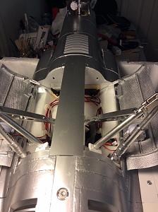

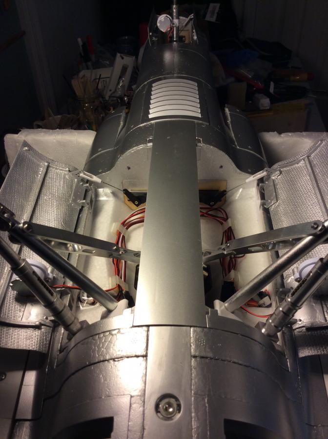

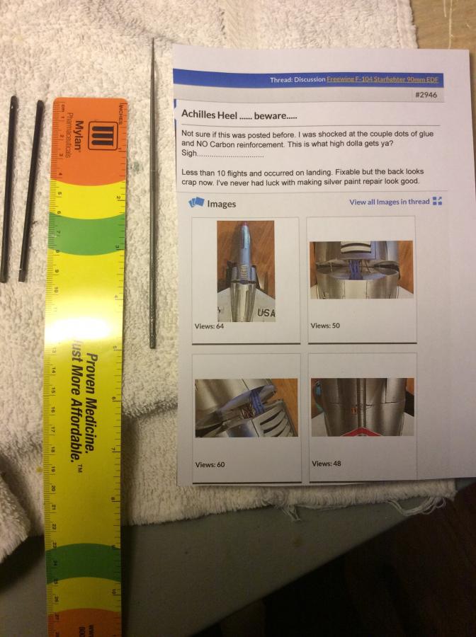

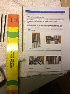

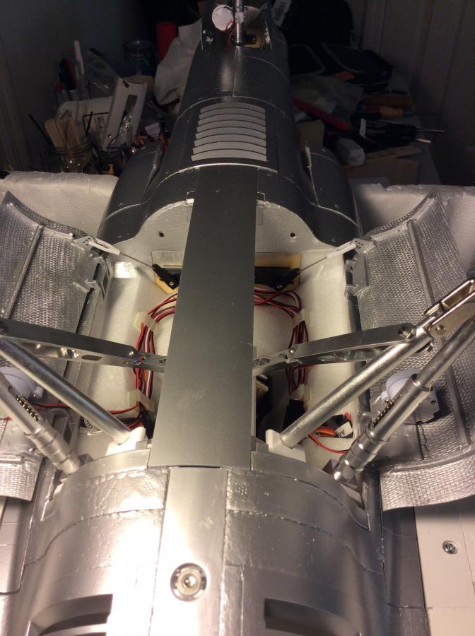

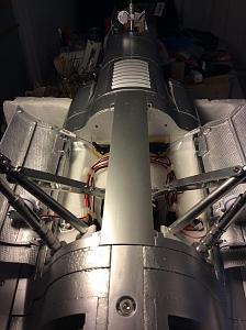

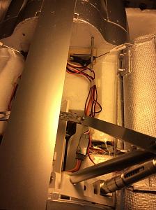

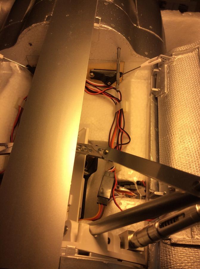

ID:	107118 Reinforcement of fuselage just aft of ventral intake grate. See GPJ’s note on page 2. Potential for fuselage break.
              1. Locate site for carbon rods placement. GPJ’s photos reveal best sites. See my photos on sites in the main gear bay.
              2. Carbon rods need to be 9 to 10 cm long. They will be pushed forward into the foam.
              3. I used a needle file to drill the canals. See photo with file at site.
              4. I epoxied the carbon rods in place. Put a paper towel just below the rods as you push them in. The glue can run down on the servos below. Last photo shows rods in place.
              Bill
              • Already doing that to my 104 Bill. Just ordered my carbon rods.
