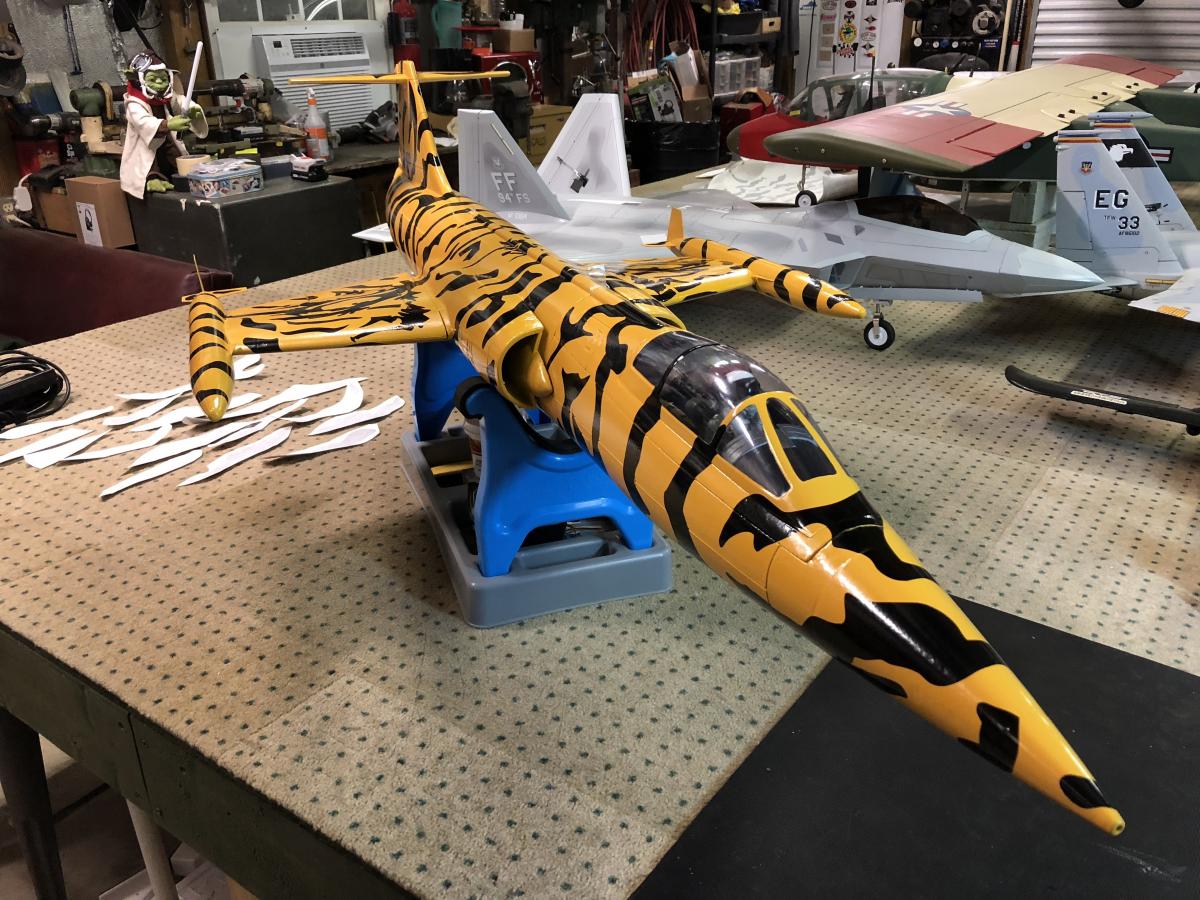

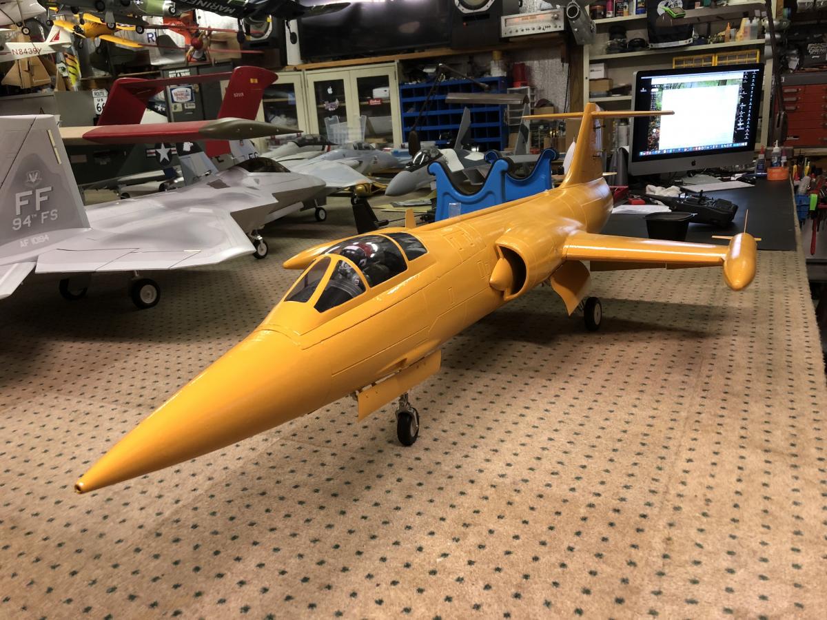

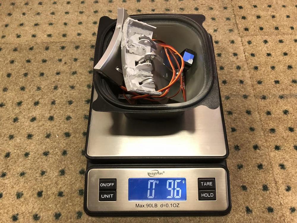

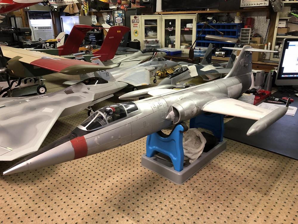

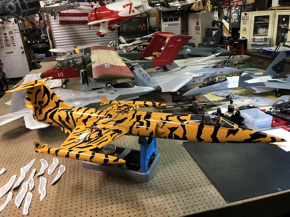

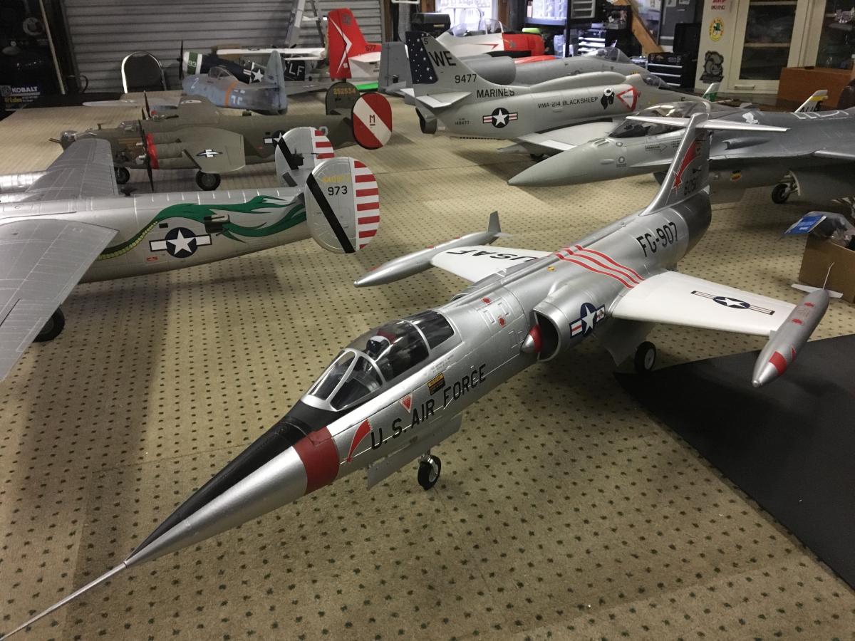

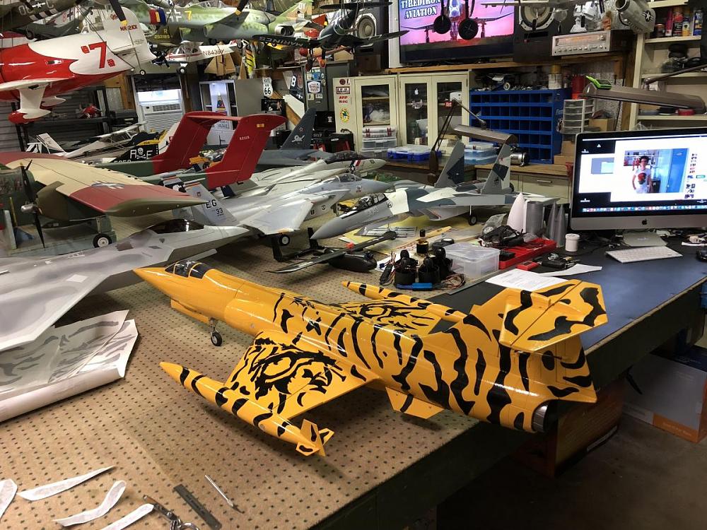

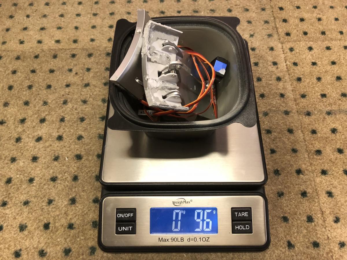

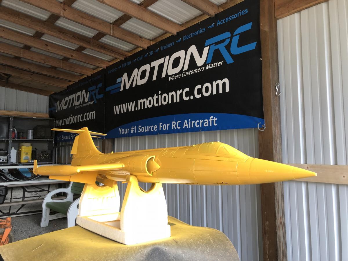

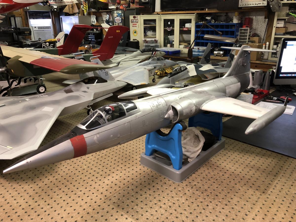

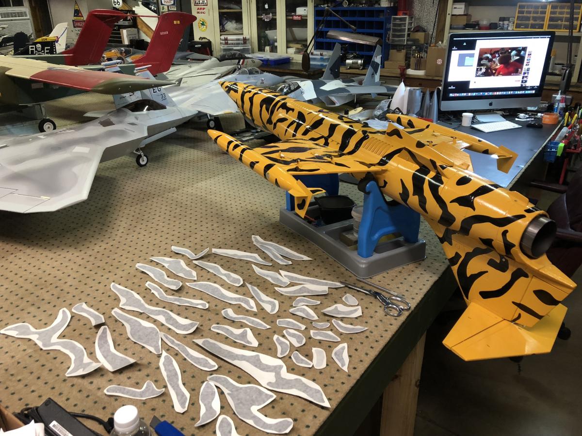

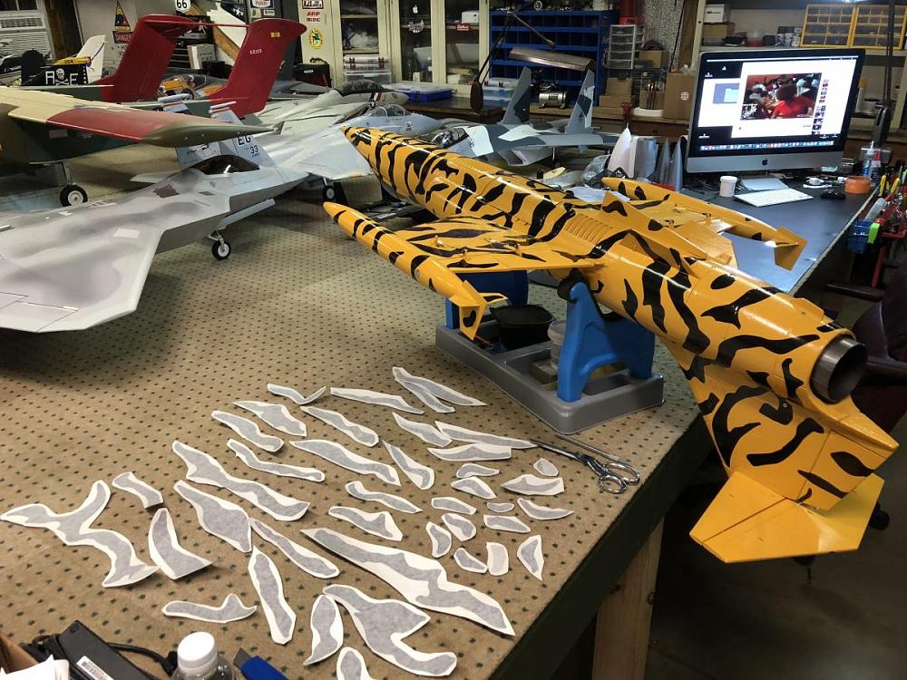

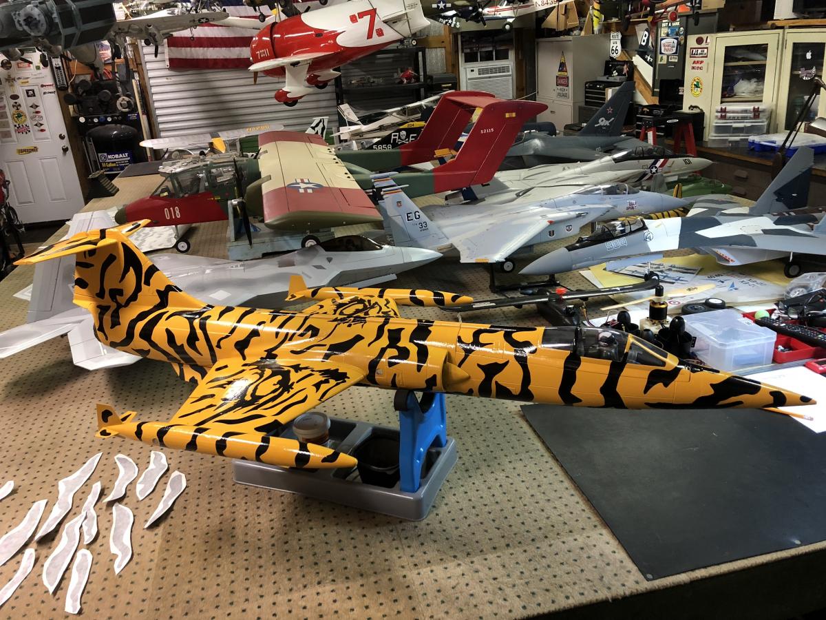

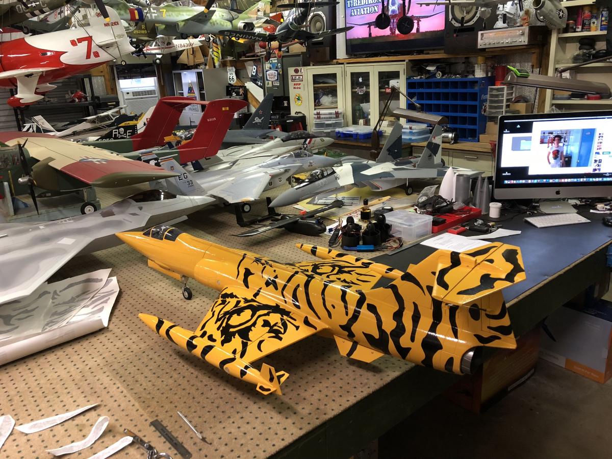

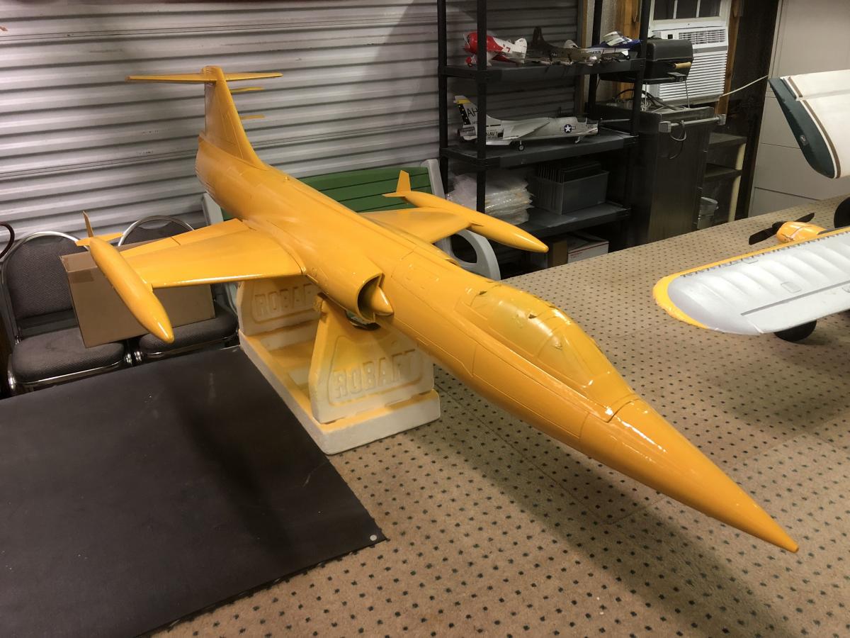

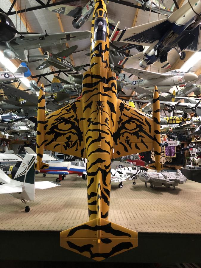

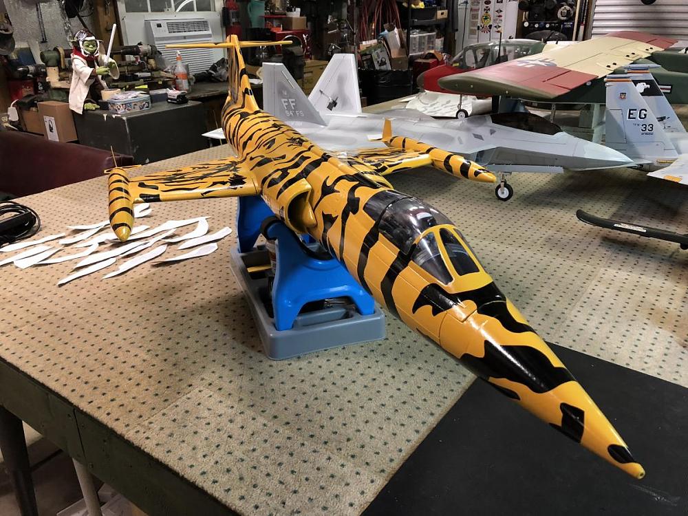

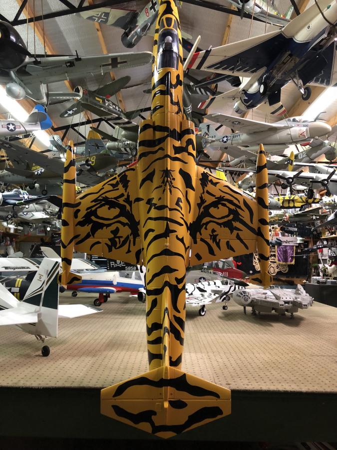

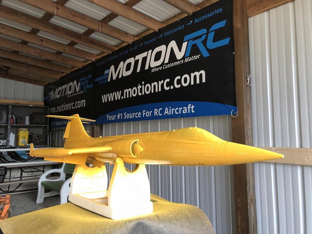

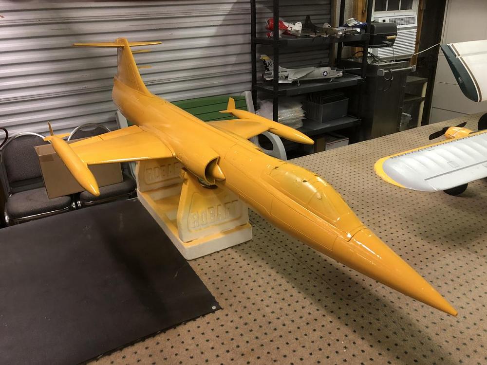

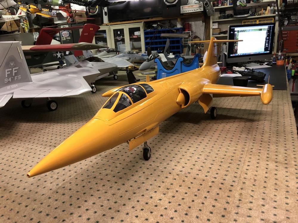

          I got this a while back and just never really did anything with it so while the weather is bad I decided to spruce it up a little by removing some dead weight and putting a 6S F-4 9 blade setup in it...oh and some paint and Callie graphics:Cool:

            TI, that looks super cool. This jet is now on my short list. Have you flown it, or had any exposure to them?
              I use the airbrakes in mine!!! They have saves my hieny many times! Plane does look amazing though! Any flight footage yet?
                #207
                Now yet, waiting on weather and camera man ;)

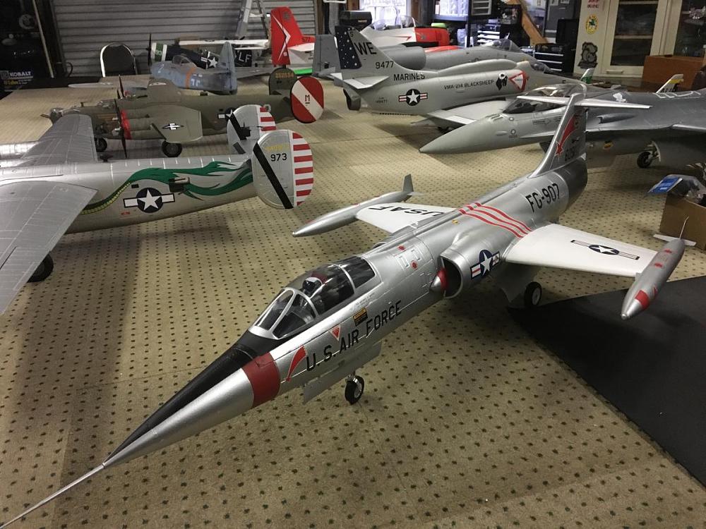

                    I flew it again on Monday... CG is about 3/4 of an inch ahead of the forward wing mounting screw which is more towards the middle of the CG range which is actually where the CG mark should be made. If you look on page 14 of the manual you see how they show a CG range. I hate it when most of the time they say that the rear of the range is the CG when it really is not. The plane is borderline unflyable at that mark. Yes it can be done but there is no margin for error at all and you can not flare when you come in to land! It ends up doing the death bounce and killing itself. So now I fly ahead of the screw and the plane is oh so much more fun to fly! Especially when landing!! I don't encourage flaring this model since it really doesn't like it... but when you have the CG at this point, once the wheels touch down you can hold full up and deploy the speed brakes without worrying about it lifting off again. I have even hit the brakes when it was still in the air to get it to come down sooner and it didn't have any ill effects on the way it was flying aside from making it sink. With the recommended CG the brakes make the plane pitch up.

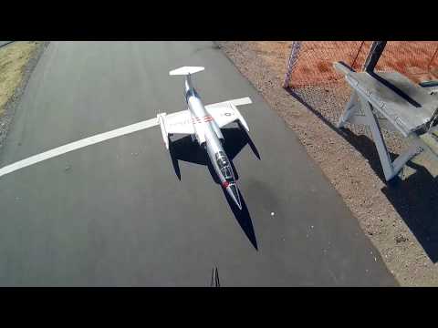

                    Here are my flights from monday and yes I used the brakes on these flights too

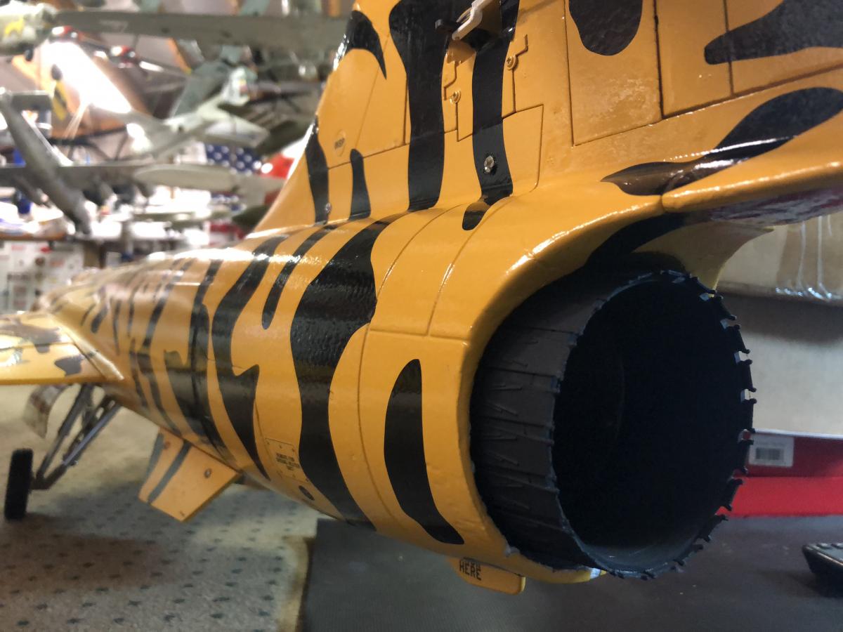

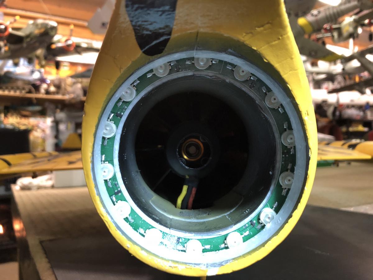

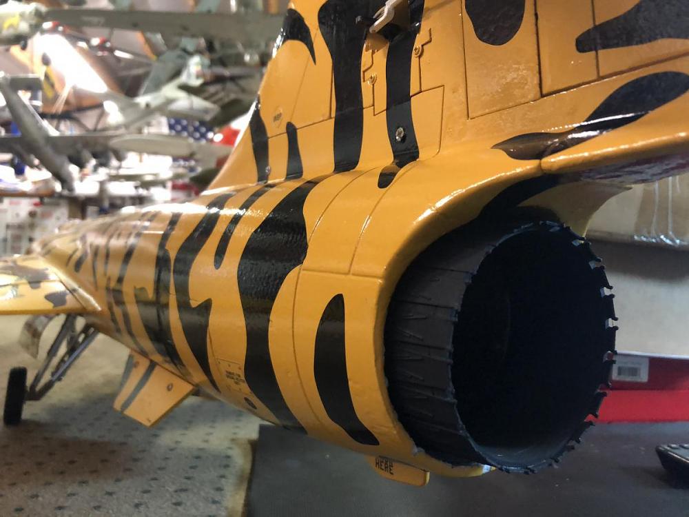

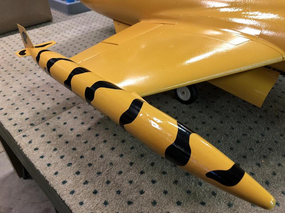

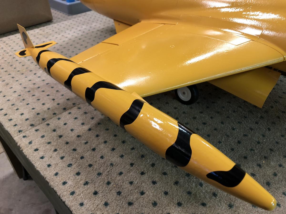

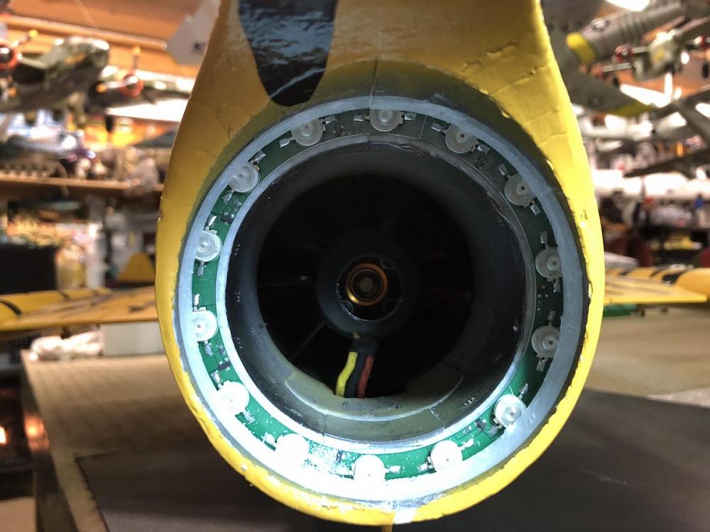

                                I scaled up a 70mm F-104 to replace the stock one on my 90mm TM ;)
                                I removed the led ring and will use a RCGeek center afterburner.

                                  That looks really good!! I have my own unit that I will be adding to my FMS powered F-104. I may actually get started on it this weekend...
