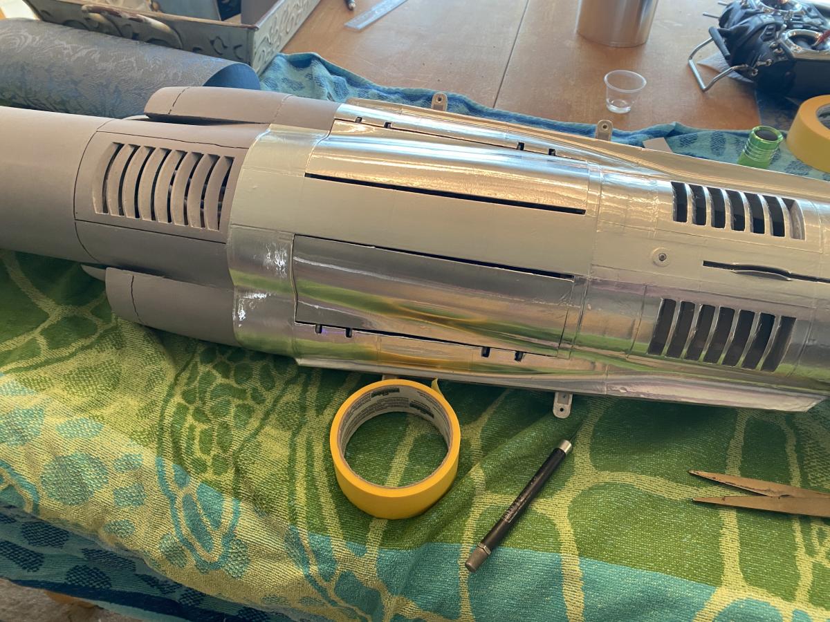

        I finally received my order of Flite Metal. I am hoping to have the metal finished up this weekend.

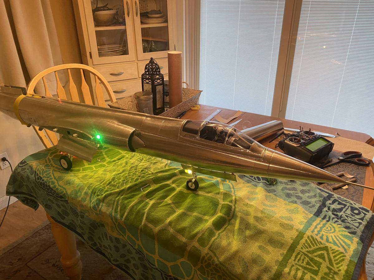

          I finished adding the flite metal to the fuselage. It’s far from perfect but should look good after polishing. Once I get it polished I can add the rivet details and mask for the trim colors.

            That’s going to look amazing on bright sunny day.

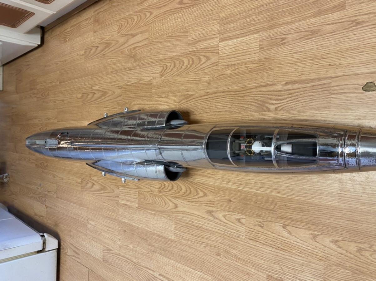

              The aluminum is now polished. Ready to start masking for the trim colors.

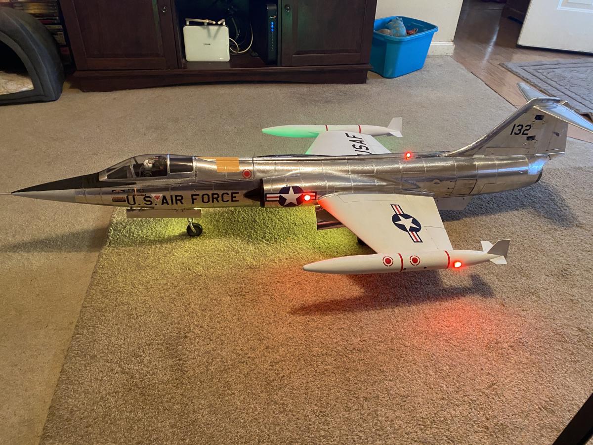

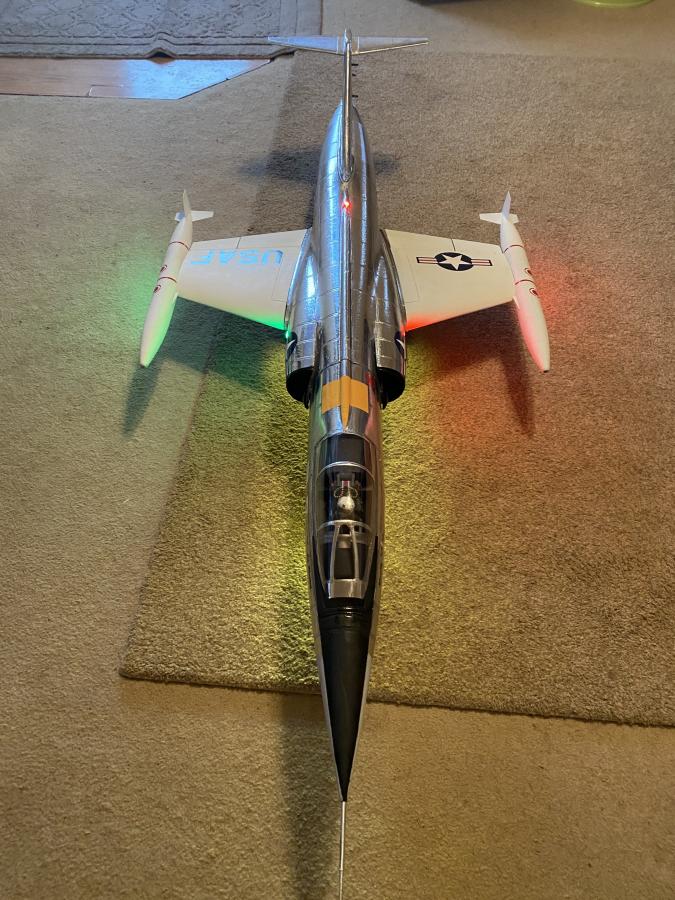

                    I finished up the F-104. Overall I am happy with it. I can’t wait for a sunny day to get it outside for some pictures. Maiden won’t happen until spring.

                      Wow is all I can say, looks amazing, its going to look awesome in the air, good luck on the maiden or should I say your first landing...........
                        • 5426
                        #371
                        Looks very good. I'd be concerned about the extra half pound...
                        Well done!
