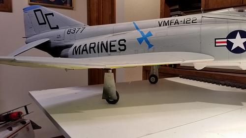

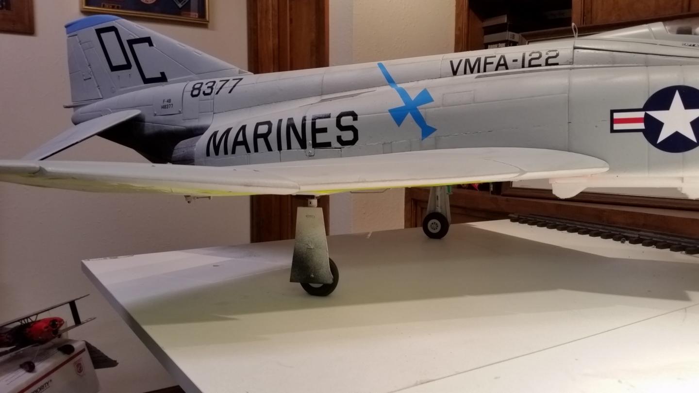

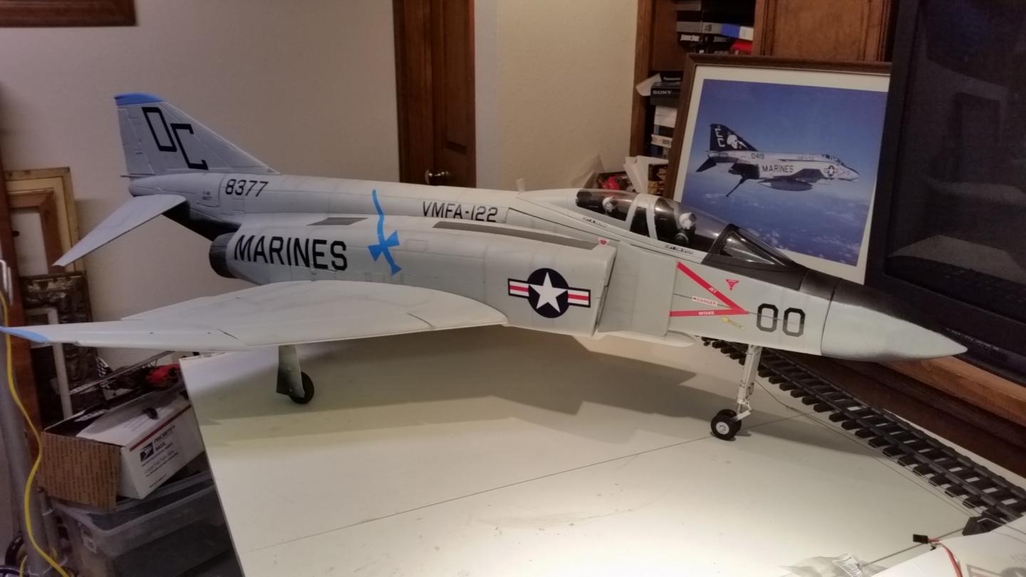

                        Try the new FMS 70mm, 80mm or 90mm EDFs. That, combined with Castle Creations ESCs will give you a noticeable power increase.
                        My LX (stands for junk) F-4 with twin FMS 70mm, 12B EDFs and 130A CC ESCs will really get up and go. I had a fan come off one of the EDFs during the takeoff and the plane got airborne without any trouble and flew well - try doing that with some other EDFs. My LX F-4 is highly modified with FW SU-35 landing gear (with gear doors), outboard leaders fixed slightly out, a Eagle Super II gyro, Callie graphics running 6,200mah, 6S, 30C batteries. The CG is at 165mm - this model is very CG sensitive. I use 1/2 flaps with gyro stability ON for takeoff and land at full flaps.
                        Now, only if FMS or FW would build a quality, well-flying F-4 in several liveries - I'll be in line buying them all day long. There will never be another mean looking fighter like the F-4. Look at the new fighters - they all look like radar deflectors. Amen Click image for larger version
