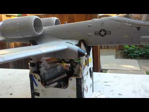

    it isn't all that hard. Pretty simple in face since the actual retracts just drop right in. The only thing that you need to change are the mains. They need to be rotated and go in backwards. it sounds funny at first but actually works really well. Make a flat spot for the set screw and they are done. Minimal widening and foam removal needed to make them fit in the nacelles on the wing. The nose gear does require a little opening for the nose wheel but super quick with a dremel tool. Here is a video of them finished product.

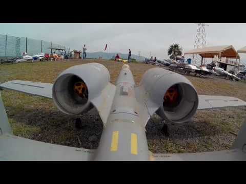

    saw your static vids in the other thread..those engines do sound good...which ones were they?
    Here you go
