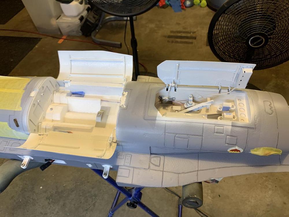

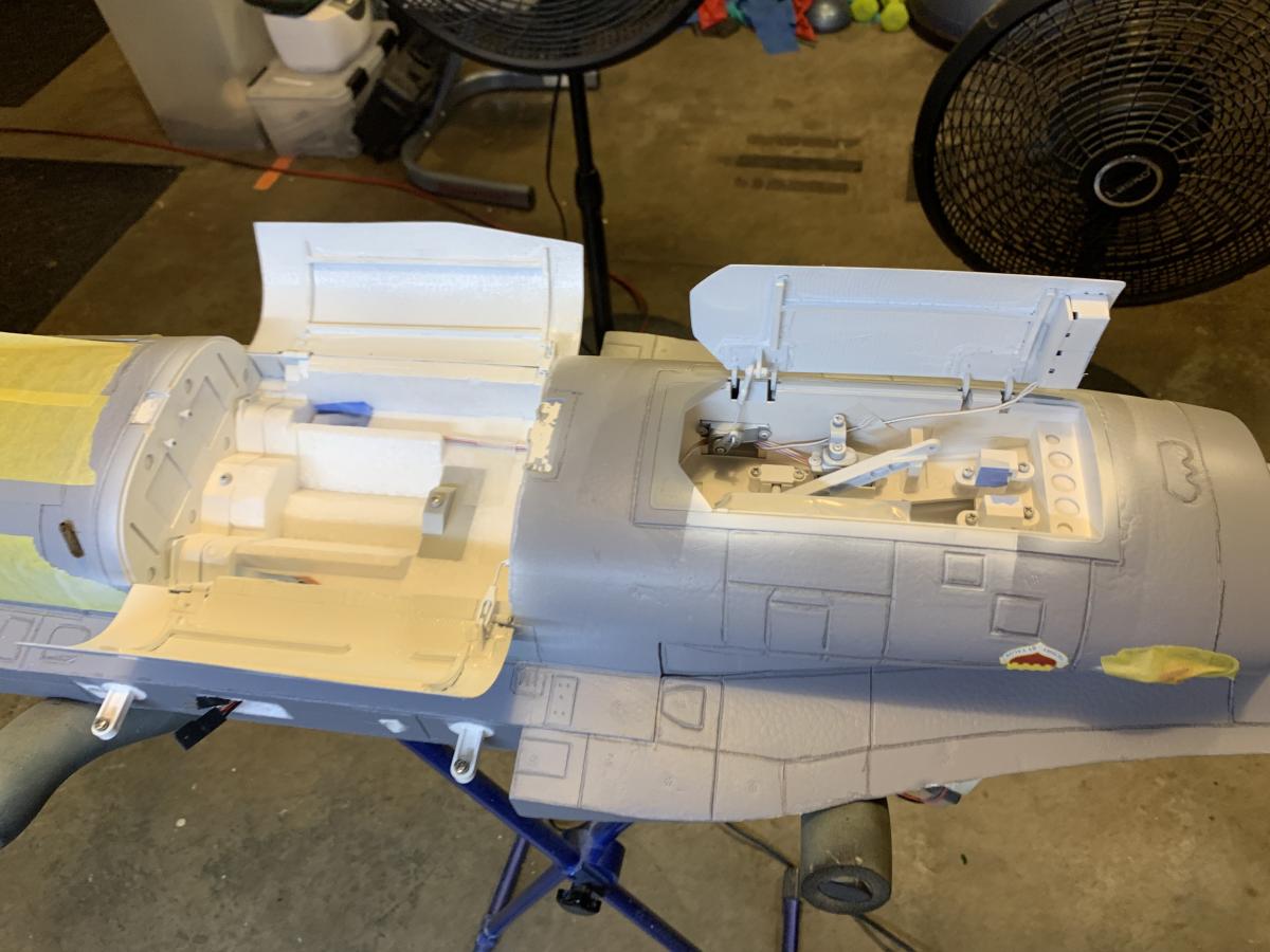

ID:	269571 Bought a used Viper from a friend. Excellent condition. First step of the repaint is to get the wells, doors and struts gloss white.
    Before repaint started, I maidened it on a 6S in-runner setup just to make sure the trims and balance were all set. The plan was to put it on an 8S setup like my other 90mm F-16.
    I have to say, I might keep it on the current setup. Obviously, it’s not as fast as the 8S and the vertical isn’t as impressive but it flys and lands so much lighter I just might keep it as is.​

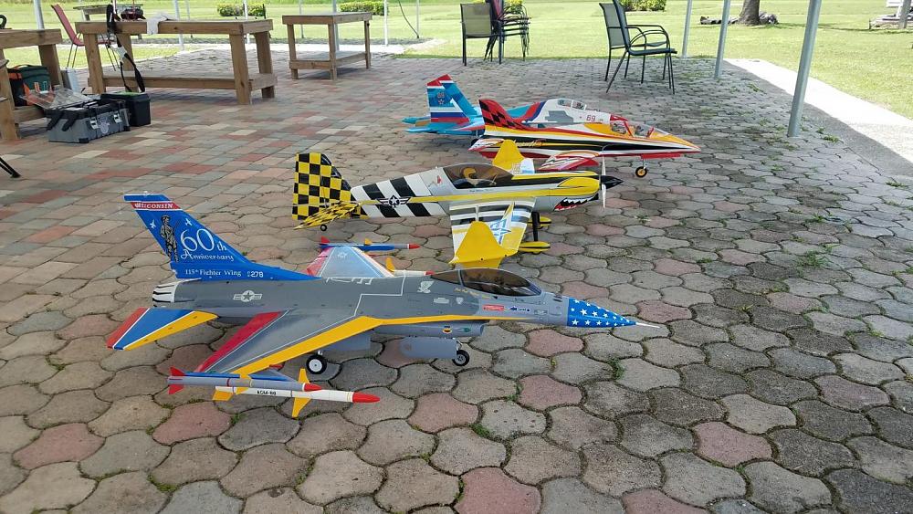

  • gooniac33
    Nice!! Is that the same EDF that now comes in the BA F-18? I think so, should make a nice upgrade. Although the more I fly mine with the 12 blade 4068-1835 Kv inrunner, the more I like it. Flew my Wisconsin Fighter wing version today and even in 98 degree, humid weather in dead calm wind, it got off the grass in 100 feet. Any of you EDF "masters" out there that can tell me the performance difference in the 12 blade 4068-1835 inrunner versus the 9 blade 3672-1900 Kv inrunner?

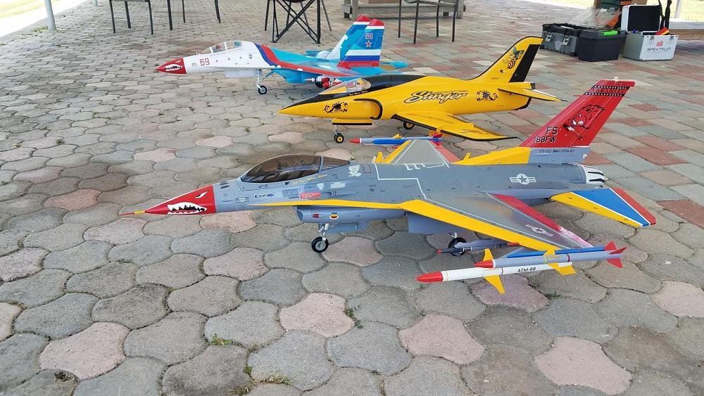

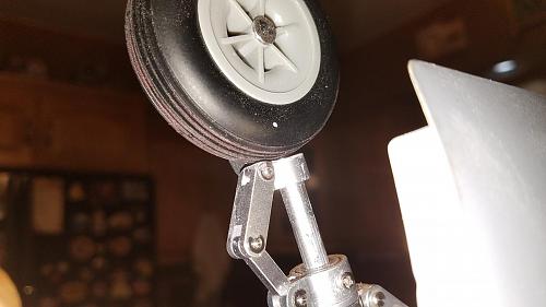

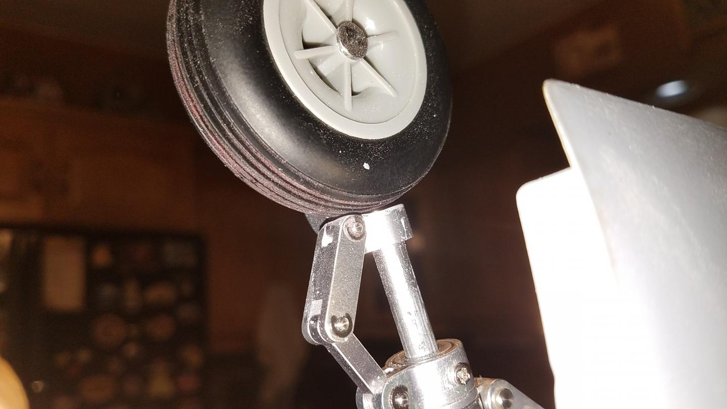

    Got the F-16 out yesterday to try the nose wheel modification and a couple different batteries from the RT 5500 70 C I've been using. This time changed the livery to the Fighting Razorbacks version and got it out with a stiff 15-20 mph wind. I tried the HRB 6000 mAh 50C and the Hobbystar 8000 mAh battery Phantom had suggested to me (thanks for tip).
    First off, the new nose wheel worked like a charm, it took off with each battery in less that 100 feet (before that it took a good 130-150 feet), so the slightly higher AoA on the runway helped and the larger wheel (going to 2" from 1 3/4") resulted in much less drag on the grass runway, allowing it to reach V1 much easier. And it was a hot, humid day, which makes it perform like it's at a higher altitude than being at sea level. As far as the batteries, the HRB performed great, virtually the same thrust as from the RT and at the same weight (but at least $40 bucks cheaper in cost), but gave about 20 seconds more flight time (an eternity in EDF's). Surprisingly, the HS 8000 (at 900g) performed just as well and gave an additional minute over the RT (but still need to fly that battery more to gauge it's ultimate performance and flight time). So now the RT 5500 is out and the HRB and HobbyStar are in. It seems the upgraded 12 blade 4068-1835 Kv inrunner in this is worth it's cost, cause if it can fly well with a brick like the HS 8000 in it (after already being considered a "heavy" jet), that's saying something.
    Unfortunately, I noticed that Hangar 9 no longer makes the 2" Pro-Light that I used but was lucky that I had several from other planes I no longer have. Not sure what a good alternative to that would be because the diameter was perfect, with only slight modification to the strut, and the width was just right and the axle hole could be drilled out to the right size. And it's not as "mushy" as the stock wheel so rolls on grass easier.
    Also modified the SU-30 nose wheel to the 2 1/4" Hangar 9 (which are still made) and that also worked wonders for that flying bus (at least on take-off, it still flies like a tank). But the HS 8000 was just too heavy for it, although it took off in the same distance, but it flew like :poop: needing almost full throttle to keep it up (and thereby losing any gain in flight time) and ending up with very strained vertical. No HS 8000 for that beast anymore!
    Anyway, I have attached a really bad video of both take-offs with the F-16 here, but don't give me any heat over the poor quality of the video. It was take with a friends cell phone, the wind was making it shake and I think we both had a few too many shots earlier, but at least it sort of proves that the modifications worked and the batteries are usable. Here's the video:

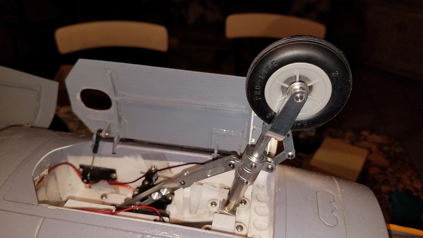

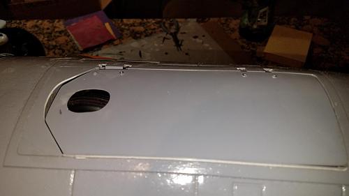

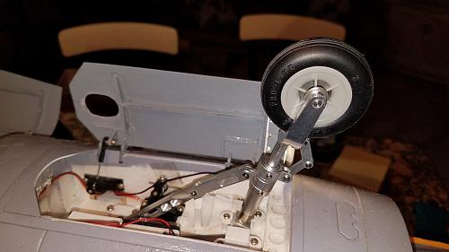

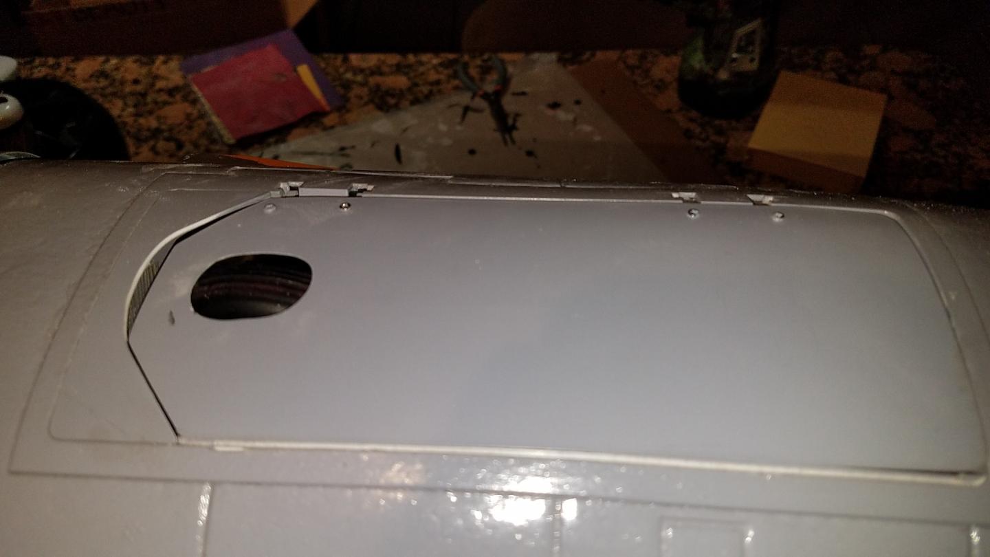

    Ever since our club's lawn equipment went DOA and they got a new machine, which doesn't cut as low, I've been struggling to get a couple jets off the runway, the SU-30 and the F-16 (even with flaperons and the upgraded 12 blade inrunner in the F-16). A couple days ago I was able to get a 2 1/4" Hangar 9 Pro-Lite wheel on the SU-30 which required almost no modifications, so today I struggled to address the F-16. Both had a smaller 1 7/8" wheel in the nose. Well, after several hours of grinding and modifying (and a bunch of choice words :face_with_symbols_o), I was finally able to get a 2" Hangar 9 Pro-Lite on the F-16 nose. I had a few of these from other planes I don't use, but noticed they no longer sell them, the smallest being available now is the 2 1/4".
    I did need to grind down the wheel assembly without destroying the functionality of the shocks so it would turn freely, and then I had to do a slight modification to the gear door. Cut the opening of the hatch aft so the wheel would swing in and had to put a small hole in the aft portion of the door over the high point of the wheel so it would close completely, but otherwise not that bad. Don't know if this will help, but I'm darn sure it won't be any worse.
