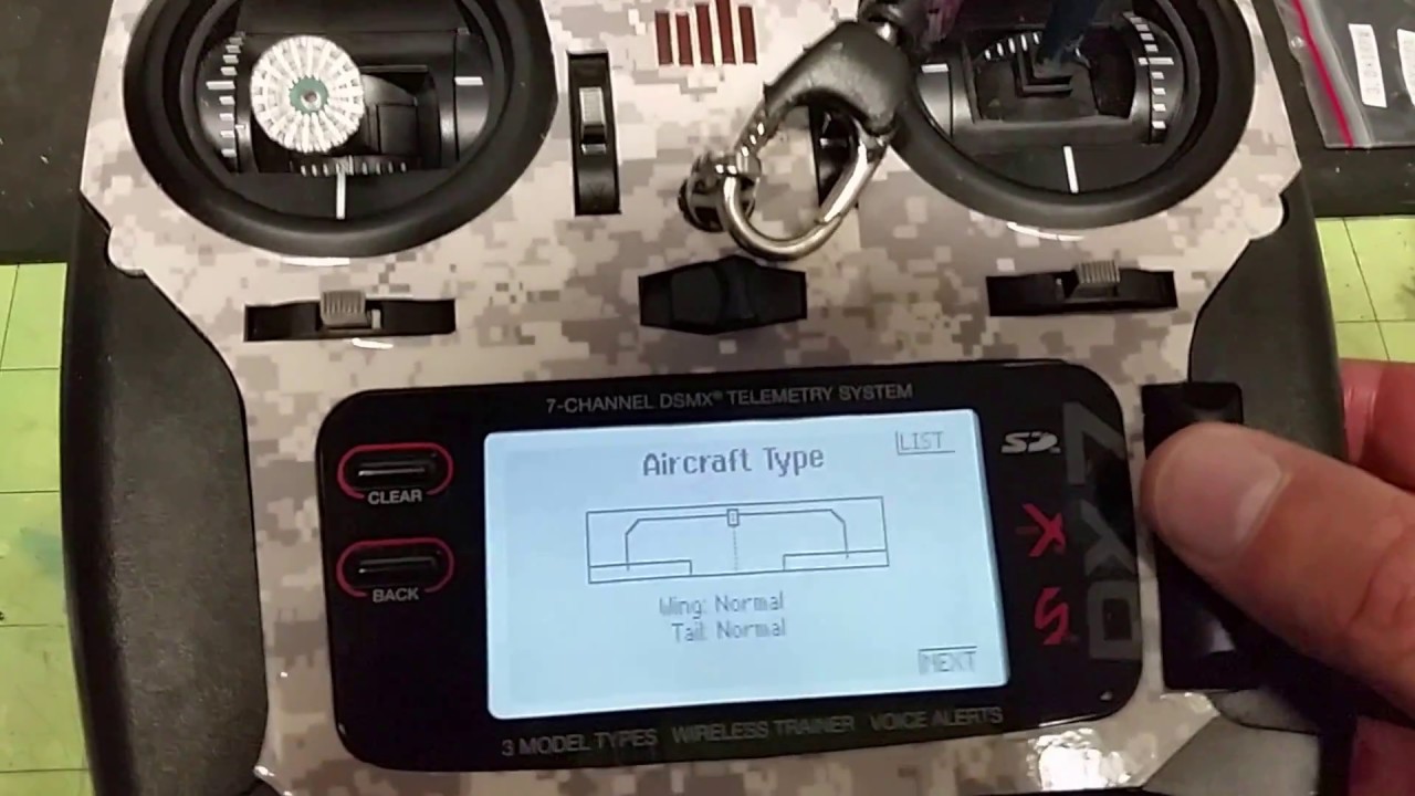

I assume you have Aircraft Type Wing: 1 Ail 1 Flap. If my thoughts don't solve it from above, I suggest you first change the trim setup so just the elevator is on F mode and then go and see what the aileron servo travel does when you change flap settings. Of course, I highly recommend that you write down exactly the % numbers you put in the Flap System and Elevator compensation and also write down the exact trim or any subtrim on all surfaces so you can at least get it back to where your last flight was if need be. If the ailerons still move, remove F mode (change back to inhibit) and change trim setup back to everything normal, then see how the aileron servos travel as you change flaps.
You can always open a New Model, set it for flaperons, set flaps at basic numbers like 100%/0/-100% and elevator % to 0/-5/-10. Make sure all trim switches are zero'd out on the main flight screen, the go a set F Mode to switch D, trim setups for elevator/aileron /rudder to F mode, and see what the servo travels are with that.

Todd, first off, in the trim setup, BTW the DX12 is slightly different than my DX9, but lets give it a shot. I do have left and right trim and have to admit I'm not sure what that is, but have both set to Common and Norm. I recently upgrade to the DX9 from a DX6 which did not have that left and right trim, so I'm in the dark (as usual). BTW, just below that is Trims:Normal. There, if you want, you can change to crossed and the left trim switches will adjust aileron and elevator and the right switches will now adjust throttle and rudder. This would be nice to have so you can keep your fingers on the aileron/elevator stick and trim adjust either with the left hand. I'd do it, but I'm too used to it in the default way that I'm sure I'd forget I changed it when the going got tough. Should've do it early in my flying career.
Now to the main issue. Having the aileron change with the flaps is a complete mystery to me, it absolutely should not do that. I does look like you have it set up correctly though, there really isn't that much to it. And any trims you put in the Flap System are in addition to the trim switches and do not get "overwritten". That's why I said leave the adjustments there as a good starting point and then if you need to further refine the trims, you can do it in flight with the trim switches. I would remove the rudder from the trim setup and put it back to normal, not F mode. The rudder trim should not change with your flap settings, so no need to have it and up up doing 9 trims (3 each for each surface, 6 is plenty). As a matter of fact, if you ever do trim the rudder in flight, it should be the same with flaps, so if you leave it set as F mode, your rudder trim with flaps up will not carry over to the other 2 flap settings.
Go back to the main flight screen and make sure that your trim values are the same with the aileron with each flap position. If you originally trimmed the ailerons at say -6, then with flaps up it should still be at -6. However, with flap position 2 and 3, it will now show 0. Make them all the same, based on your original trims which should be shown in position 0. Now go back to the servo travel screen (in Servo Setup or Flap System-both should be the same data) and see if the ailerons are still different with each setting.
Likewise, for the elevator trim, you already trimmed that before and whatever value you have should be shown with flap position 1 (flaps up). Go to position 2 and 3 and make sure the trim value on the main flight screen is the same as you have in position 1. This should now be the same as when you flew it before making the change. As a test, Adjust the trim in flap position 2 & 3 (different numbers) and make sure those values aren't carried over to any other position. Then return the trim values to be the same as position 1, which is your starting position from previous flights.
I hope this is the problem, that somehow the trim settings for the ailerons with each flap position are now different after you set up F Mode and they should be the same. If that solves it, I would leave the aileron switches in F Mode. I do have to adjust occasionally the ailerons when deploying flaps from their fly around position.
