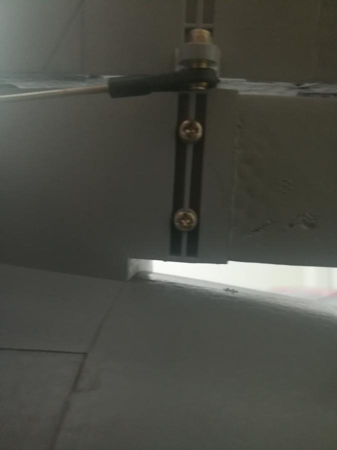

  • Bellke
    Originally posted by Alpha
    Bellke Two screws anchor the pivot rod into its plastic mount on the fuselage, and the pivot rod's outermost tip (within the horizontal stabilizer itself) is fastened by way of a collar and screw. All these parts are visible in the picture on the spare parts page, linked below. I hope this helps! Since you bought the model used but unassembled, hopefully you're not missing any parts.
    https://www.motionrc.com/products/fr...ounting-pieces
    Thanks Alpha, I've got the collar and screws for each elevator, that's not the issue. It's the pivot rods themselves. I slide them into the holes in the fuselage but there doesn't seem to be anything that holds the rods in the fuselage. I push then in as far as they can go, with the elevator having maybe an 1/8" clearance, but nothing seems to be holding the rods in. They just slide in and out with no resistance. If I turn the fuselage on it's side, the elevator (with pivot rods attached) slides out. Right now the only thing that would keep it in would be the pushrod when it's connected.
    Looking at the manual, the 2 "cutouts" in the pivot rod go into the fuselage like something would catch them. But nothing on either side seems to be holding the rods with the elevator in. It just seems like something should be holding it in besides a pushrod.
    Originally posted by Bellke
    Question about the elevators. Are the supposed to lock in when you insert the rods into the holes where they attach? The only thing really holding them in place will be the push rod connecting to the servo. There's got to be more holding the elevators in place.
