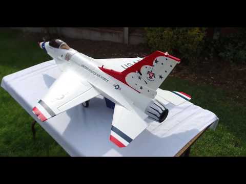

    I bought the ARF+Servos option and converted it to turbine power with a Kingtech K30G.
    Bit of work in it but she flies great, and sounds superb.
    Here is the maiden flight video -
    I am already planning my next Freewing turbine conversion ;)

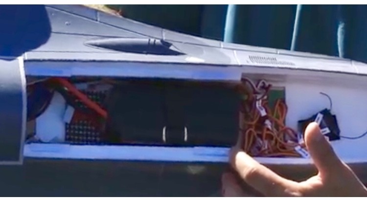

    First flight cg was 118mm then 115mm for the last two. I'm flying with 5000mah. By your pic my batt is 1/2" to3/4" aft.

    My first 2 flights the thing catapulted straight up off the runway on takeoff and floated way long on both landings. I had it at the “book CG” and it was way off. I moved the battery way forward and it performed great. I don’t have the CG listed, but here’s a picture of where you should place your battery. I found it best to keep the size between 4000-5000 mah. Any heavier and it’s too high of a wing load, you get the same flight time, and it flys very heavy. Just my experience...
