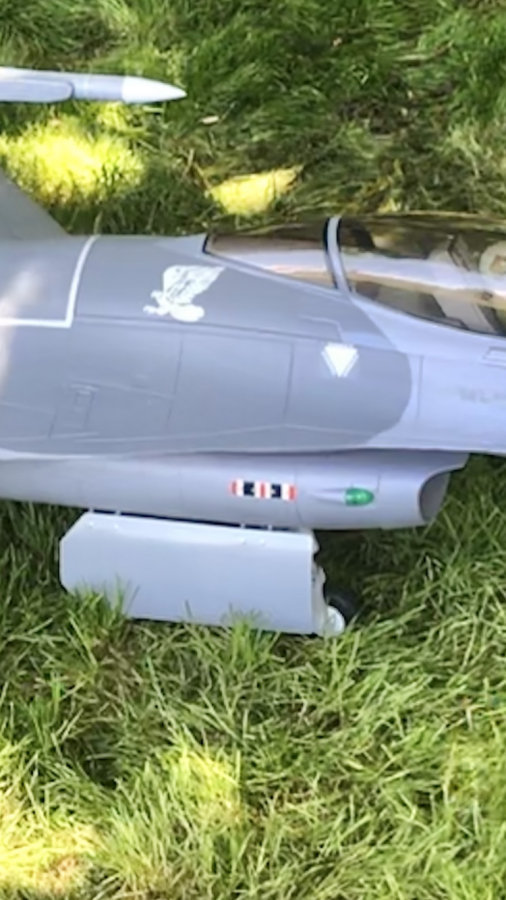

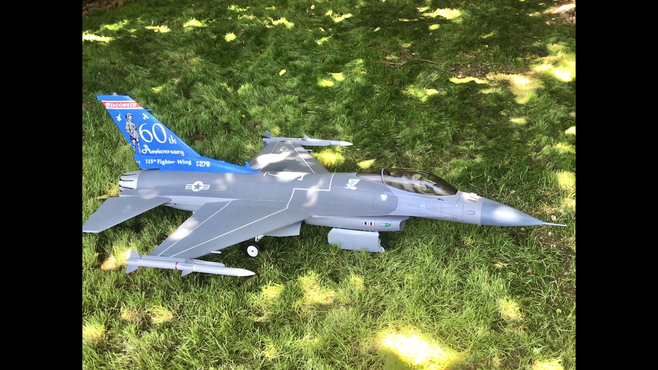

    I love that tail too! Makes the plane look awesome. I painted my nose cone a darker shade and used acetone on a Q-tip to remove the different command emblem and replaced it with the Outstanding Unit Award like the actual aircraft.
    A few more photos from this evening
  • scootergenie
    That does look nice !
    After flying the stock colors for a while, I finally decided to switch over to the WI 115th FW Tail. Love how it looks on the F-16!

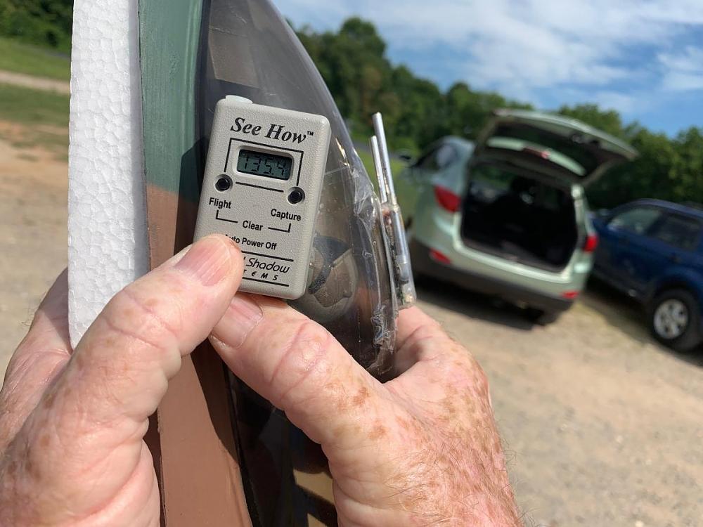

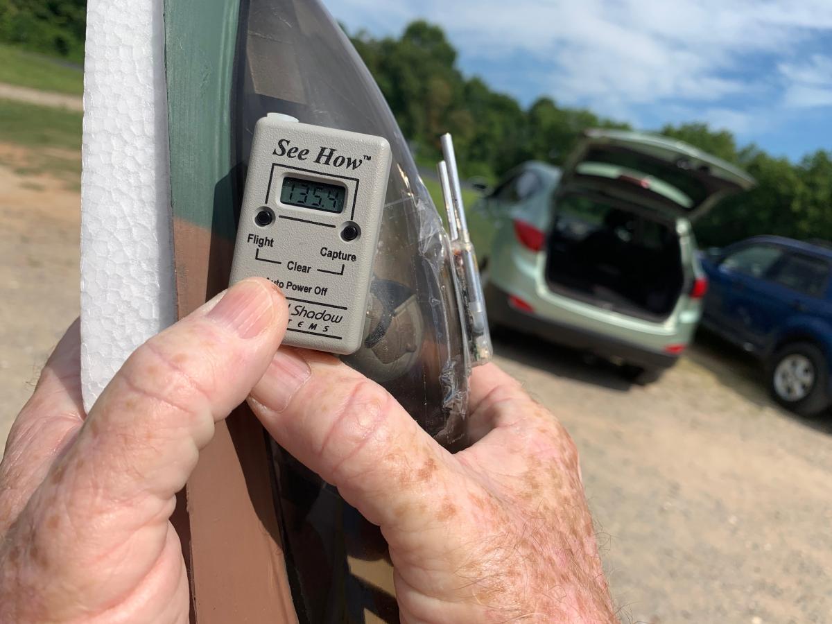

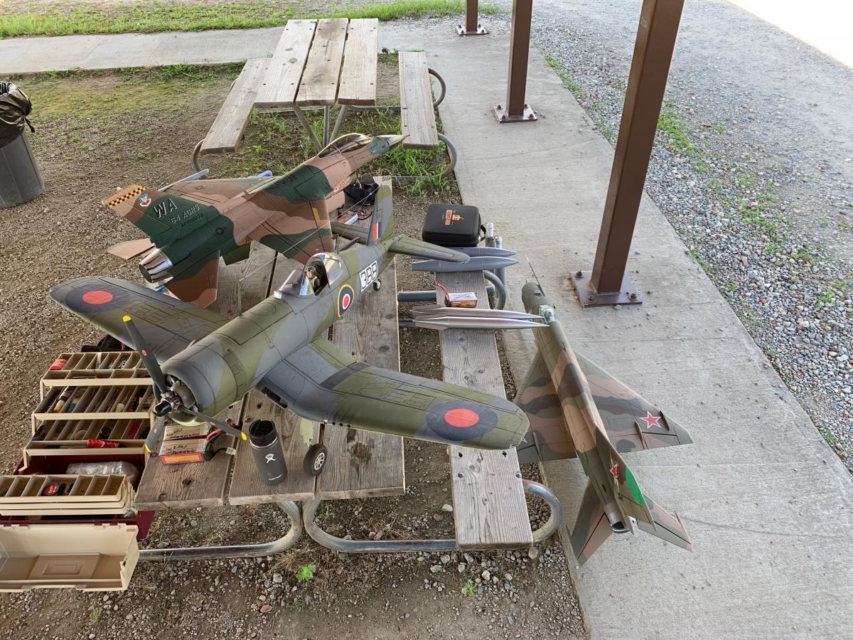

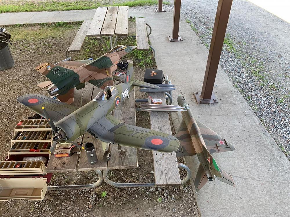

    It was a Freewing and Flightline kind of day.The F-16 has the Freewing F-4's 8S power system in it. Now it flies like how an F-16 is supposed to. Used my friends pitot-static system and recorded 135.4 mph!

    Dang your hands look like mine. :Thinking:
    What, wait... you have friends? :) Yes another great day.
