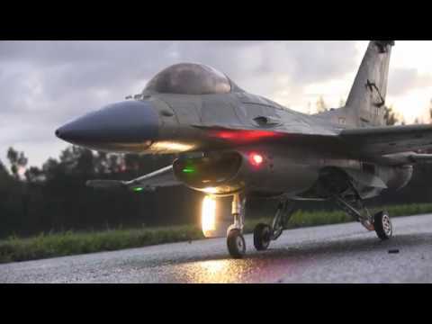

    Anyone follow this cat on youtube? Thoughts on this afterburner mod? Pretty cool. I'm assuming some sort of water-spray mechanism?

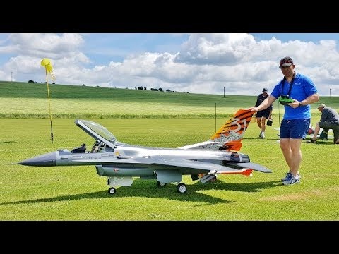

    Very nice, as an f16 video this is far and away one of my favorites
  • Porkster
    Speaking of an f16, this one I saw in the video, just from a watching standpoint just stood out as nothing short of amazing.
    Some of the guys in that video are from my club in the UK
