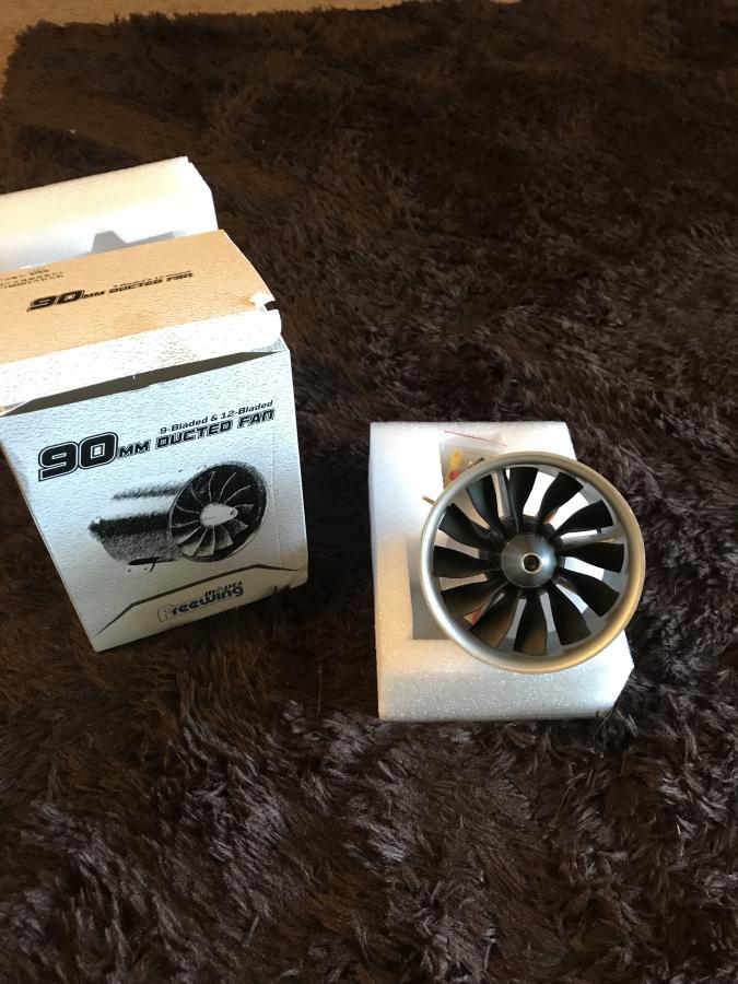

    I decided to go 8s after I bought this from RC Castle. It was $190. I’m selling it for the same amount I paid so I don’t have to pay to ship it back to China.
    This is the Freewing Inrunner 1680Kv upgrade that is sold out at MotionRC. - Motor:: 4068 1680Kv Inrunner Motor (Installed). - Rotor: 90mm, 12 Blade Normal. - Rotor Blade Material : Nylon Composite With Fiber. | eBay!
