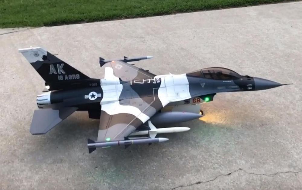

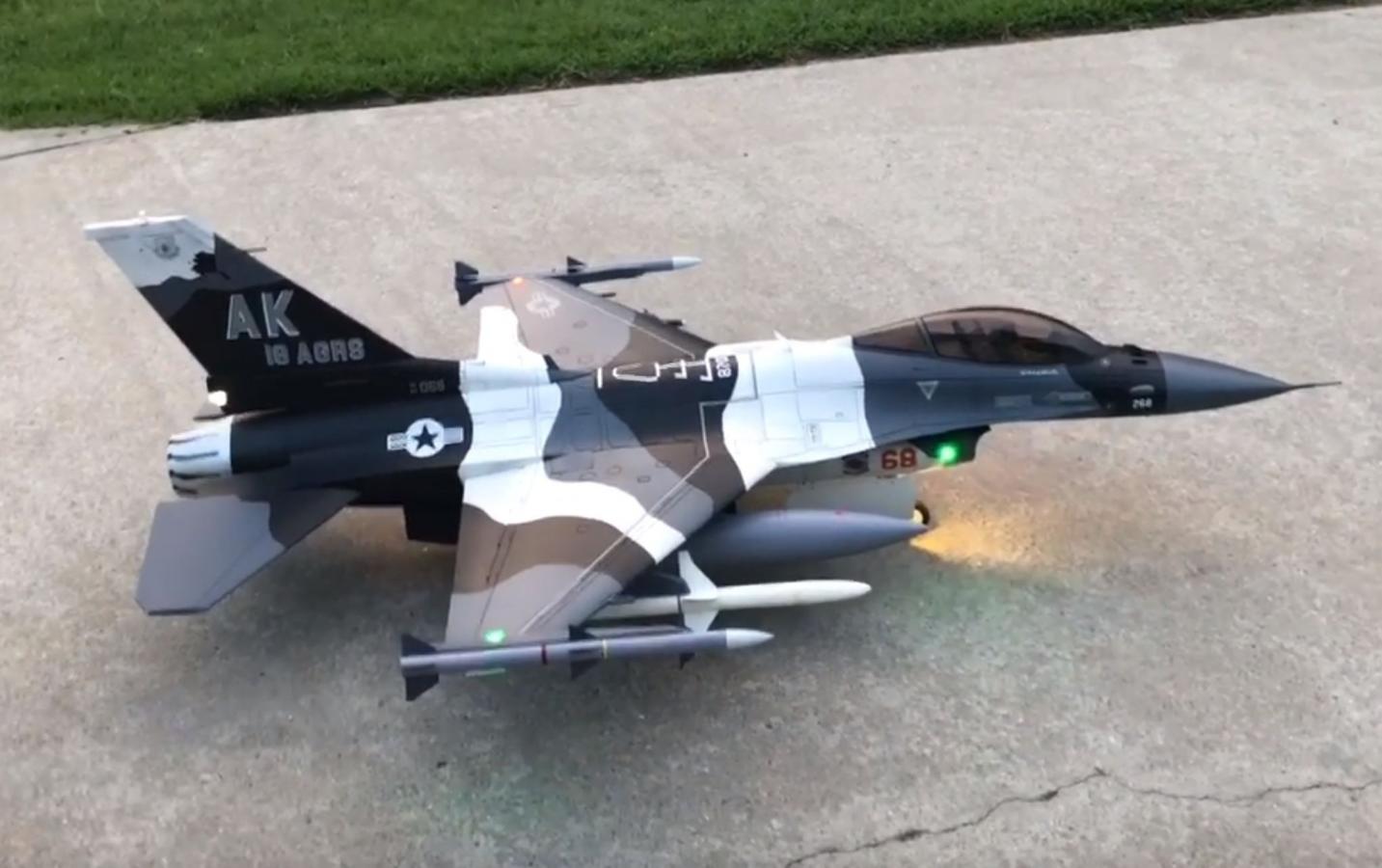

    Somewhere along the way I have lost my subscription to this thread so I have re-subscribed...It's been several years since I had this jet. Love the size and scale appeal but never liked how heavy she was and flew stock. I have satisfied my large scale F-16 itch with the HSD 105mm F-16 in recent years, but she too, is a chunky monkey. However, having no idea when or if Freewing will be coming out with a New Gen 90mm F-16, I thought I would revisit this model, especially after seeing Jeff's (of Jeff's Custom RC on YouTube) fabulous job of converting his to the Arctic Camo (video below)...Now I want one again, and paint it up the same!
    So before I sink my teeth through 20 pages I was hoping I could get the quick and dirty Upgrade/Mod Cheat Sheet...
    I assume I will need to put a new power system in it. Looking for a great solution. Something that can help offset the AUW with the appropriate thrust to weight ratio. Looking forward to any and all information!
