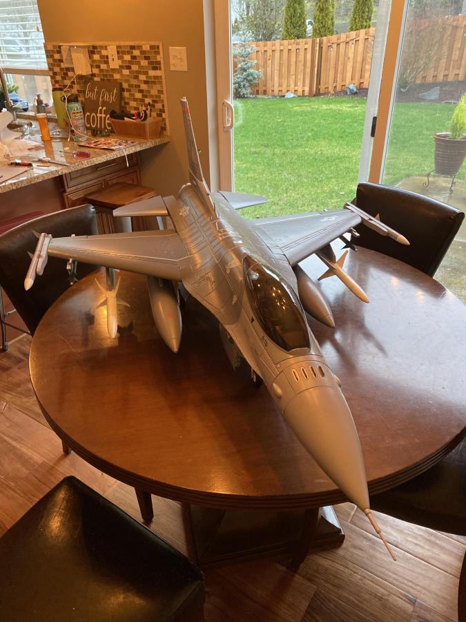

    Alright got her all ready to go. Have some questions and tried searching the thread but wasn't coming up with the info I was hoping for (it was funny/nostalgic reading my posts from nearly 5 years ago getting her ready for the original's maiden). So to avoid reading 577 posts I hope some of you don't mind indulging me with some info that I am sure has been addressed along the way. Much appreciated!
    1) CG... I read recently someone saying the sweet spot was 120mm. Does that sound about right? I know we all have our preferences but I always like to hear a general consensus +/- 5mm....
    2) Blinking LEDs... I see and think I remember now that by default the LEDs all blink/flash. I don't mind the tail LEDs flashing but I want the nav lights solid. I was looking at the diagram but I couldn't make sense of it. Is there a easy way to get the nav lights to solid state?
    3) Throws... I assume the recommended for ailerons are too touchy...I always dial those down, especially for a maiden. Anyone have some numbers they have found like the CG that seem to be the sweet spot/range?
    4) Clean/Dirty... She looks SO badass with full ordinance package and tanks! I want to fly her that way but I probably should maiden clean or at least with just the wingtip rails. Has anyone found a huge difference in flying fully clean versus fully dirty or somewhere in between? I know some jets don't seem to mind flying full dirty, maybe just a tad slower is it, but others behave entirely differently. Any thoughts on this are appreciated.
    Well those are the main questions I have. I may go against my normal routine and paint her all up Arctic Camo before maidening. Primarily because the weather is garbage here in the Pacific Northwest and a maiden seems far out at this point. Might as well keep busy with painting her in my chosen livery. Temps aren't too cold at the moment. 50's...Might be doable. Thanks again for any information anyone is willing to offer!
