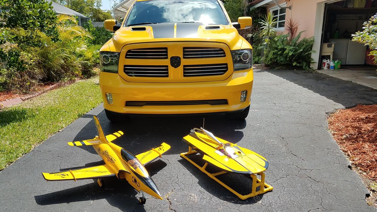

    I am a big fan of yellow on aircraft, sports cars (your truck is the same color I would want for my dream car the Lamborghini Aventador (or Diablo still!) and hydros! Yeah Callie is a miracle worker. I submitted a fantasy scheme to her once and she nailed it in every detail. She is one of my "Essential Workers" of the hobby that is for sure!

    Thanks for the shout out on the Stinger 90, it was definitely worth the time. It flies great but I thought the original scheme was butt ugly. A couple other guys at the field had one and you can guess by seeing my other stuff, but I can't stand having something that looks the exact same as someone else, so time for a re-paint. Modeled it after my truck and a nitro hydroplane I built long ago (and now I'm redoing a 1968 Firebird 400 convertible that was originally my hot roddin' mom's in the same scheme). My CO kind of came up with the scheme and we found the different pictures on line that we wanted to use for the graphics. I sent Callie some low res photos of the images I wanted along with the colors I wanted and the sizes, and she did the rest. Her graphics actually came out better that the images I sent her, she is truly amazing. I now really enjoy flying it, I think it looks interesting, it certainly is much easier to pick up the orientation considering I'm most likely blind and it has a zero "pucker" factor. I think it flies as easily and as well as the Avanti, only slightly heavier and faster. This was my first EDF and got me hooked!

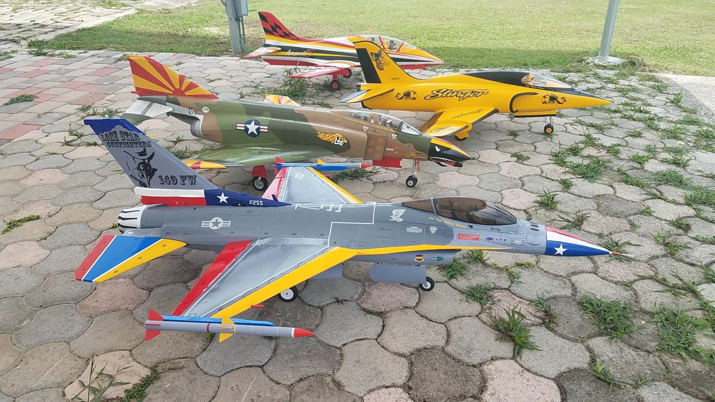

    Got 20 flights in today, 5 each on the F-16, F-4, Stinger 90 and Avanti. Winds were supposed to be 10-13 mph, but all day it was 18-25 mph, but perfectly straight down the main grass runway. Was a little nervous flying the F-4 and F-16 in those winds (certainly the highest I've tried), but both handled it nicely. It actually seemed that this heavy beast of an F-16 liked it. First time I haven't had to use take-off flaps on grass, and it lifted off nice and smooth. But I still landed with full flaps and wow, was it great to bring it in and land at maybe 10-15 mph ground speed and it was so easy to get it into high alpha before touchdown. The upgraded 1835 inrunner did a great job climbing, doing cuban 8's and split S's. I'm starting to really enjoy flying this F-16, I just gotta get it out more (2 little time for 2 many planes-but you can't have too may planes). Just changed the tail and nose to the 2nd of 4 liveries I made so next time out it will be "a different F-16" again. Guys at the field think I have 4 F-16's, and I'm not telling them any different.

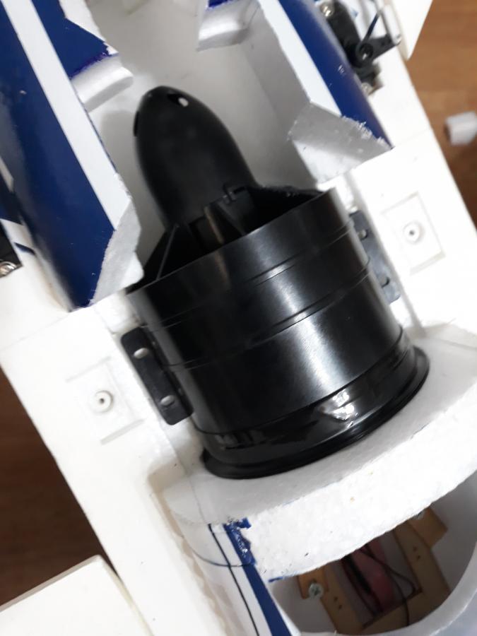

    Guys, I got the FMS fan in, wasn't difficult at all... a little surgery and she went in just fine. I was planning on doing the maiden with the stock servos, what would be a drop in fit for the horizontal stabilizer servos? I bought Hitec but they are just a little too big.. :(

    Just got my F-16 and I can't fit the FMS fan..... What do I do????
    You must have missed some of the post about that, the FMS unit is not a drop-in fit, it requires some cutting, the Freewing 4068-1835 inrunner drops right in, which is heavier but sounds and performs great, I wasn't impressed with the FMS unit, some claim to get better performance, I never did on any of my Freewing jets, I like the drop in fit of the Freewing inrunners, no hassle.
  • C17loadmaster
    Shave... in order to get the unit in I had to cut out a section of the fuselage. Which was replaced and glued in.
    Just by coincidence, I literally just expanded the hatch on a F-15 for fitting the FMS fan. I used a monocote iron turned all the way up and melted the shroud area from the hatch alone. Then sanded the hardened areas. Make sure you run the motor up to full throttle before flight. If you cram the fan in it will end up rubbing on the blades.

    Some pictures or a description of why will help folks here try to offer some assistance.
    You may have to cut out some of the foam but I've never used the FMS fan so I can't say for certain.
  • JeremySean
