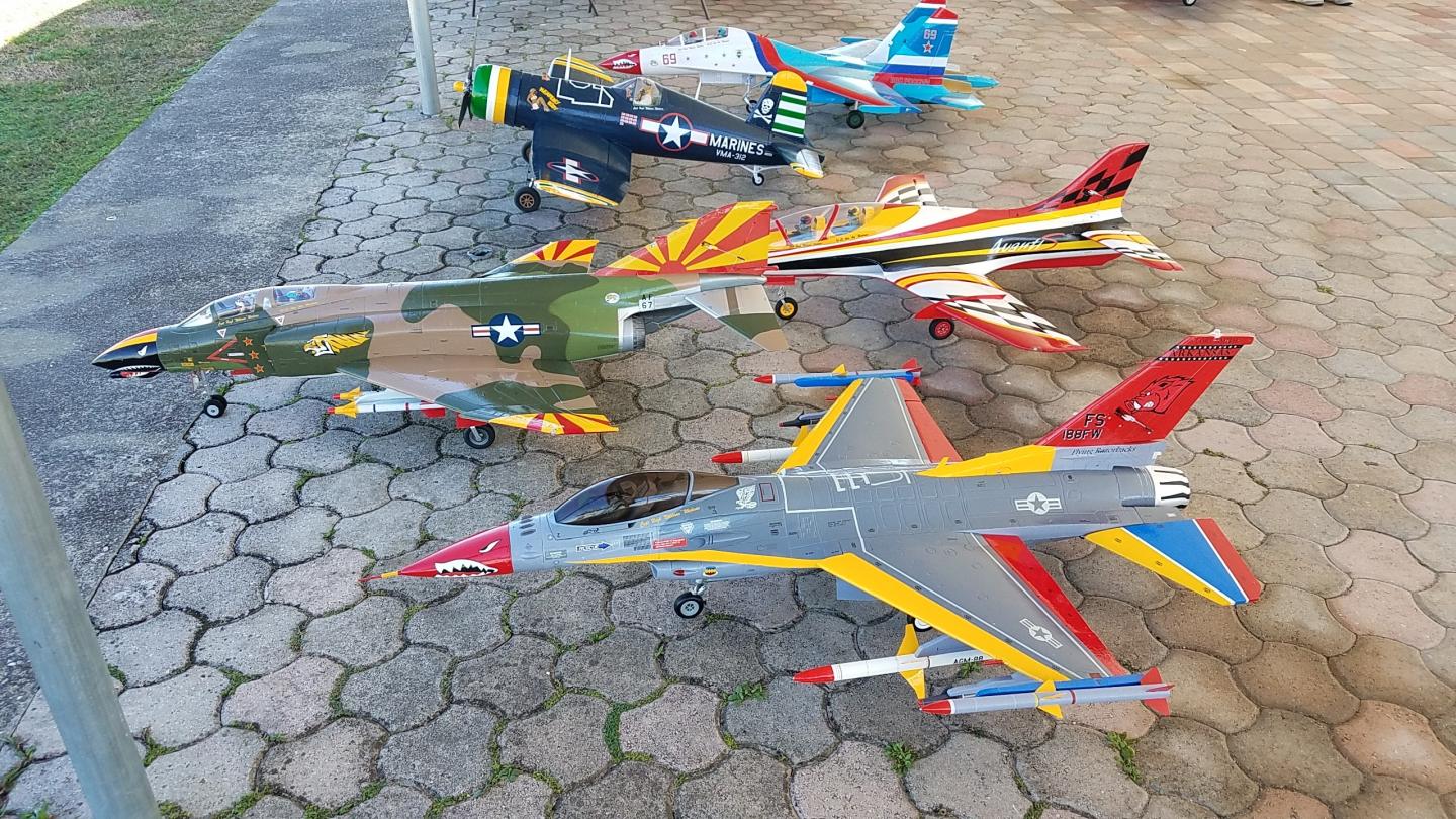

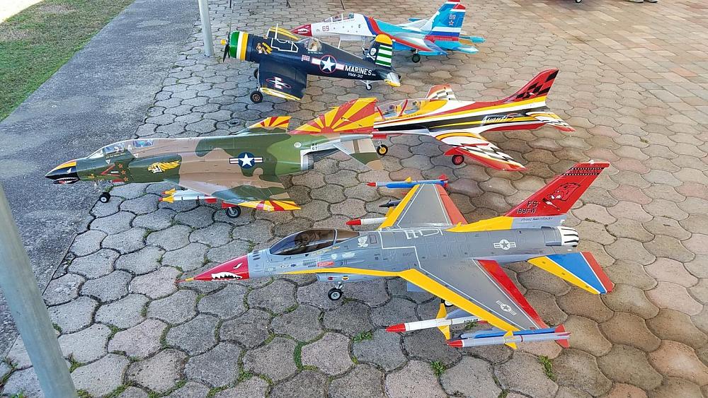

    I really like the F-16 with the 12 blade 1835 Kv inrunner, IMO it flies great. Got out today and put 20 flights on the group, 4 each on the F-16 and F-4. Is it heavy? I don't really think so (now that E-Flight SU-30, that's one heavy pig), but I also fly the F-16 with a very heavy 8000 mah battery in it and get over 5 minutes and with that 12 blade, it takes off of grass very well and has all the vertical I need. Not sure about the 9 blade inrunner it now comes with, although I suspect it too flies very well (better than the original stock outrunner), but that 12 blade has mucho horsepower. I fly it fully loaded as well and the weight of the larger battery (over a 6000 mah) is not even noticeable. On the other hand, although the F-4 is slightly lighter (barely), it also flies extremely well, and I still have the old 9 blade 1750 Kv outrunner, which I think Freewing has "outlawed". With the 1900 Kv inrunner it now comes with I bet it flies exceptional. I won't find out though 'cause I just ordered another 12 blade inrunner to put in the F-4 (and a 2nd one to go in my F-18), so can't wait to see how that fan performs in the F-4. My opinion, you need to get both, but if you only get one, I would go with the F-16. It definitely has a real presence in the air, especially when flown with all the ordinance. The F-4 does not have quite the versatile flight envelope as the F-16. There are certain times that you can create a wing stall, especially if you are going vertical and pull too much up elevator, it can get very squirrely, where the F-16 is much more maneuverable and gets into a high alpha much easier.
    The empty weight of both the stock jets is about the same, 2850 grams (F4) and 2900 grams (F-16 w/o ordinance), although my F-4 weighs in at 3030 grams because I added extra weight with the 3D printed cockpit, several coats of clear urethane and a twin afterburner. The empty stock F-16 is about 2900 grams. Mine however weighs in at 3090 grams empty because I added some extra paint, clear urethane coating, the heavier 12 bladed inrunner and a 2nd LED afterburner to go along with the included ring burner (the more the merrier).

    Thanks Hugh. That's good info.
    I read on the other site last night about the F-16 being 3200 grams empty, but perhaps the power setup was different. Thought with those beefy gear and extra servos it was significantly heavier than the current generation of planes.
