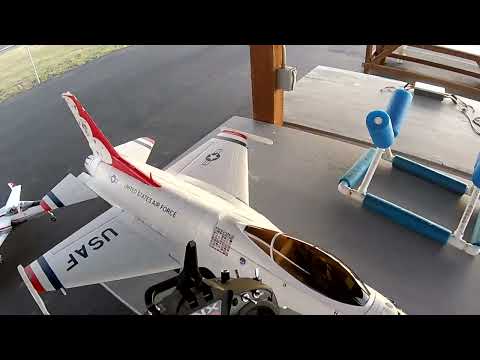

    Originally posted by Icarus the 2nd
    Here's a recent flightvid by one of my clubmembers
    I fly my thunderbird all stock, and love it. One of my favorite to take out and fly
  • Icarus the 2nd
    Can I suggest contacting Ray? Gooniac33.
