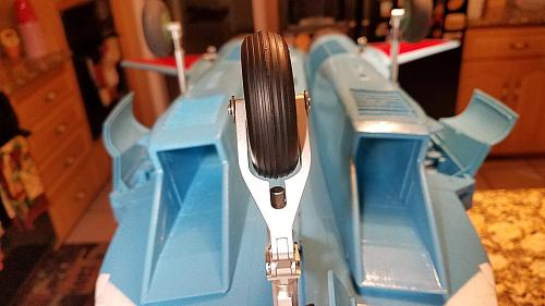

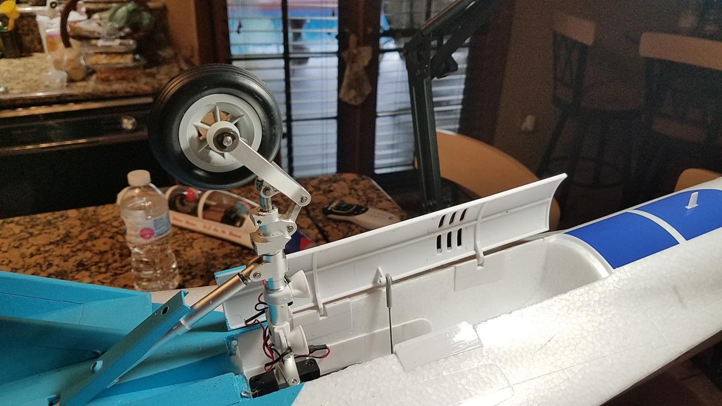

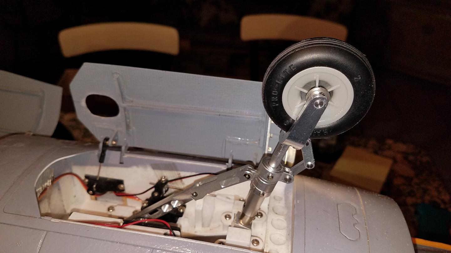

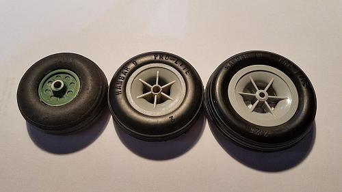

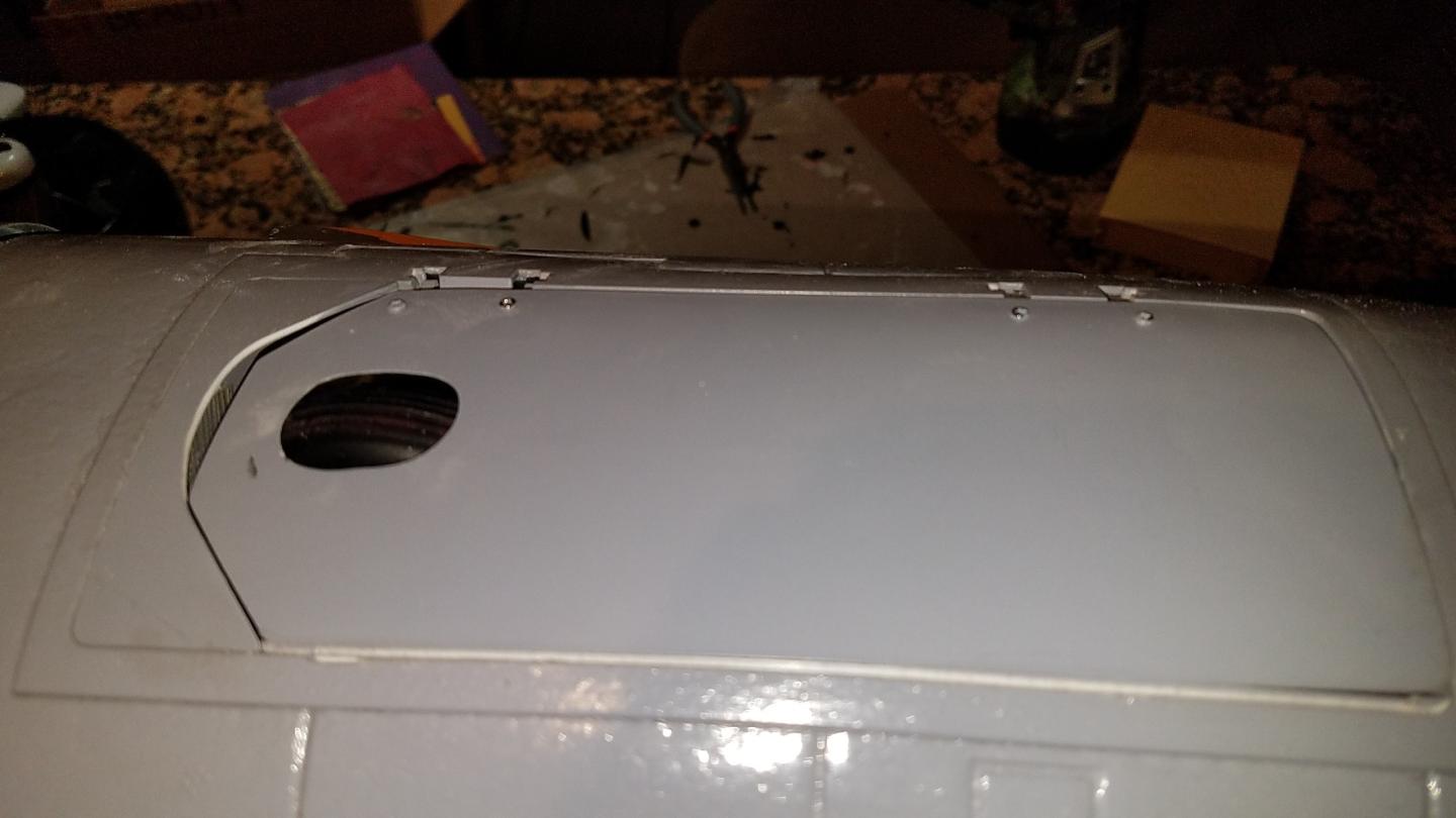

    I used the 2" Hangar 9 ProLite wheel. I had a couple in inventory from use on other planes, but unfortunately, I recently noticed that the wheel (as all the ProLite wheels) has been discontinued and doesn't seem to be available anywhere. It only required very minor sanding on the nose wheel strut so it would spin freely and I did have to slightly modify the gear door so it would close completely. Those were great tires that I used on several other planes, including the 2 1/4" on my SU-30 (no mods required), the 3" on my FL 1600mm Spitfire and the 3 1/4" on the FL B-24. The axel hole was drillable to fit whatever size axel you have. If you can find them anywhere, they're a great wheel, but like most things, if it's good, it's no longer made. :face_with_symbols_o Most other planes I use the Robarts (which tend to be wider) but the ProLite was just the right width for several of my planes. On our grass runway, the ProLite works great on the F-16 and SU-30. really helps the take-off roll.
    The 2" and 2 1/4" Pro Lite compared to stock nose wheel and the 2 1/4" on the SU-30:

    The 2" Pro Lite on the F-16 and the gear door mod:
