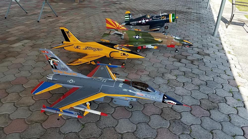

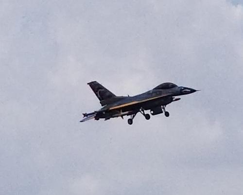

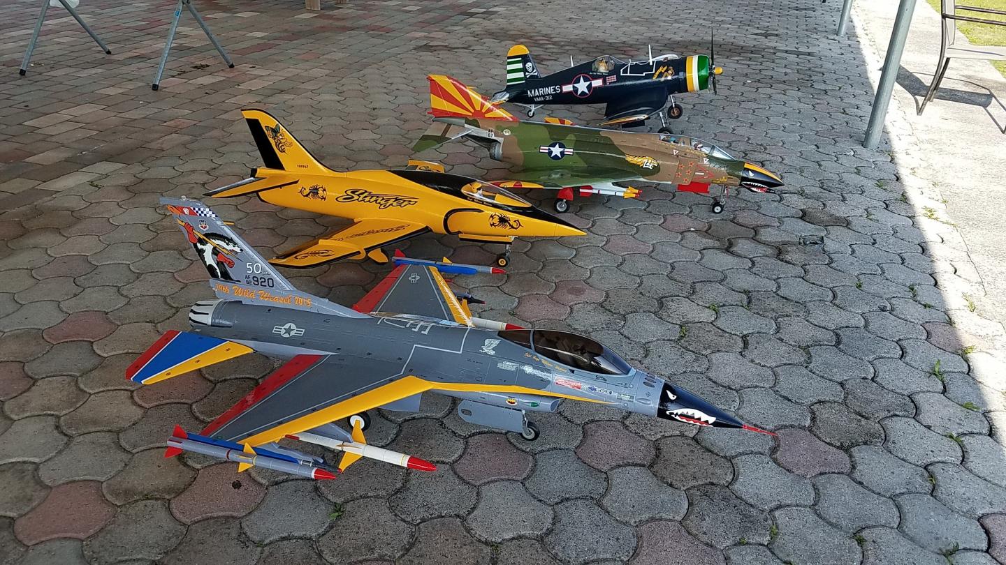

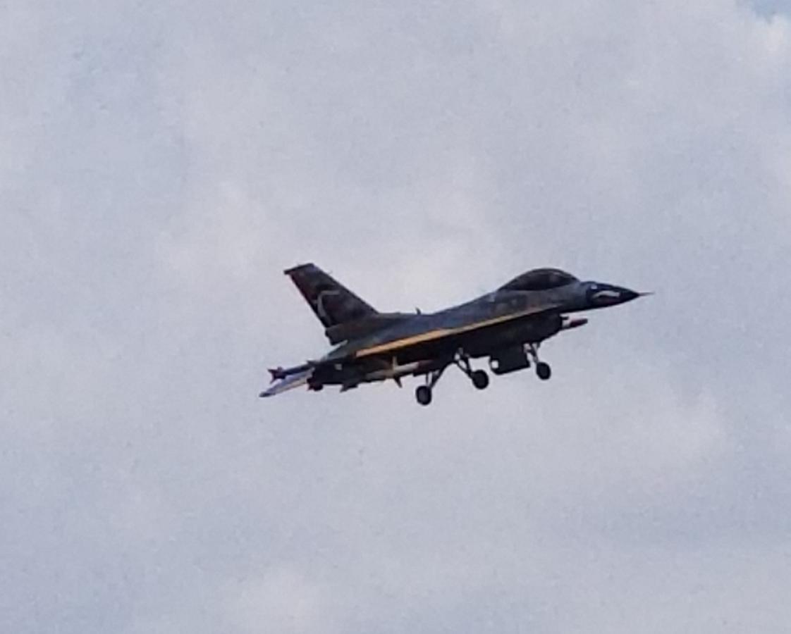

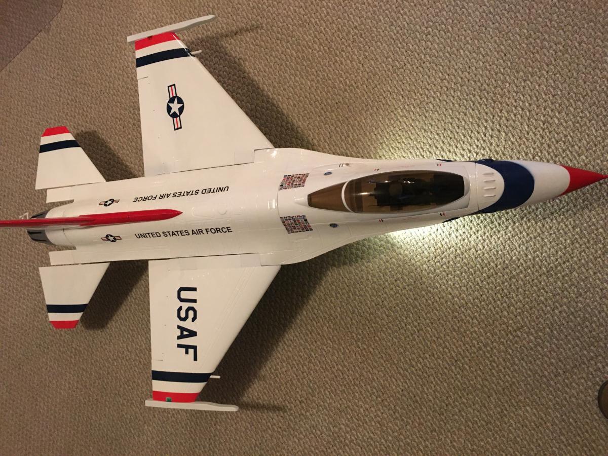

    Got 5 flights each on 4 aircraft today, including my FW 90 mm F-16. I've got the 12 blade inrunner in this (and now have that fan in ALL my 90mm EDF's) and it just flies fantastic. I've been using a HobbyStar 8000 mah 100C (IR meter tested it at 18C), but just picked up a couple SMC (Superior Matching Concepts) 8100 mah 20C batteries from Danny Sullivan. If you have a 12 blade inrunner in your F-16, you gotta try these batteries! Over 5 minutes of flight time (coming in with 25-30% left). The battery just fits 45mmX62mmX160mm, put as far aft as possible. Flying it balanced at 128mm (instead of the book 118mm) and it flies high alpha nicely and is easy to land slow with a nice high nose up attitude. The battery weights 904 gr and the 12 blade handles that weight with absolutely no problem, in fact it flies the same (take-off distance and vertical) as it does with a lighter 6000 mah battery, but gives at least an extra minute and a half or more. And I'm not just cruising around in boring oval patterns!
    Some of you know I've been testing a lot of different batteries over the last couple of years using a Progressive RC Internal Resistance meter to get the actual C as well as a GT power meter to test them with difference EDF's. Generally, the advertised C is no where near the actual C. But the SMC Flight batteries are at or above their advertised C. The 8100 tested out at 22 C with individual cell IR's in the 1.7 ohm range and individual cell amps in the 170 range. The Hobbystar 100C tested at 17C, and every other battery I tested was anywhere from 30% to 50% actual C compared to the advertised C. SMC's are at least as advertised, if not more. The batteries are also about the same weight as others and the price isn't outrageous. The 8100 is $135. There 6200 40 C (currently out of stock :triumph:) weighs in at 814 gr and has a actual C twice that of other 6000's I've tested and cost $95. I'm definitely hooked on SMC's now. I've been using a 6000 50C weight 875g in my F-4 with the 12 blade, and it flies great with just under 4 minutes of flight time, but gotta stick that 8100 in there (only 29 gr more) and see what it does for flight time. Of all the batteries I've tested over the last several years, the SMC's are by a long shot the best, not only in actual C, but weight and cost. For me, that's a "Hat Trick". I got turned on to these by RudyD54 who uses the 5300 mah ones in his Mig. Those are excellent as well.

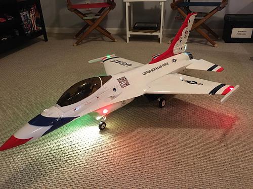

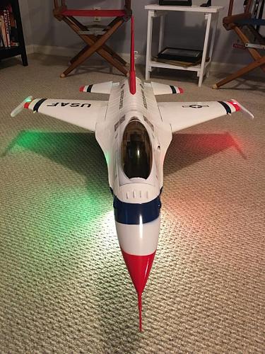

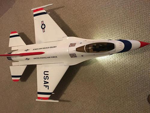

    Another winter project completed. 😀 Equipped her with a Spektrum AR 637T Receiver and added a sound card for turbine sounds and of course afterburner.. Power is a 9 Blade 90mm 3672/1900kv Inrunner with a 130amp ESC. Upgrade to Hitec D85-MG servos for the elevator control. 2 Coats Poly to brighten her up. All rates set (Spoilerons and Flaperons ) and forward programing was completed for Safe and AS3X modes. Another great looking plane that might end up a Show Bird until I can master my landings.... Click image for larger version  Name:	IMG_2325.JPG Views:	62 Size:	121.6 KB ID:	304335Click image for larger version  Name:	IMG_2326.JPG Views:	45 Size:	176.3 KB ID:	304336Click image for larger version  Name:	IMG_2327.JPG Views:	42 Size:	192.1 KB ID:	304337

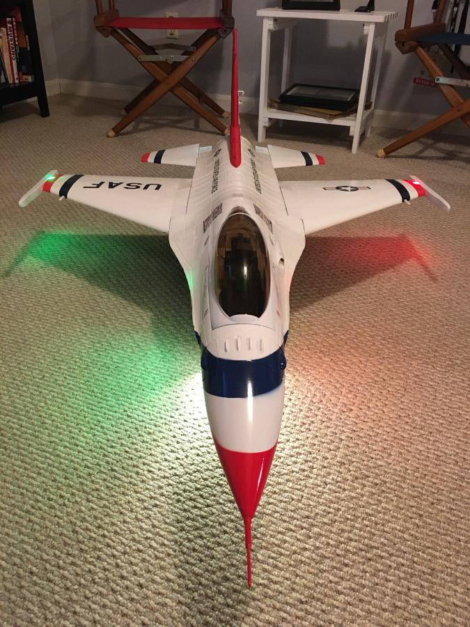

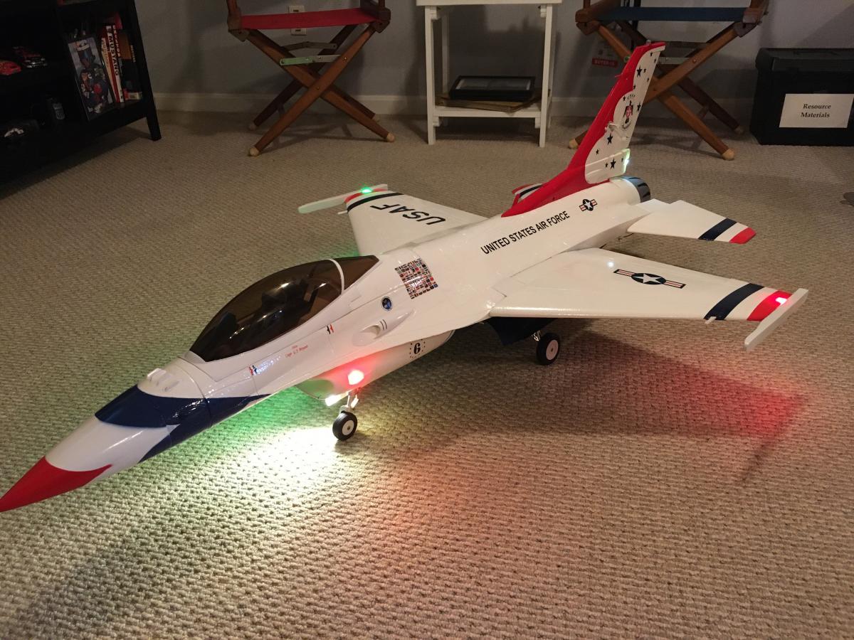

    WOW that looks great!! I need to do that to mine. Also if you don't plane on ever taking off the wings, glue them in place! It made a huge difference on mine!

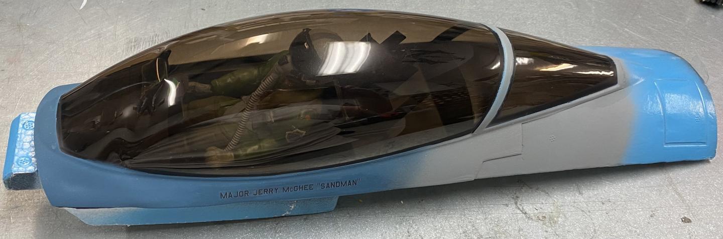

    Hey Alpha! Can you produce a clear canopy for the 90mm Freewing F-16 so that my cockpit detail can be seen? The one that comes stock with the kit is too dark. It would be nice to have an alternate canopy (clear) to help show cockpit detail. Attached are photos of my F-16 cockpit and of the full-scale F-16.
    Thanks,
    Jerry
    Whoa, nice work. That's one of the first F-16 cockpit mods I've seen, congratulations to you. A clear canopy would be just the ticket for that bird. I'd like to see a photo of the whole aircraft as it looks like you did some other painting work as well. BTW, wish I could be at Florida Jets in your town but can't make it this year. A bunch of our clubs members are going though.

    Very nice job! Love the gloss coats as well.
