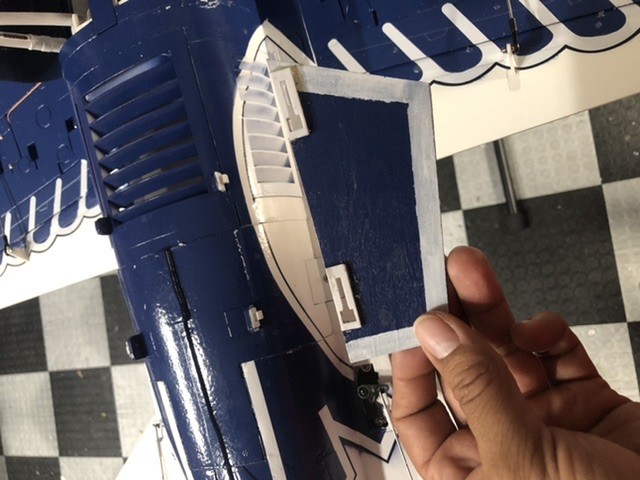

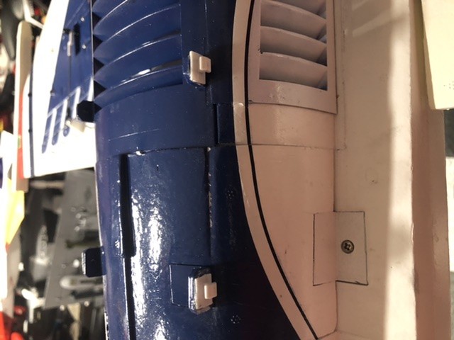

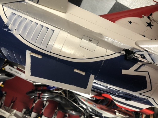

    I think the ventral fins will get in the way when transporting it, did not want to screw them on and off so ended up making them removable. I did the same thing on my F14 (idea from rcinformer) now I can set it on it’s belly flat. Just need to add some blue paint.

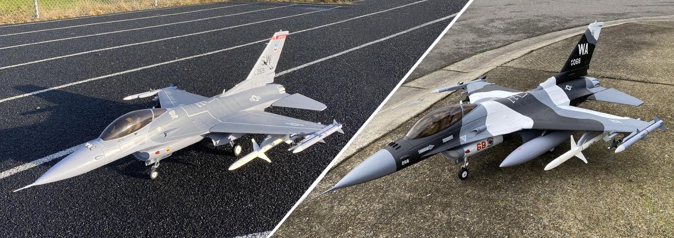

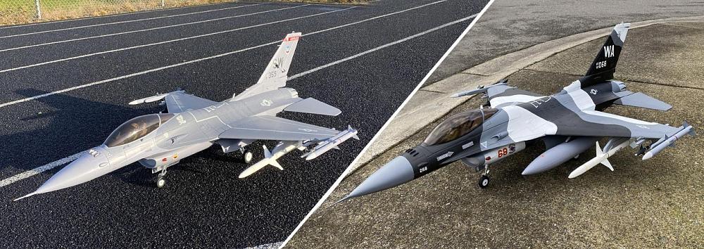

    Nice little surprise...Callie's decals arrived today, so she's all done! A little before and after...

    Thank you Skyboom!
  • Skyboom
    Stunning! You really knocked this one out of the park.
