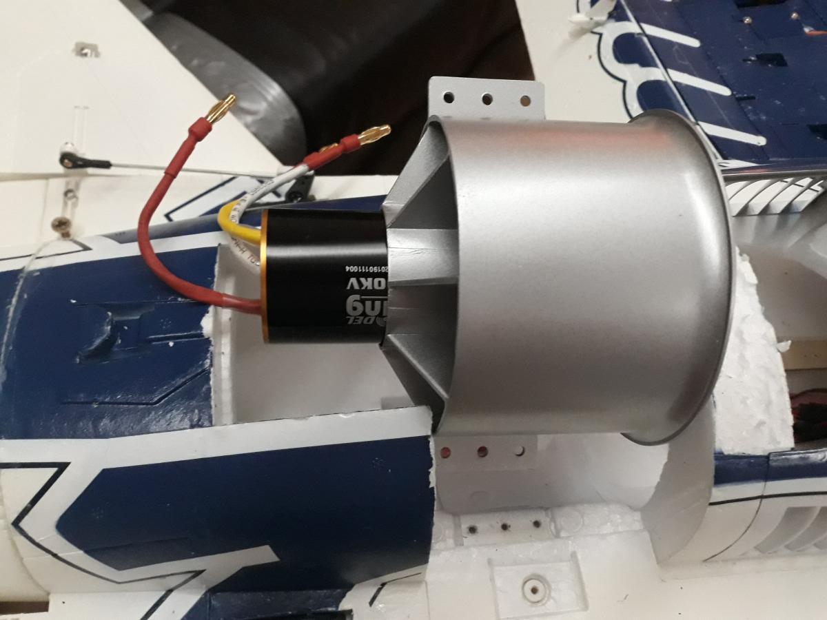

    Does anyone know what size the bullet connectors are on the original EDF that comes with the plane?

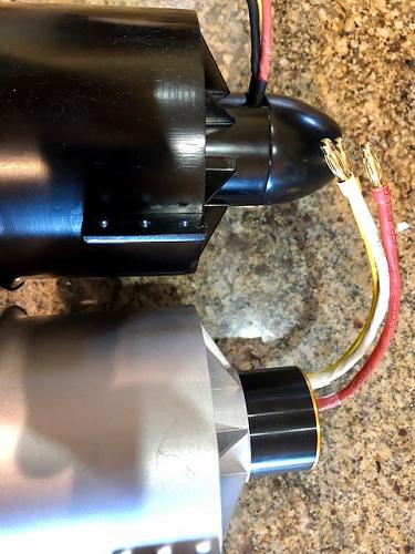

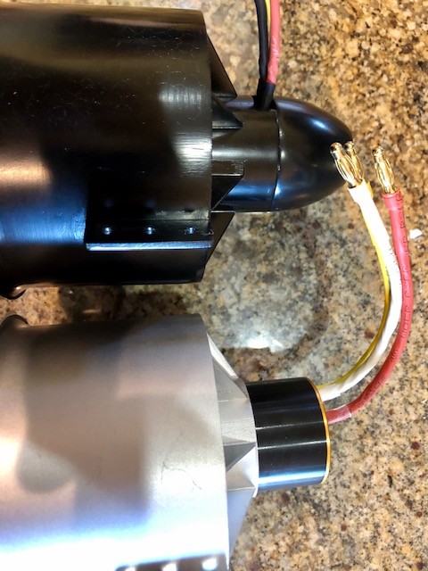

    Originally posted by Bellke

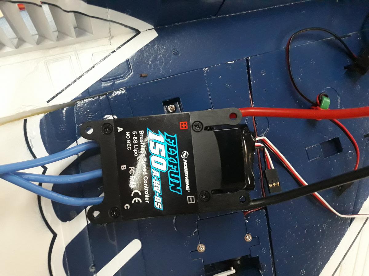

    Now I know why the leads didn't reach the ESC. The original came off to the side while the new EDF has the wiring coming out the back. That places the wires further back on the new EDF and also has them turning back 180* where the original is only a 90* turn. The pic will give you a better idea. I've lined them up where the fan shroud begins and both shrouds are the same length. It's how the wires exit the motor that's causing the issue of it not being a straight drop in replacement.
    Now if I could figure out the ESC, I'd rather not buy one and considering this is a "new" one I'm hoping I can trouble shoot it. I did find what I think is the correct manual online and it says: Trouble - "After power on, motor does not work, such an alert tone is emitted: “beep-, beep-, beep-” (Every “beep-” has a time interval of about 0.25 second)". Possible Reason - "The throttle stick is not in the bottom (lowest) position". I've tried it several times with the throttle at the bottom but I still get the beeps. I even put the original EDF back in just to see. The biggest difference was the beeps were louder and the "stutters" with the fan were more pronounced.
    If I do have to buy a new EDF, do you have a recommendation? It doesn't look like the original EDF is sold by Motion any longer, the closest Freewing EDF is the 150A for 8S power systems. Have you heard anything about the Geico EDFs? There's about. a $40 difference between the Freewing and Geico ESCs.

    My recommendation is to stay away from the Gecko ESC. :poop: I purchased the F-16 ARF version 4 months ago and the upgraded inrunner along with the Gecko 150 amp ESC. The ESC had major timing issues and every 3rd or 4th time reducing power to zero, it would not engage again and needed to "recycle". Never flew it with that ESC and returned it to Motion and they told me that yes, some of the Gecko ESCs have timing issues, my luck to get one. The only cure is to buy the additional Gecko programming card and reset the timing until it works properly-way beyond my mental capabilities, so I just returned it and replaced it with a Castle 130 amp Phoenix with 5amp BEC , which works outstanding. Added a Castle 10amp BEC for extra safety, but if you stay with the Freewing 130 amp ESC it will work fine with the inrunner and includes an 8 amp BEC, enough for the F-16. The Castle comes without the bullet connectors soldered on, so I was able to make the cables the right length to fit. Others in this thread that have the upgraded inrunner have used the stock 130 Freewing ESC and say it works perfect and is a drop in fit so not sure why yours is not.
    If the Freewing ESC 's cables are too short, another option may be to add extensions to the cables, although this requires getting a set of 4mm male & female bullet connectors and some 13 AWG wire, all of which Motion has and solder yourself 3 extensions. I think DCCorsair's "fix" is the most prudent. I also cut a new wooden plate and removed some foam to the front of the fan casing to mount the Castle ESC but not because I needed more cable length, but because the existing wooden plate had spaces in the wrong place to mount my ESC.
    Let us know what you finally decide, but spending extra bucks on another ESC seems to be a waste.

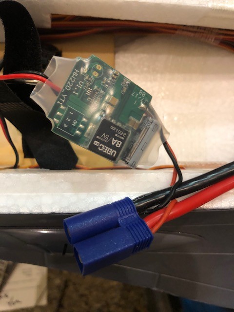

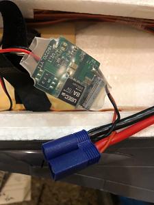

    For a moment I thought we had it, I didn't have the throttle trim set to low (Spectrum radio). Moved it down but still no luck. The BEC is direct wired into my battery cables as shown on this pic so I don't need to plug it into a receiver channel. I didn't do it, it's the way it came. Makes me wonder since you mentioned it, did some come like mine with the BEC wired into the battery leads and some needing to be plugged into the receiver?
    Click image for larger version  Name:	IMG_0405.jpg Views:	0 Size:	62.3 KB ID:	220518
    Yes, you have to plug the wire coming off of the BEC into an open channel for it to get power, the BEC should light up red. You should have a green ferrit ring, which is a noise filter basically and a male plug on the end of that wire that will plug into an open channel on your rx.
  • Bellke
    Originally posted by DCORSAIR
    Ok, you got your throttle wire plugged in to your rx, and you have the BEC wire plugged into an open channel on your rx? Your throttle trim on your radio set to low? If your Futaba you will have to reverse the throttle channel.
