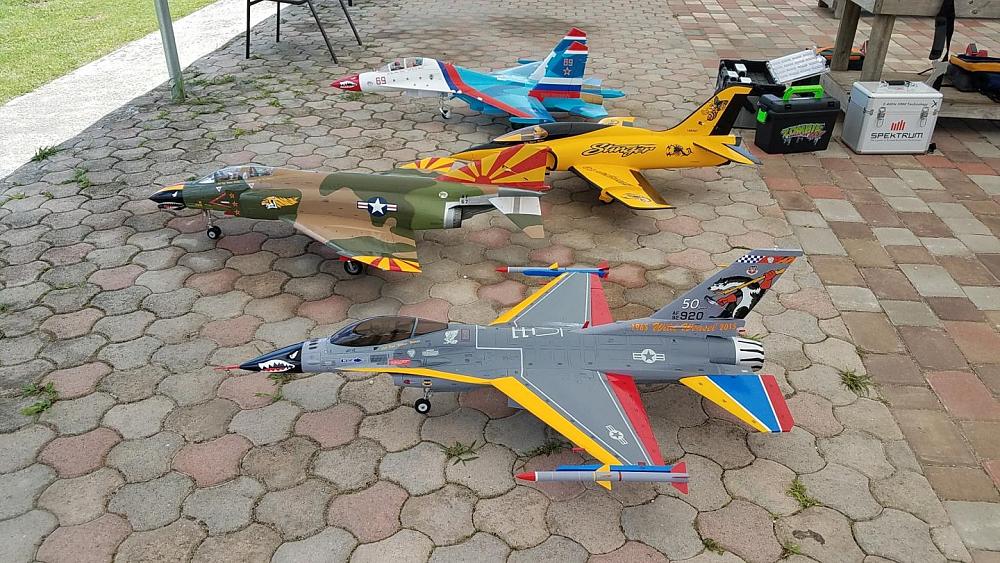

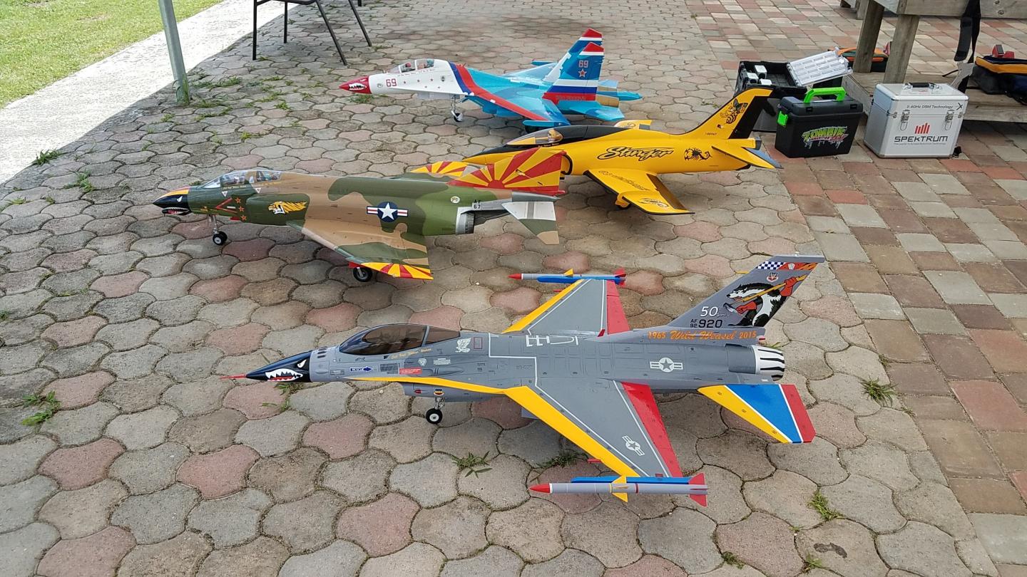

    • Excellent weather today and got 20 flights in on 4 EDF's, including 5 on the F-16 Wild Weasel version . I have been flying it with the RT 5500 70C battery because I have the 1835 Kv upgraded inrunner and that motor draws almost 300 Watts more with a 70C versus the RT 6250 35 C. But today, I made all 5 flights on the 6250 35C. Got an extra 40 seconds of flight time, although it did not have quite the take-off thrust the 70C has, but needed only an extra 20-30 feet (plus I have flaperons and fly off of grass so it can be a long run for take-off, especially if the grass is wet). Once in the air, it flew the same or even a little better as the 6250 is actually 45 g lighter than the 5500. It didn't have quite the top end speed (but I'm no speed freak so who cares) and I noticed it wasn't quite as crisp on the Cuban 8's and Spit S's, but overall, I'll definitely continue flying it for a while on the 6250 (every extra second is nirvana).
      And the sound of the 12 blade is sooooo much better than the 9 blade in my F-4 and F-18 Canadian. One of the turbine guys said it almost did sound like a turbine. That 9 blade really sounds like compared to a 12 blade! I'm finally feeling fairly confident in flying all the jets and doing a lot more acrobatic maneuvers (for me anyway) like Cuban 8's and Split S's. And I'm getting fairly consistent in nice slow 2 point landings high alpha. I even was able to do a wheely with the F-16 on a grass runway (first time ever), but no one else was there to see it and no pictures, so it must not have happened.

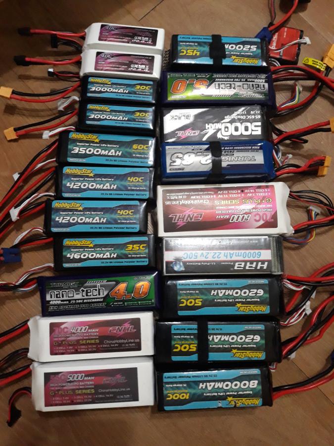

                                • So manufacturers specs for this FMS EDF setup is 25.20v X 112amps=2822watts.
                                  HS=Hobbystar
                                  TGY=Turnigy
                                  TGY-NT=Turnigy-Nano Tech
                                  The rest of the lipos brands should be self explanatory.
                                  Ok from top to bottom these are the power runs,
                                  HS 4200mah 40c 6s two lipos parallel =8400mah
                                  >3141.7 W at 143.46A
                                  HS 8000mah 100c 6s
                                  >2880.4W at 121.35A
                                  HRB 6000 56c 6s
                                  >2802.2W at 120.88A
                                  CNHL G+plus 5000 55c burst 110c 6s
                                  >2761.7W at 121.72A
                                  CNHL 2200 40C burst 80c 6s
                                  >2734.2W at 119.59A
                                  CNHL Black 5000 65c 6s
                                  >2690.5W at 119.59A
                                  HS 6200 50c 3s two lipos series
                                  >2673.5 at 123.84A
                                  HS 3500 60c 6s
                                  >2636.3W at 118.22A
                                  CNHL G+plus 6000 70c burst 140c 6s
                                  >2615.8W at 116.26A
                                  HS 3000 30c 6s two lipos parallel =6000mah
                                  >2552.3W at 116.0A
                                  TGY-NT 4000 25-50c 6s
                                  >2536.4W at 113.52A
                                  CNHL 2200 40c 6s two lipos parallel =4400mah
                                  >2492.5W at 117.02A
                                  TGY-NT 5000 35-70c 6s
                                  >2482.2W at 117.64A
                                  HS 4600 35c 6s
                                  >2469.1W at 117.02
                                  TGY 2650 20-30c 6s two lipos parallel =5300mah
                                  >2459.9W at 117.51A
                                  HS 6200 50c 6s
                                  >2453.2 W at 116.82A
                                  HS 5200 45c 3s two lipos series
                                  >2427.5W at 113.33A
                                  HS 4200 40c 6s
                                  >2287.6W at 112.a4A
                                  Interesting that identical lipos packs when wired up in parallel add over 800W of power. Like in the case of the HS 4200 40c 6s, verses just one of these lipos.
                                  Also interesting to note that two 3s wired in a series produced 220W of additional power over the 6s equivalent. Such as in the case of the HS 6200 50c 3s in a series verses the HS 6200 50c 6s.
                                  My thoughts are that two batteries whether wired up in a series or in parallel allow for a truer C rating to the claimed manufacturers C rating.
                                  Below is a picture the lipos tested so that you can compare lipo sizes.

                                    Good job and thanks for posting, any chance you will do any testing on the Genesace/Tattu 5000 45c and 5000 60c lipos? They are all I use in my EDF jets and helis.

                                      Unfortunately I have no batteries from either of those brands.
                                      • Phantom WOW, a lot of great data to analyze, thanks. The FMS fan is an out-runner, correct?
                                        The 2 HS 4200 40 C must turn this thing into a Saturn Rocket! But maybe a bit much for the 130 Amp ESC you downgraded to, no? It also seems (unless I'm mistaken) that in some cases, the slightly higher C rated battery performs almost identical to one with a slightly lower C. I have definitely found something similar with my jets that have out-runners. The out-runner EDF's in my Stinger 90, the 2-F-4's and my F-18 show virtually the same amps/watts drawn on a Roaring Top 5500 70 C and a RT 6250 35 C battery, with the Admiral 6000 50 C (tested at an actual C of a couple points less than the RT 35 C) just slightly below the 2 RT's. The in-runners in my Avanti, F-16 and SU-30 showed a substantial increase (+7 amps & +250 watts) with the 70 C versus the 35 C or 50 C. I'm not sure that this is backed up by any actual "science" or if it's just a coincidence.
                                        So now after this, what battery set up are you most inclined to go with that gives you the best balance of power/flight time/weight? I'm guessing the HRB 6000 56 C 6S or the 2-HS 6200 50 C 3S.
                                          Historically I've only used the HS 8000 100c 6s, the HRB 6000 50c, and the HS 6200 50c 6s in her since switching back to a 6s setup in her. I'm glad I did the testing as now I know about the additional power the HS 4200 40c 6s in parallel offers. All ESC's have a burst capability and an additional 13 amps of static power wouldn't tax the ESC too much if used in bursts. The system would only experience that with full throttle take off runs honestly because as soon as air starts getting rammed into the fan due to forward momentum, the efficiency of the system will increase and the reduced drag on the blades would demand less amp draw. So I think I'll keep the 130amp ESC in there and capitalize on the reduced weight over the 150amp ESC.
                                          I've used the HS 4200 40c 6s in parallel setup in many of my jets such as my 80mm F-5, 80mm F-86, twin 80mm A-10 just to name a few because I loved the HS 8000 100c 6s lipos, however some of the planes like the F-5 can't fit the single 8000mah lipo. Additionally the 8000's are 159 bucks a piece where as two HS 4200's in parallel cost 30 bucks less, 50 bucks less if they are on sale.
                                          Due to this I have 12 of them verses 4 of the 8000's. I've always been a fan of multiple batteries in a series and in parallel due to the decreased cost and the added mah capacity they provide. However this is the first time I've tested their ability to deliver power over a similar capacity single battery. Now I'm convinced, the proof is in the pudding.
                                          I once loaded up my 90mm YAK-130 8s system with four 4000mah 40c 4s lipos wired first in parallel and then in series to give my 8000mah 8s worth of lipos on board. The interior of the YAK's battery compartment is so vast that I could wedge them into just below the wing and make CG no problem. It was an amazing 7 minute flight on 8s, I sacrificed some vertical, but she handled the extra weight no problem, I'll hook her up that way again, with pics so that you can see the loadout, and post the power run over in the Yak page because now I'm just curious.
                                          The assorted lipos used during this power tests haven't all been flown with this F-16 yet. It was just an experiment using the majority of options for lipos I have, to see the power delivering difference. Having said that the HS 4200 40c 6s in parallel will be my go to lipos for this jet in the future.
