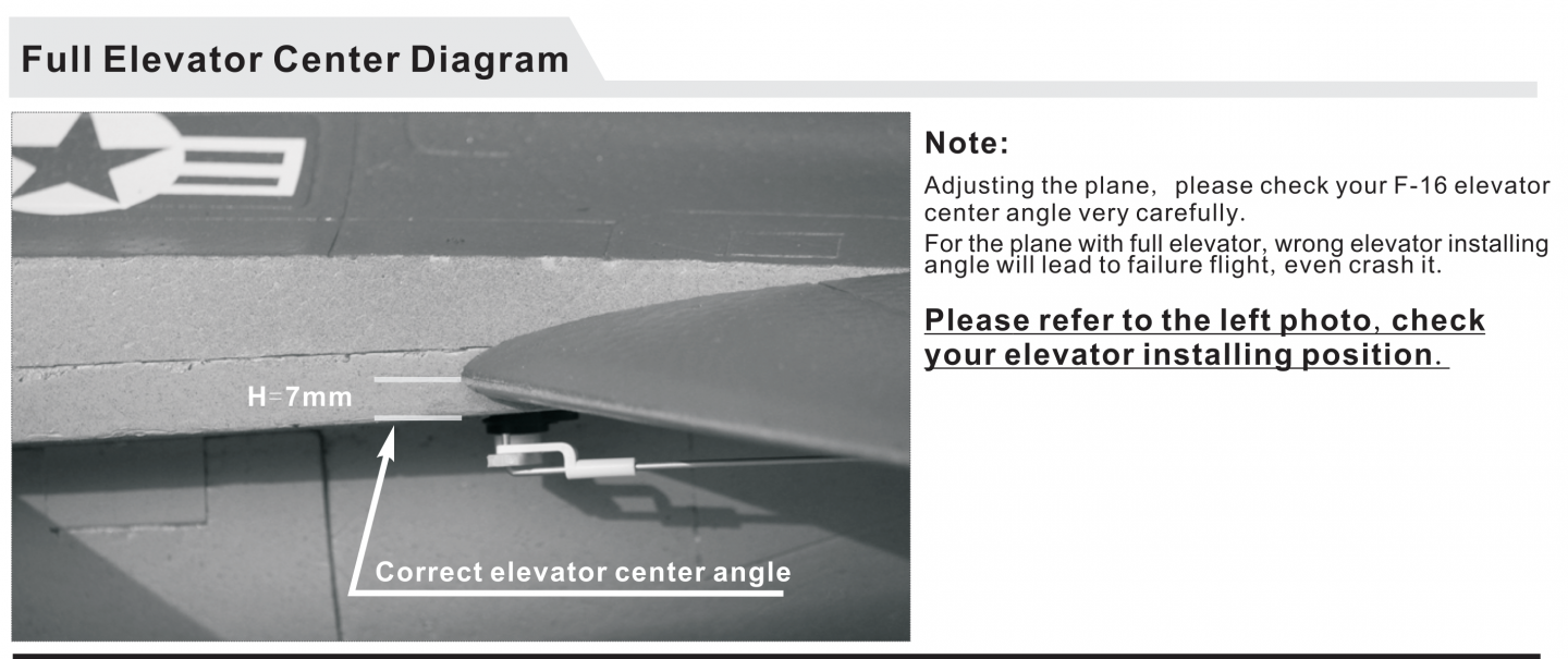

    I finally got past some of the electrical issues I've been having and are setting the rates and want to make sure I'm reading this right. On p.14 of the manual, it shows the Elevator rates at 16 & 25mm but then below that is shows "Full Elevator Center Diagram" as 7mm. Is it saying the a "neutral" elevator should be setup with a 7mm up angle then set the low and high rates at 16 & 25mm? Kind of confusing me since it seems to be saying 2 different things.

      This is what I'm looking at in the manual

        Bellke,
        I believe what they are referring to is that the neutral position (H) is located approximately 7mm above the bottom of the rail (second photo). The arrow in the picture, although it seems to be pointing to the bottom line, is really only pointing to the "area" they are referencing. Set your neutral hands off position at least 7mm above the rail, although I will tell you on mine that at that position, I still needed some up trim to keep it level, but then I set my CG at 120mm so I am at the nose heavy side of the CG. Landing is much better nose heavy, and I found if you set your CG too tail heavy, she's a bear to land. Reducing throttle causes it to pitch up, then drop like a rock as it looses lift.
        The first photo suggest that you measure your high and low rates at the leading edge of the elevator, instead of at the trailing edge like normal as is done on the aileron, flap and rudder. H1, low rate they suggest 18mm up from the neutral position (which is already 7mm above the rail-so that puts it 25mm above the bottom edge of the rail). H2, high rate is then 25mm above the neutral position. Hope that helps.

            That makes sense. I was having a mental block and it just wasn't clicking. Also appreciate you mentioning to measure the throws from the front of the stabs and not the rear. This plane has been messing with me and I probably would have missed that.
