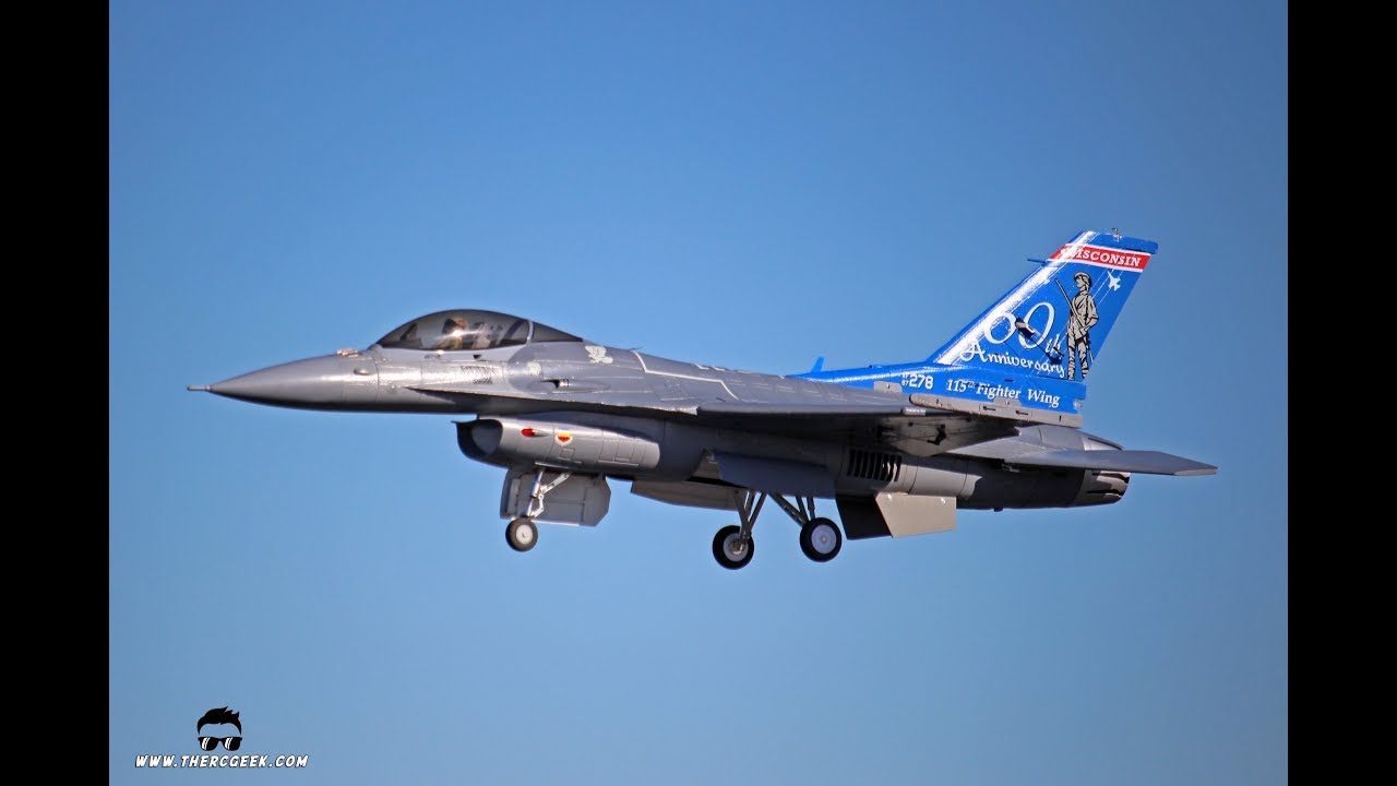

              I sold ALL of the older generation fans I had and bought those the week they were released. I have yet to use the 12 blade though... one is in a F-15 that had the 1680 in it. I’m wondering if the 12 blade is a better fit for the F-22, just because nobody has talked about using it. All of my attention is wrapped up in that plane right now haha
              I have the FMS in my F-16 and will keep that setup. RC Geek posted a video of his buddy flying his F-16 with the same exact control setup (flaperons and taileron mix for landing) and my same fan/motor and ESC.

                  #348
                  ​ ​​Basically the same exact plane as mine... except I made decals and matched the paint to have mine replicate the real Wisconsin tail
