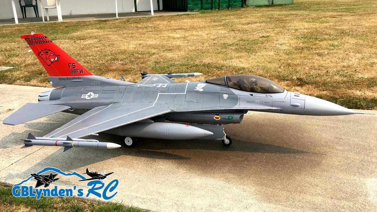

                    • My F-16 went out this morning for a couple of flights and had a photo shoot with the A-4.............:)
                      • Nice Shots!
                        • This jet is very impressive! I have seen my buddy's fly many times and this video is one of those flights.
